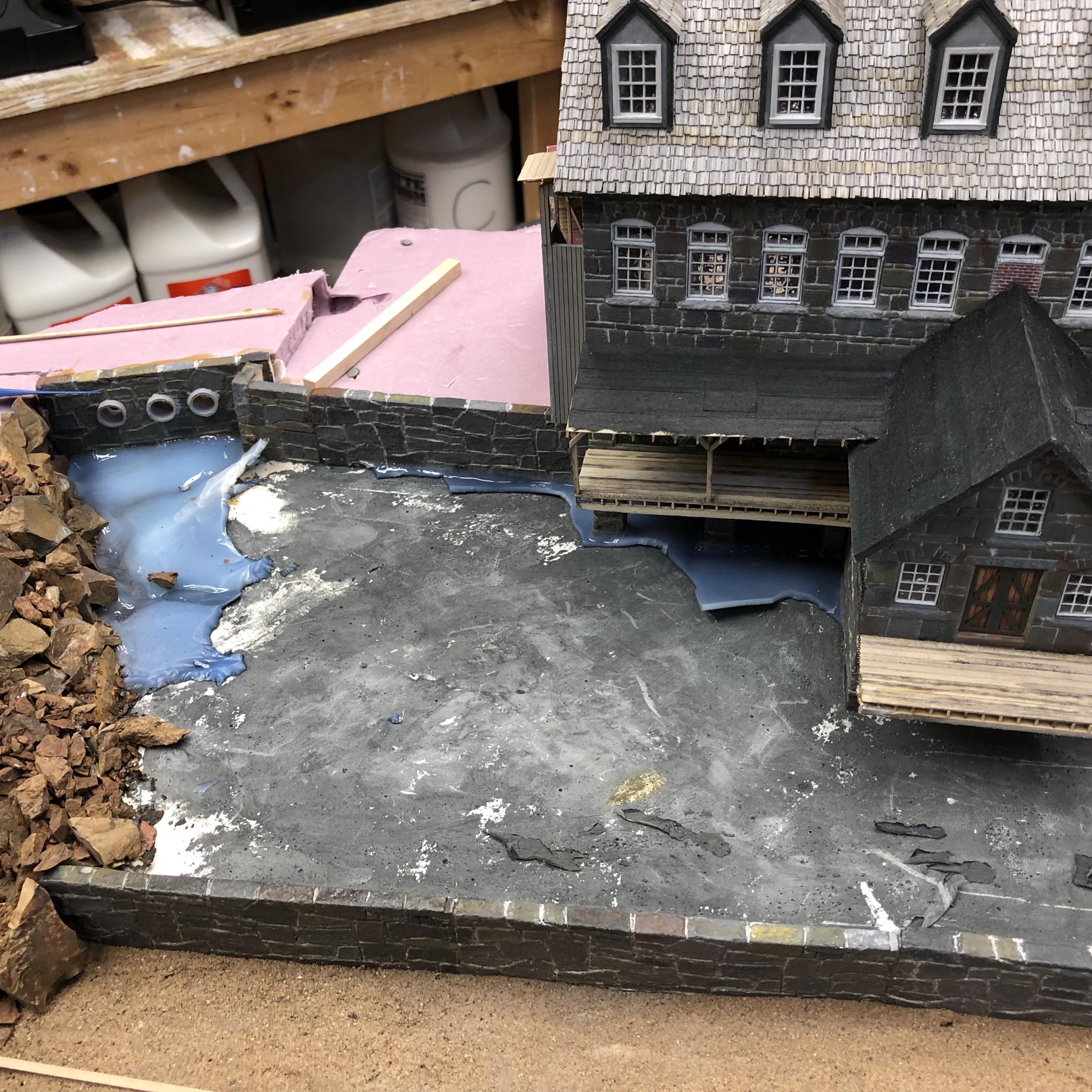

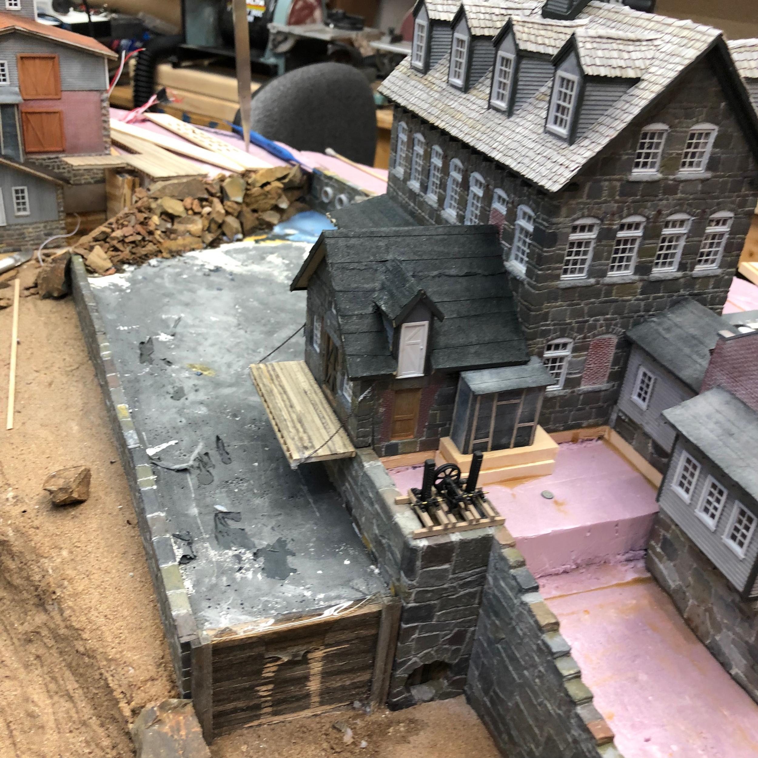

Thank you for your comments and input. I spent some time on artist u-tube channels this morning thanks to a link that Tom Boyd sent me. The way the artists use this stuff is to start out with 1/16 and then towel it out until it's real thin.  One of the videos showed this beautiful painting were they put it on "too thick" and it looked like my pond only it had dried clear. You could see the troughs in the surface. Based on the videos I think it would take a month safely get enough coats to get the thickness I need for this application. You have to take 24 hours minimum between coats for it to cure. So this morning I pealed it all off.  It wasn't to painful - just took some time and the right tools. I took a few pictures during the process to remind me not to do this again. ;)
Here are a few pictures of the tear out process.

Some cleanup work and a few repairs and I will be repainting the bottom of the pond.  While the paint is drying I'm going to watch Dave Frary's video on water. ;)  He uses Mod Podge so I think I will give that a try.  The coats will be relatively thin.  My experience is with using resin for water and I need to have a real good experience with Mod Podge to not go back to resins for my big water seems coming up.
One final comment on this subject.  I think part of the problem is this material needs someplace to go as it cures.  It does expand. On a painting there are no walls confining it. Take a look at my once very straight stone wall. It looks very prototypical now from all the freeze cycles. ;) The stone walls are resin and actually took a set from the stress.

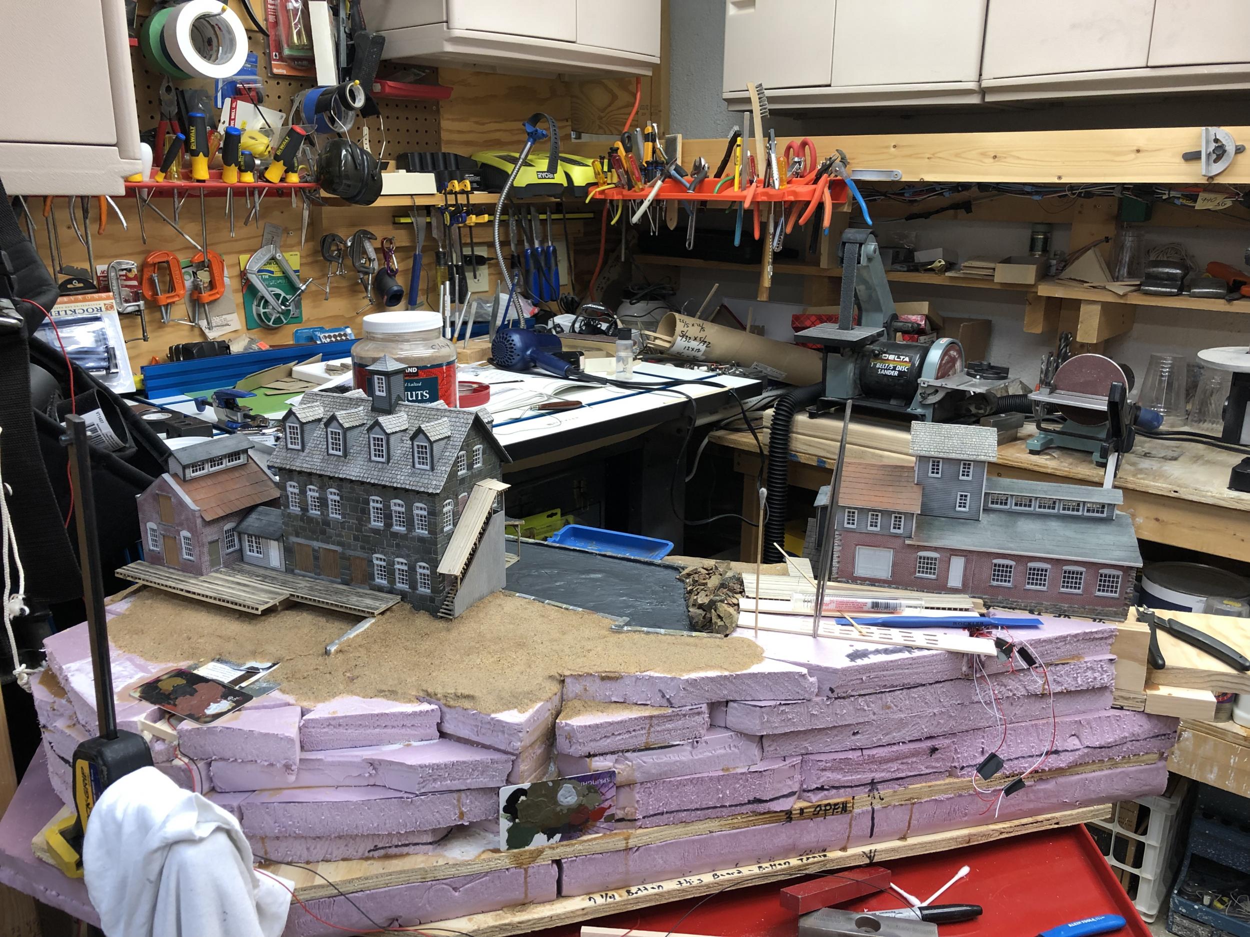

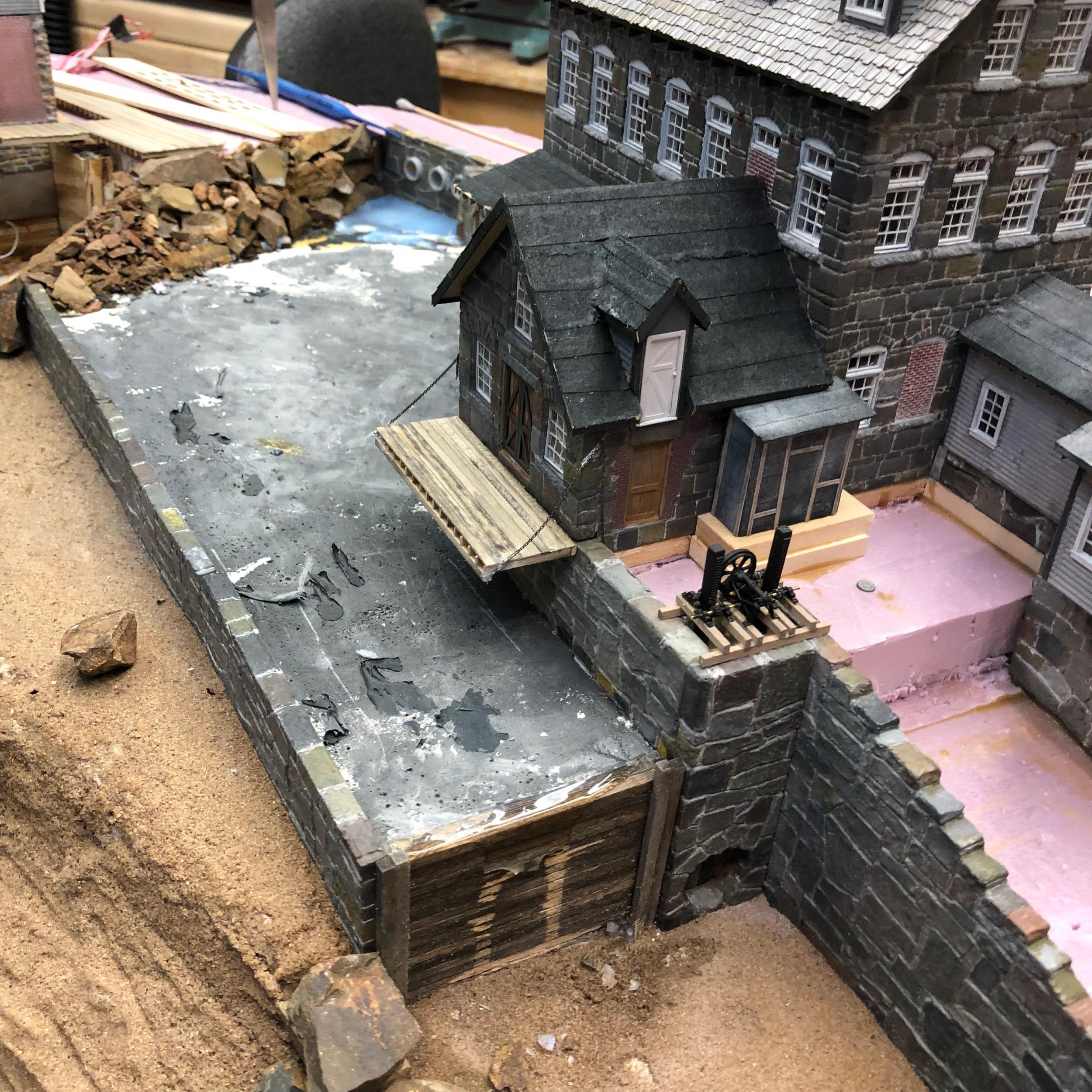

By the end fo the day we recovered from the water setback. I now have the model sitting on my moveable cart so I can get at the back of the diorama to work on it.  Today, I added more land forms, rocks and loading docks. As you can see from the pictures, the base coat of paint has been reapplied to the pond area.  I also made up a little foam board test piece, to test the new water material before I add it to the diorama.
