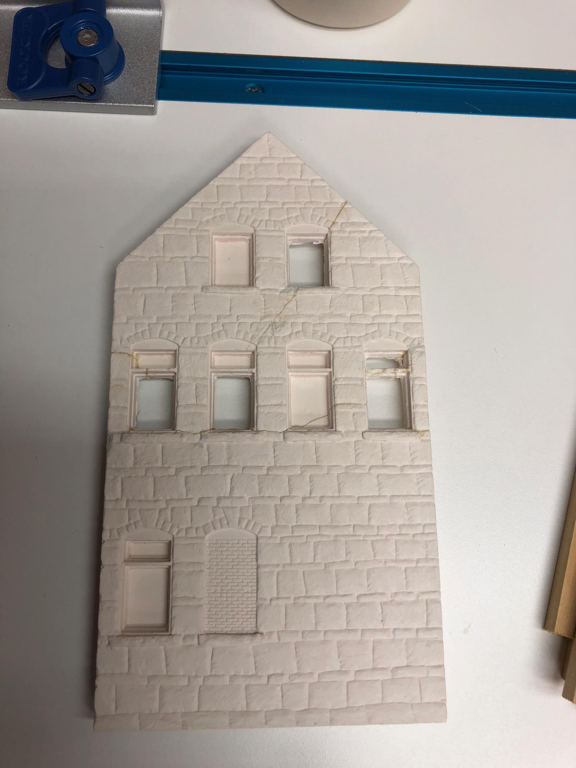

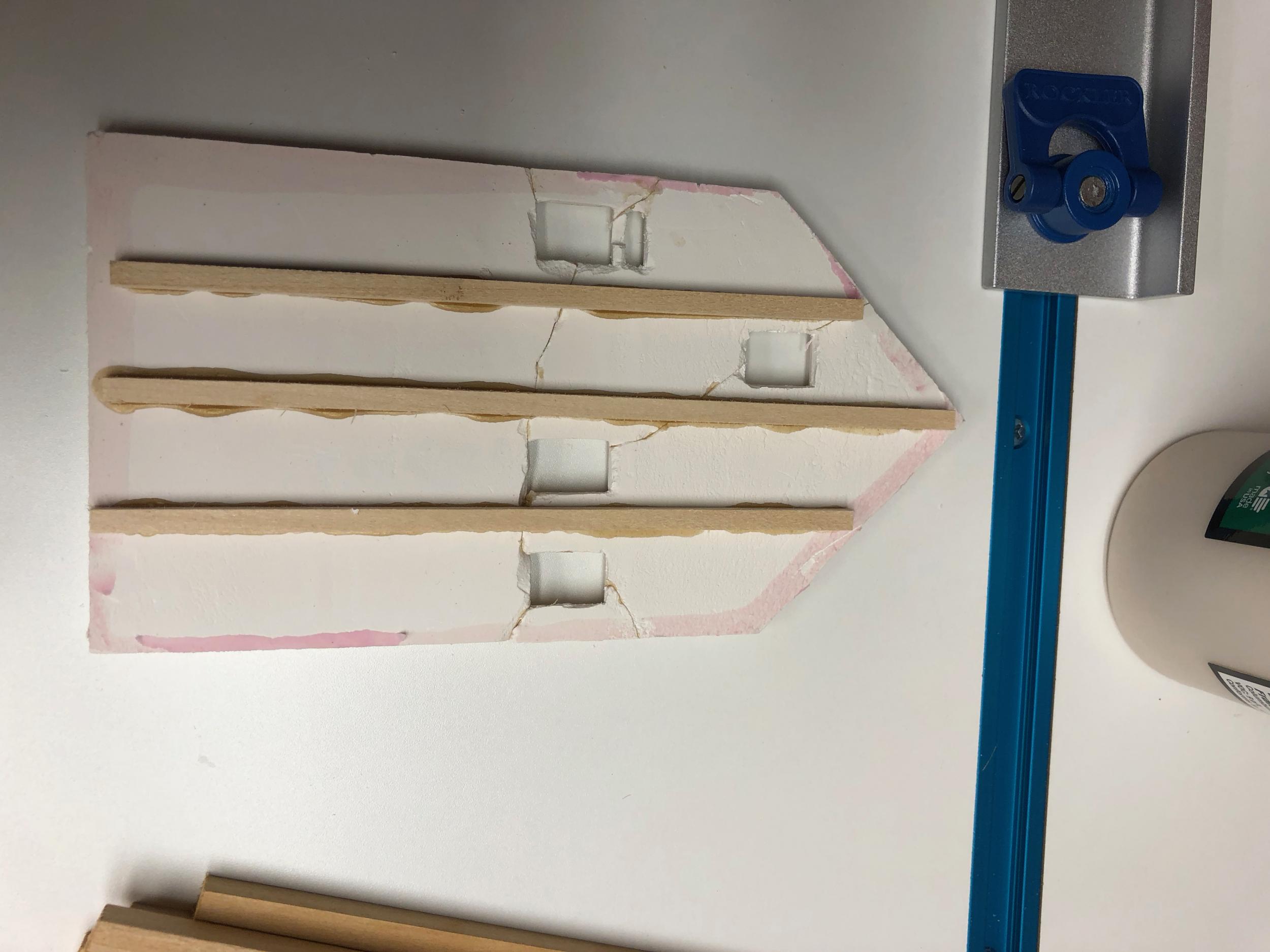

Thanks for posting these pictures here - great example of what I plan to do with the second set of castings. There is nothing wrong with hydrocal - especially just after you pour it. My issue is when it has sits around for years - more than 20 in the case of this kit - I believe it gets harder and more brittle.  To describe what I mean - when it breaks the break is not nice and clean - it shatters and little pieces fly everywhere.  Very hard to glue back together.  New hydrocal breaks nice in clean and repairs are very easy.  I will post a couple pictures of the casting that I started to repair.  Anyway I have decided to make molds of Bob's wonderful castings and build with resin castings. It will cost a few bucks but I think its worth it. I already have the money approved by the CFO of the S&S RR. The thought of dropping one of these castings is motivation enough.
As promised, here is a picture of the front of the casting that I broke and was in the middle of repairing when I decided to go with the resin castings. The window on the far right was a mess.  Lots of detail missing that would have been rebuilt with putty. The resign castings look just like they came from SRMW.
Here is a picture of the back - I had already started the reinforcing.

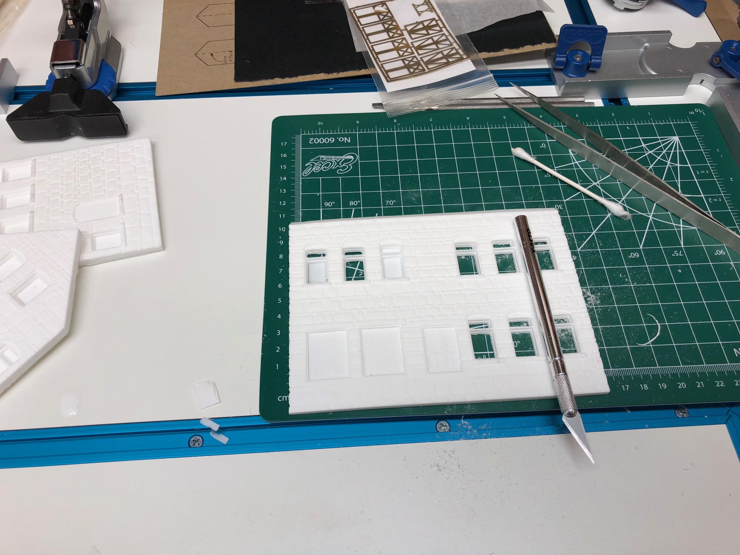

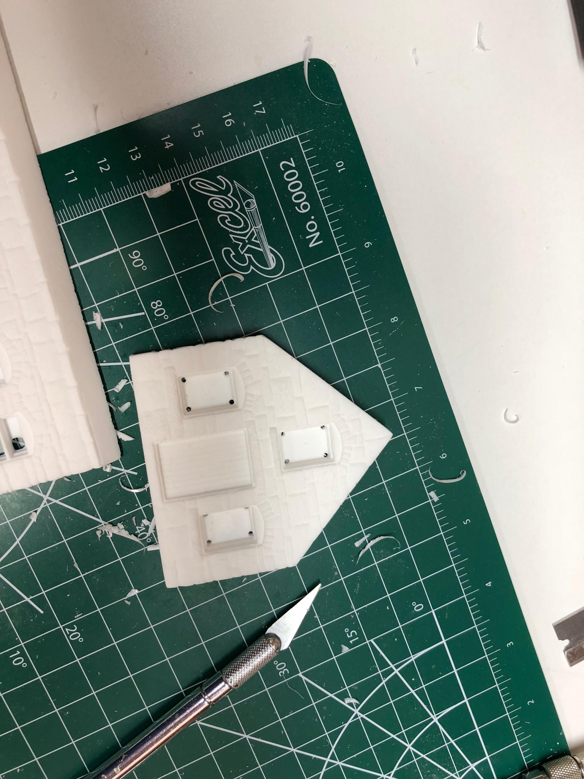

Casting preparation is underway.  I'm using a number 11 blade to clear out the windows, and a sanding block to clean up the edges and make sure the castings are square. This will take a few days. I'm about a third of the way done with the first batch of castings (main structure castings). I will be making the molds for the second batch of castings this week. The resupply  of casting materials arrived in yesterdays mail.
I use the window openings to judge when the mold is full.  If I over shoot the pour the window openings can have a thick flash, like in this casting, so I drill holes in the corners to keep me from over shooting the cuts with the exacto knife. This is more important with hydrocal castings because it's easier to get a running crack going - but I have split a resin casting by getting to aggressive with knife.
