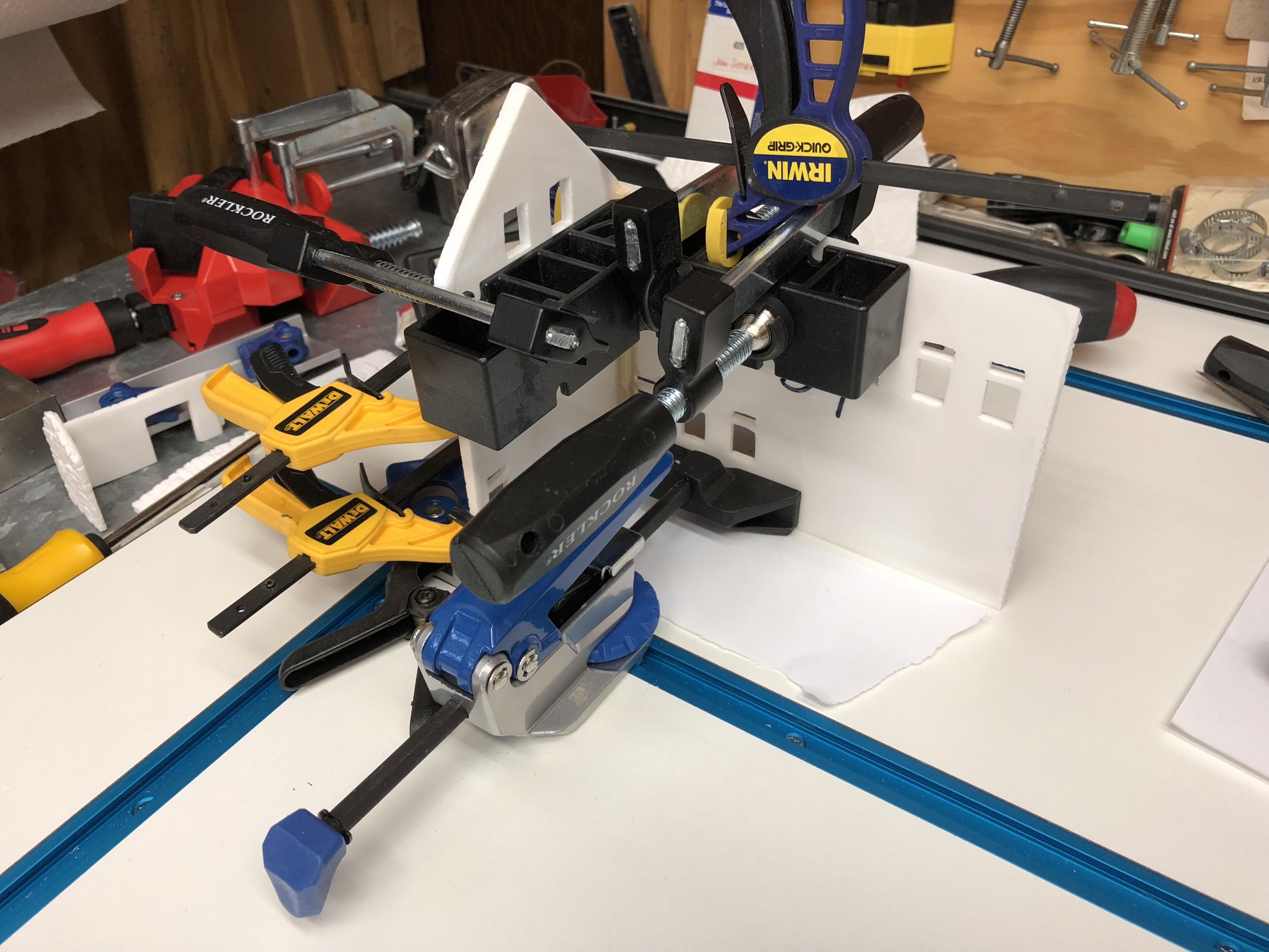

Today,  the walls started to go together on this build. Once I got the mortar lines lined up I wasn't about to let them move.  Do you think I used enough clamps?

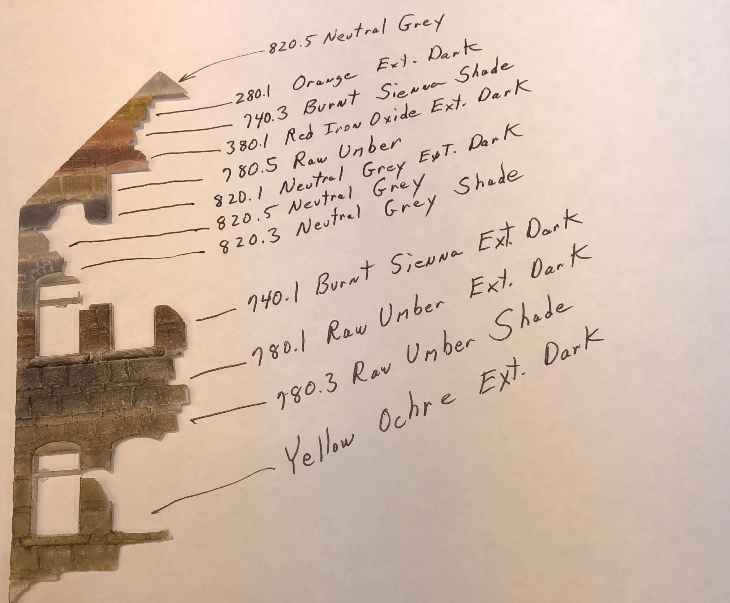

On one of my resin pours I had some left over so I made a partial casting and used it to make a Pan Pastel Color chart for my workbench. I'm still playing with the colors I want to use for the castings.
