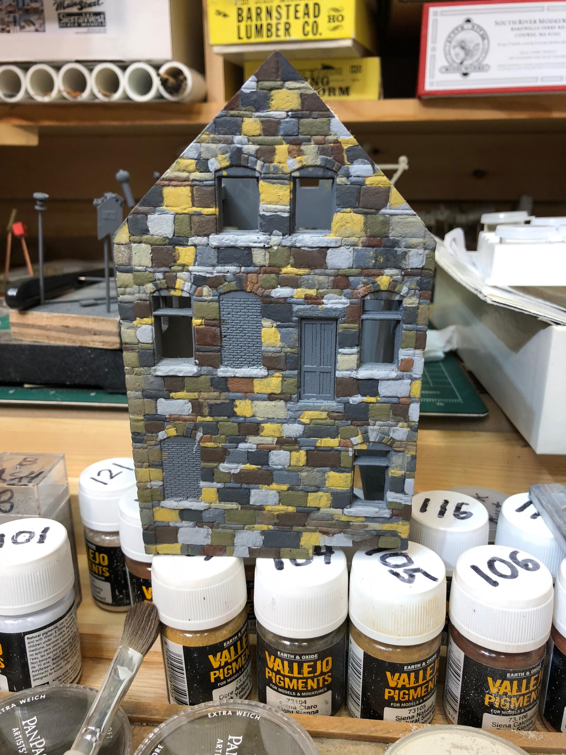

Here is the wall after I add the colors to the individual stones.  I know it looks bad.
I then paint the mortar lines with a small brush and neutral grey tint with lots of alcohol. Staying in the lines doesn't matter.

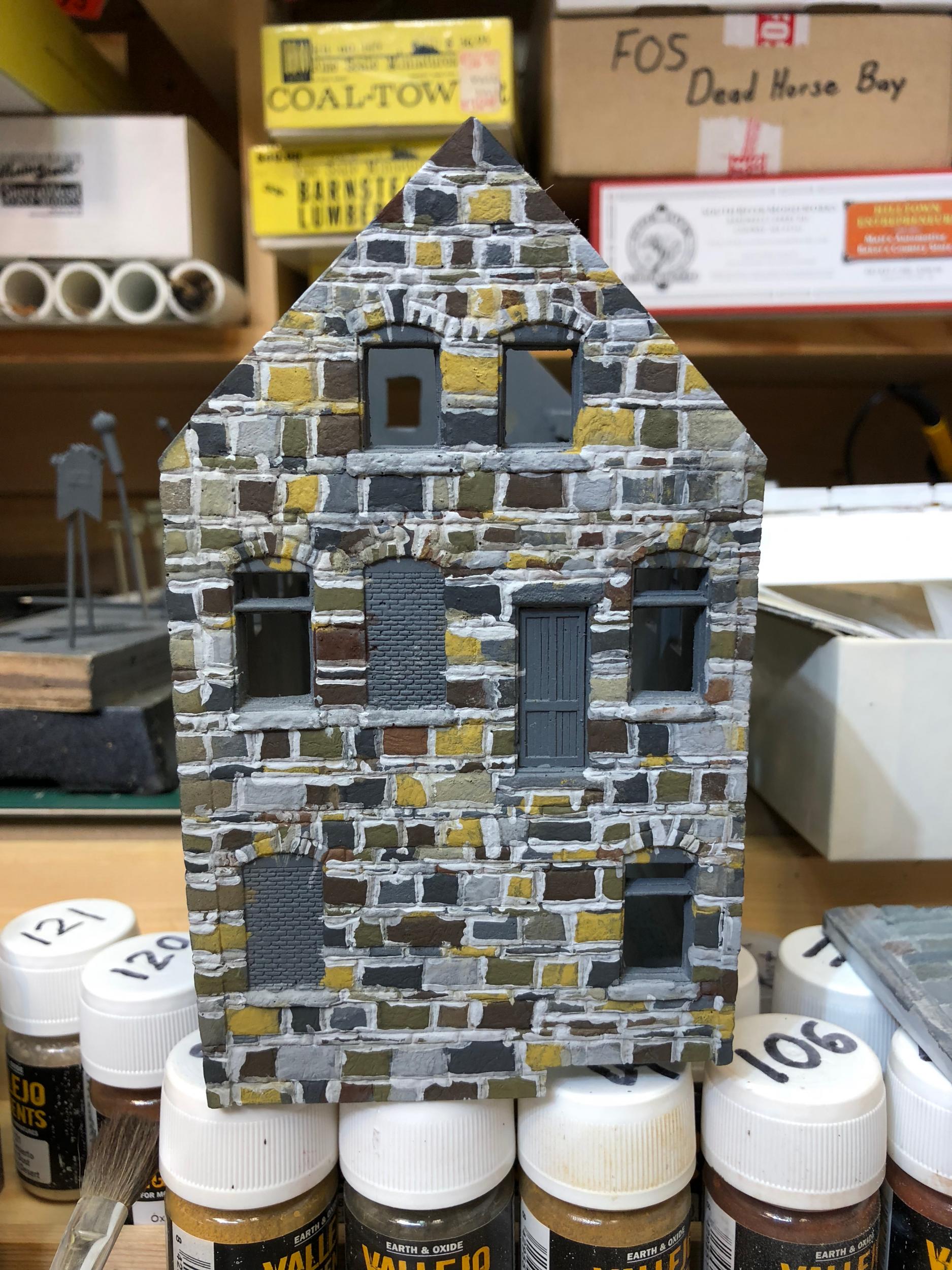

Once the mortar lines are dry - it only takes a few minutes I start the fixing process. I know at this point it looks pretty bad. What I want to do is dull down the colors, mix them together, and then fix the color so it doesn't rub off when I handle the walls. As for the mortar lines - stone Masons was the mortar off  the face of the stones with water.
We will do it with a nice fluffy brush. As we are doing this, we will add some raw umber tint to help dull down the colors. Our brush will also take some of the color from the neighboring stones and deposit it on the face of each individual stone - blending the colors. Here are a few pictures showing the process.

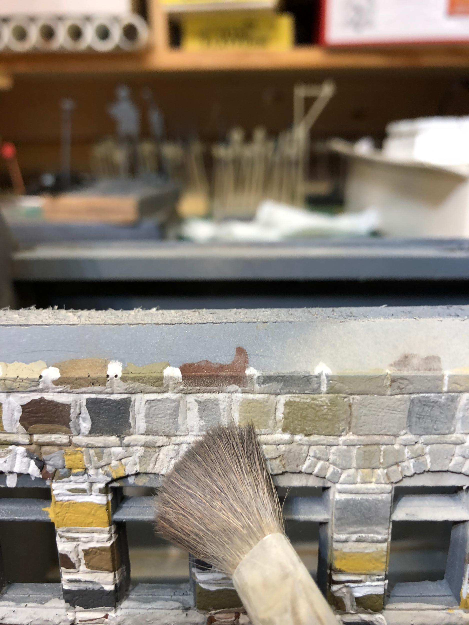

Here is a picture of the brush I use and the mortar coming off the faces of the stones.
Here is the blending process with the raw umber tint added to the brush. At this point I'm just blending the colors and giving the wall a dulled down appearance.  Once I have the walls completed and installed I will cover over everything with another blending process to make all the stonework look the same.

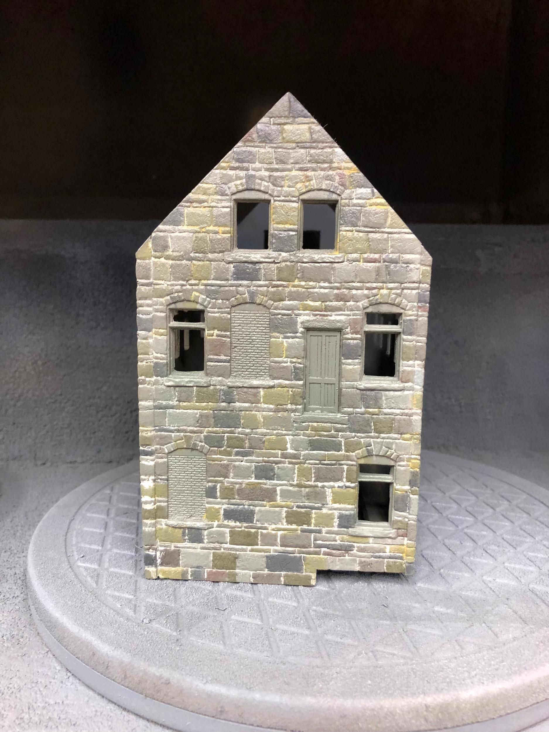

Here is a picture of a wall just before it goes into the paint booth for the fixative.

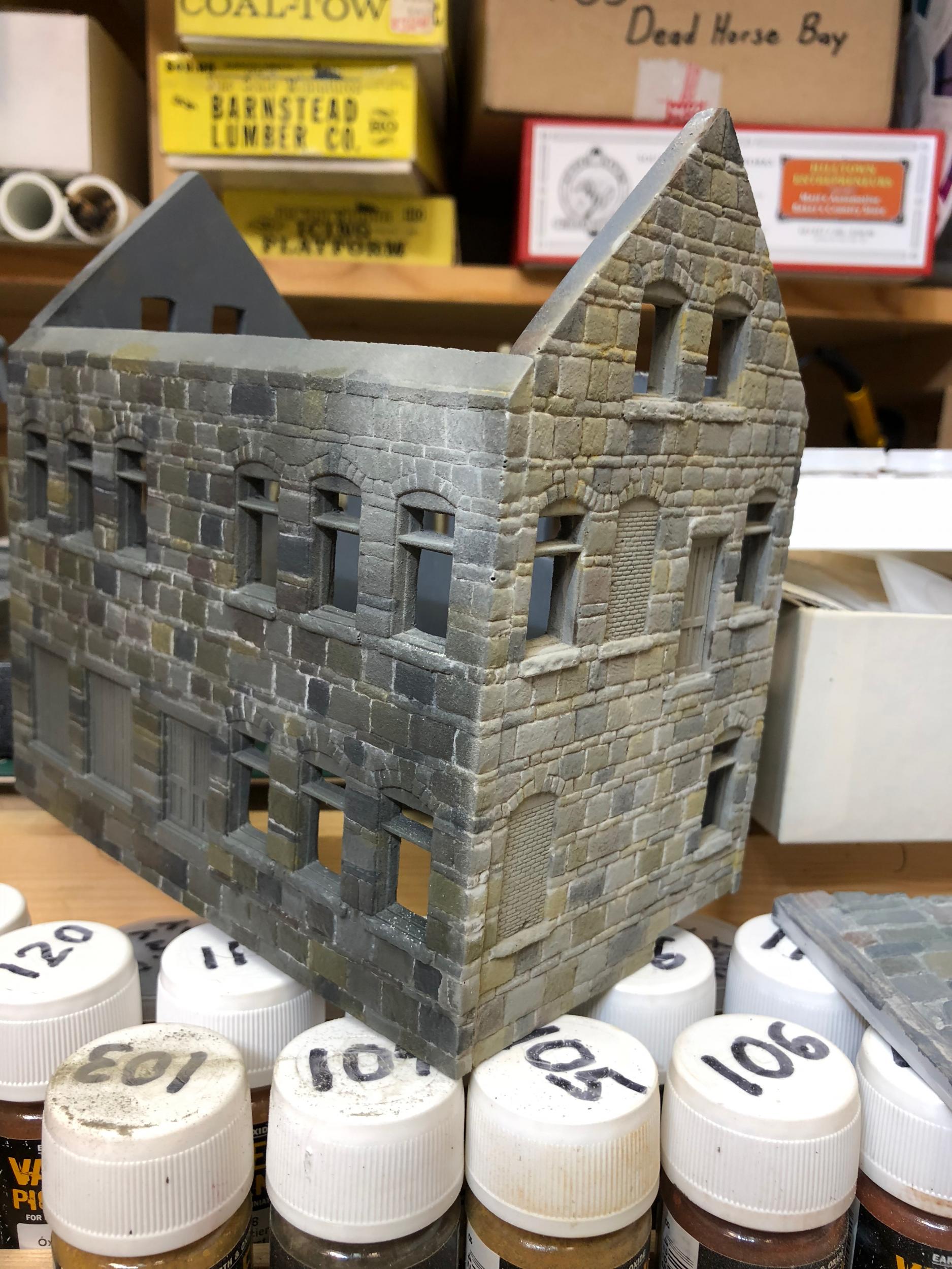

A couple pictures of the walls after the fixative dries.
As you can see, we loose some of the blending with the application of the fixative. Once everything is assembled in place I will apply the blending colors with the big fluffy brush again.  First, the raw umber tint and then the chrome oxide green to make the rocks look they have some mold on them.
