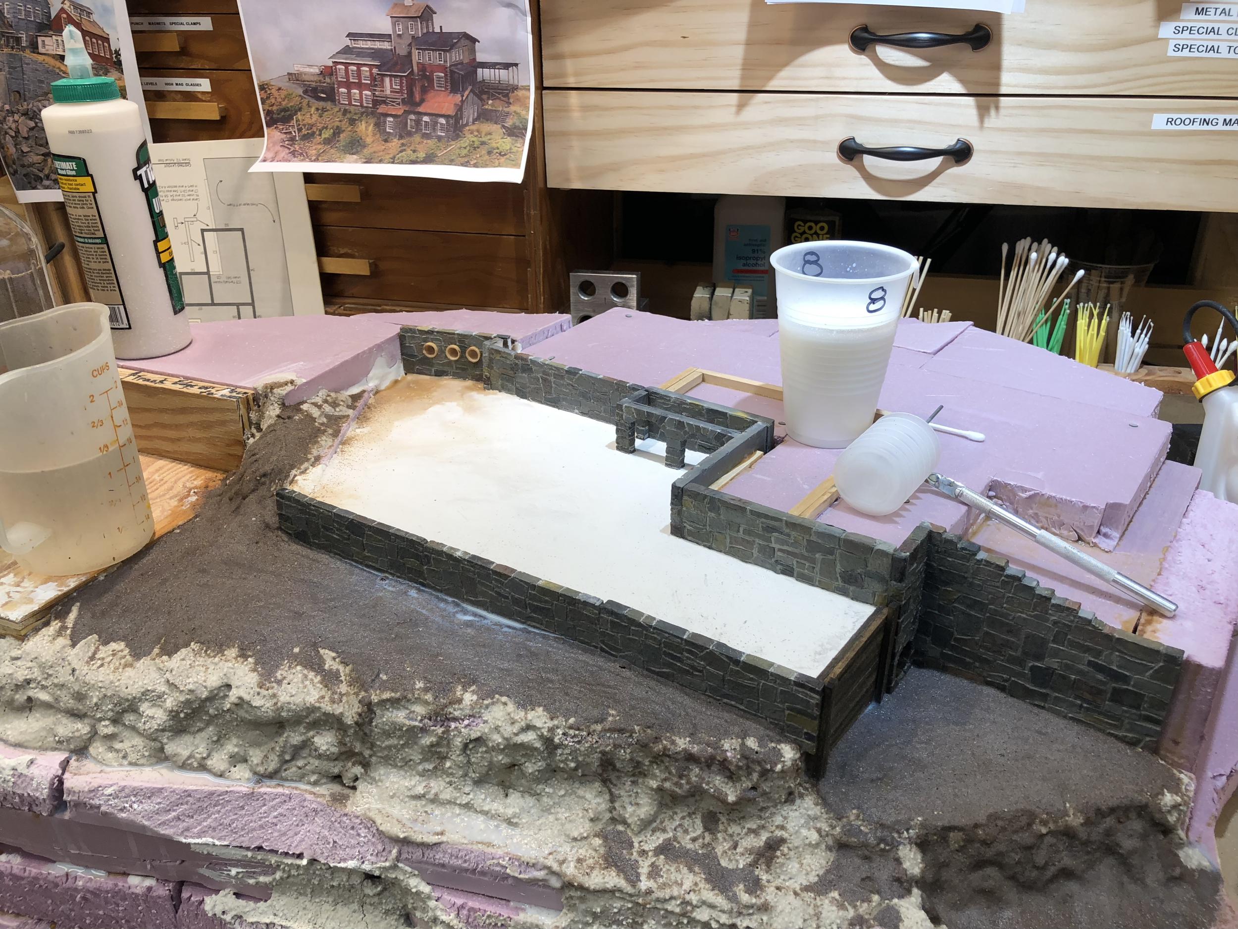

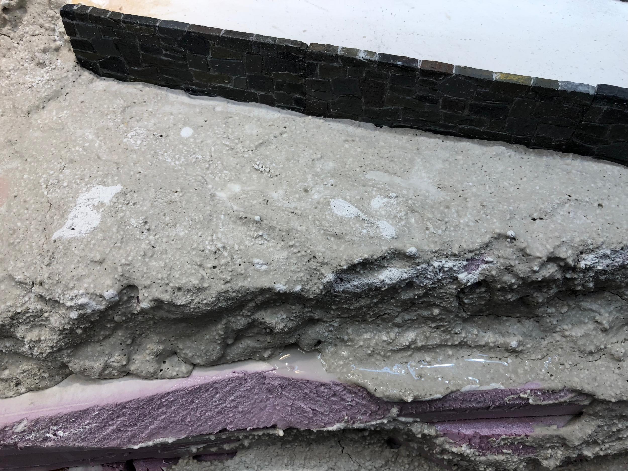

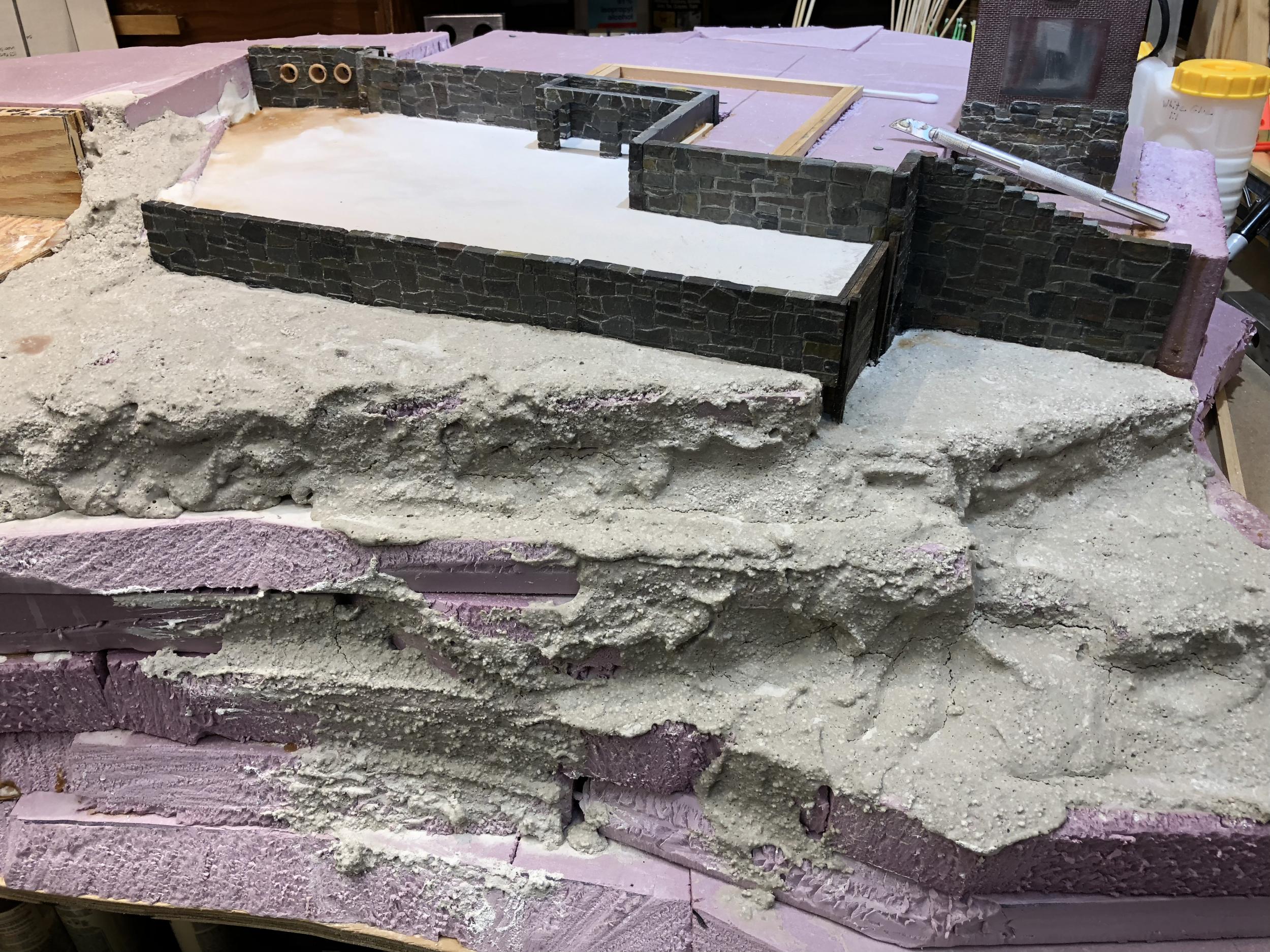

Finally, I decided I'd had enough when there were only a few areas that hadn't hardened.

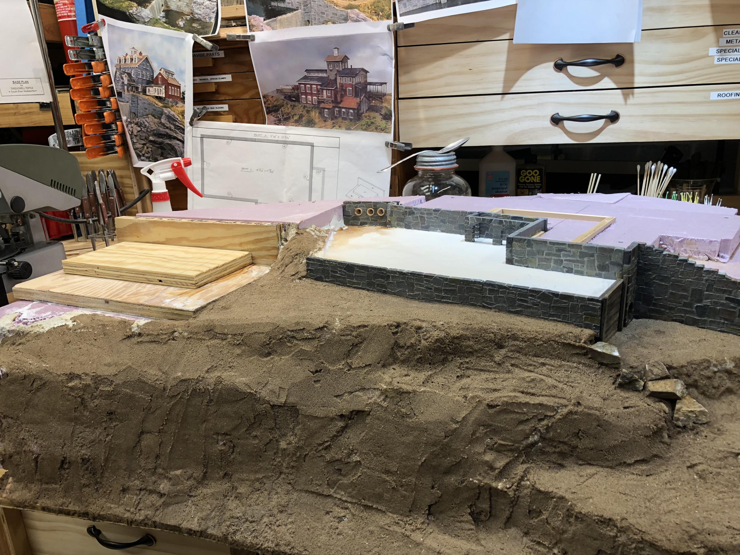

I fired up the shop vacuum and dug out these remaining soft spots. I then got out the beach sand and white glue and started to cover the foam and GypsolLite with a sand and white glue mixture. My old standard technique.

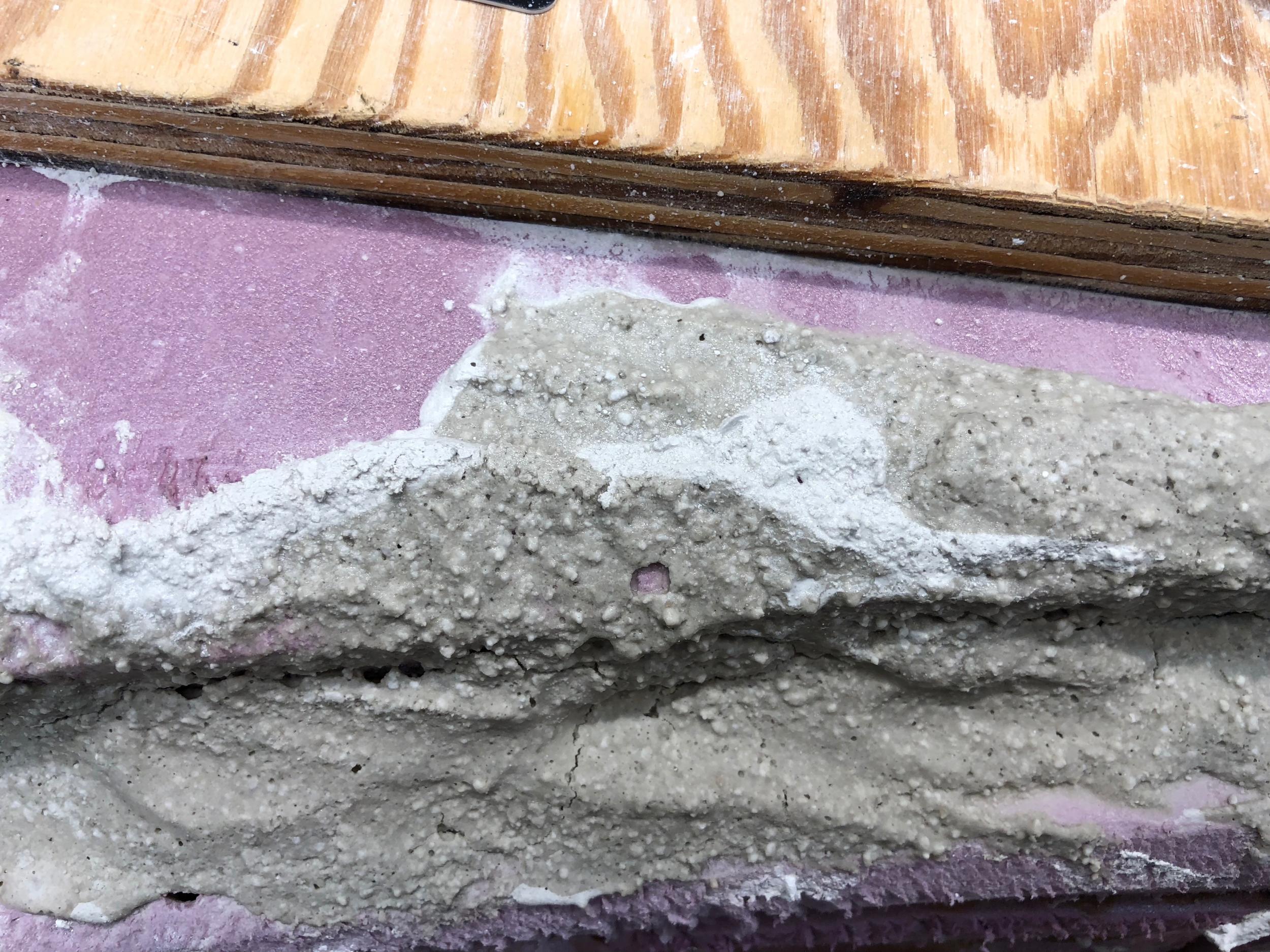

Here is were I left off for the evening. The first layer of sand has been laid down dry. I then wet it down with wet water (a drop or two of dish soap in the water). I then saturate the sand with a 4:1 mixture of white glue. Tomorrow I will add the next layer.

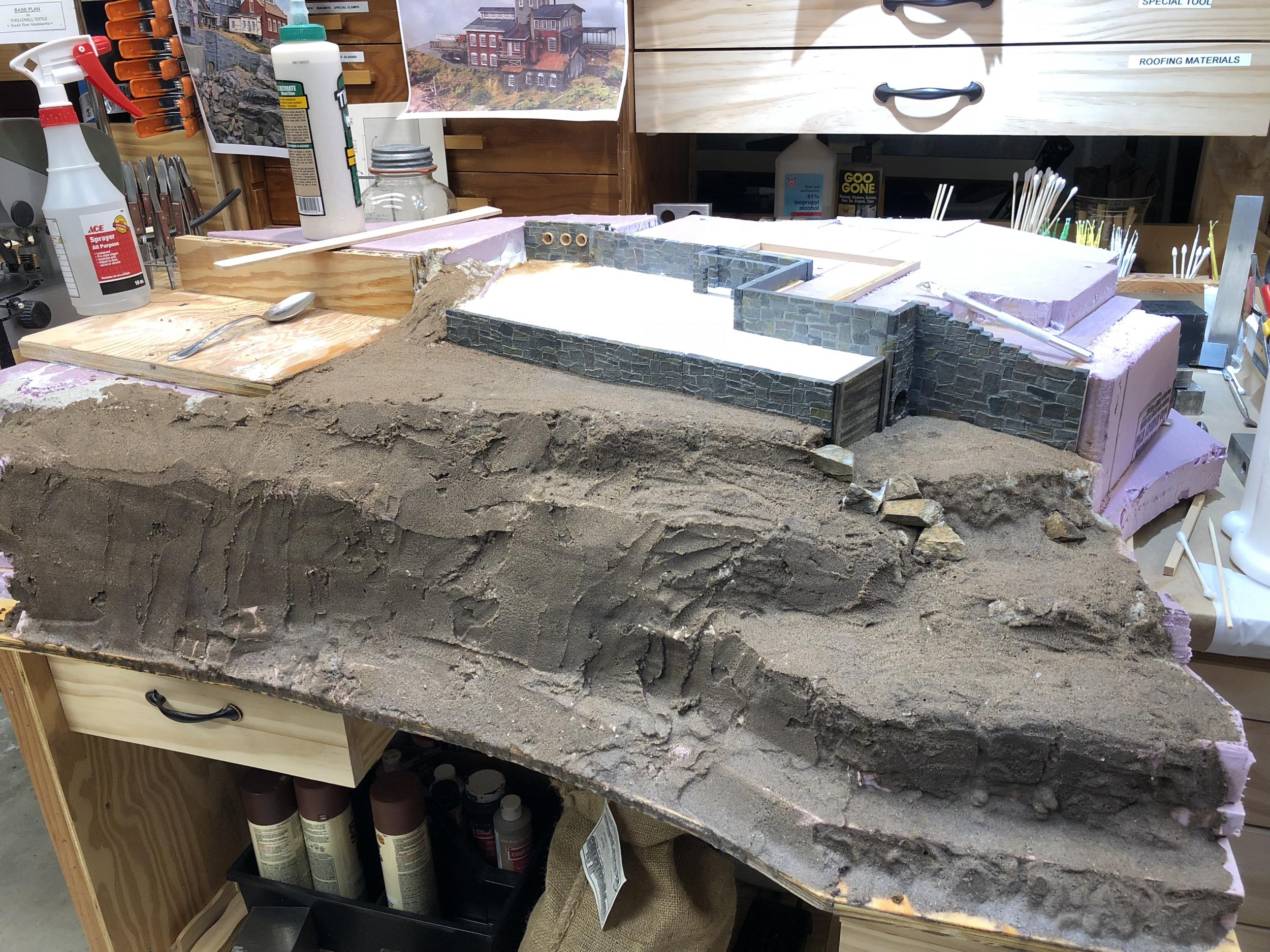

This morning, the glue and sand has hardened and is ready for additional material. Moving forward.

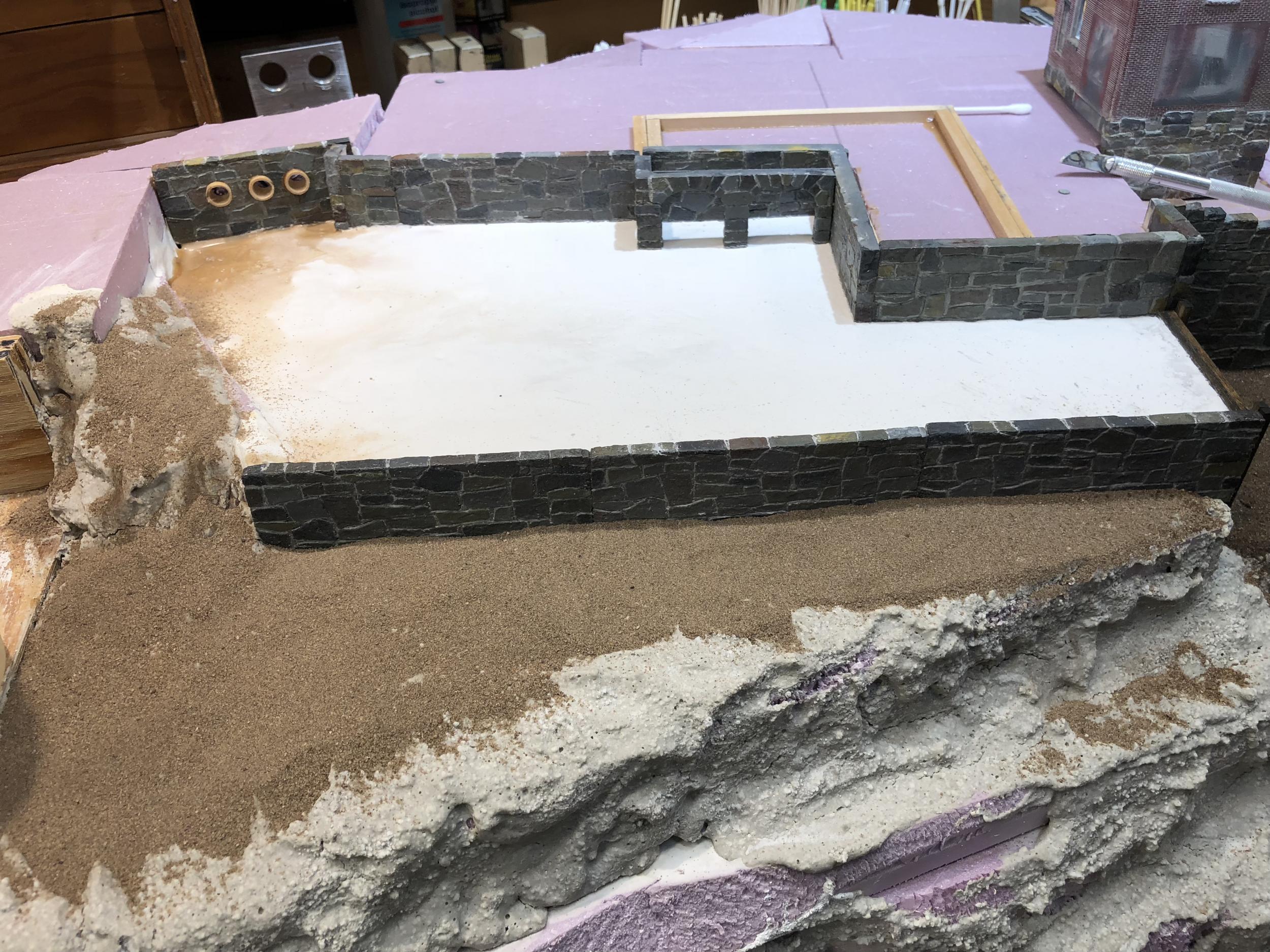

I finished the first coat of mud (sand and white glue) on the front of the baseboard. Now, to finish installing all the window castings.

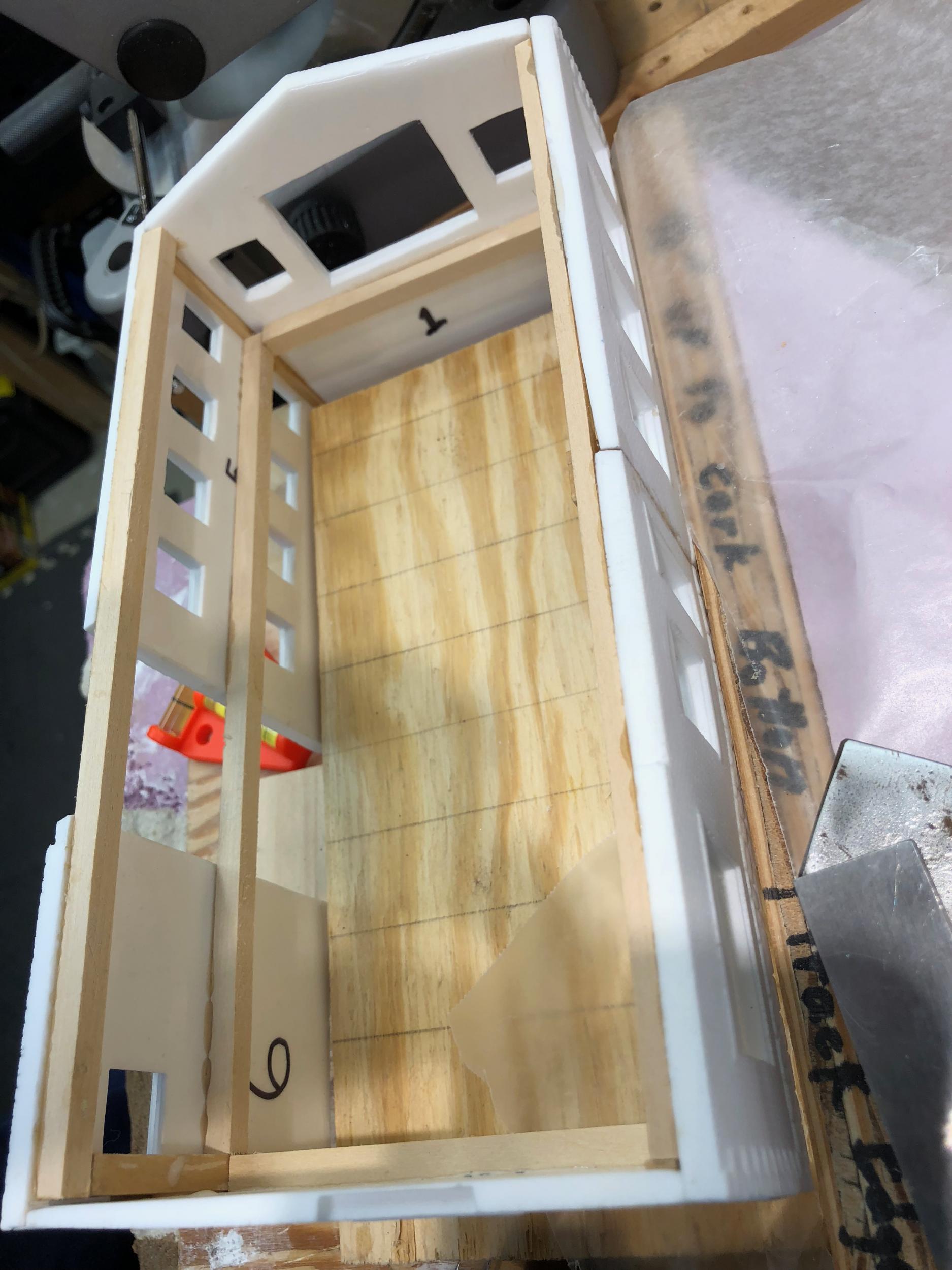

Today, I spent part of the day installing windows and detail painting the subassemblies for this build. I also started the build process for the Delabarre Tool & Die.  First, I finished the wood base for the build.
I also started dry fitting the castings.
Finally, for today the castings for Delabarre's started to go together.

Today, more castings were assembled. The following sequence of pictures shows the assembly process. I added a layer of wax paper between the baseboard and the castings for the gluing process. Once everything is together I will be removing the assembly from the baseboard and painting it on my detailing workbench. Yes, I believe in using lots of bracing. Bob recommends 1/8 inch braces - I used 1/4 inch where I could make them fit.
