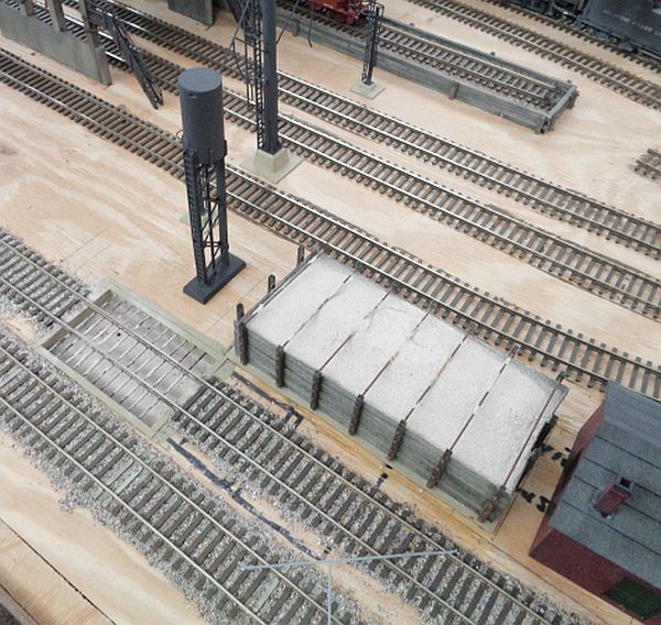

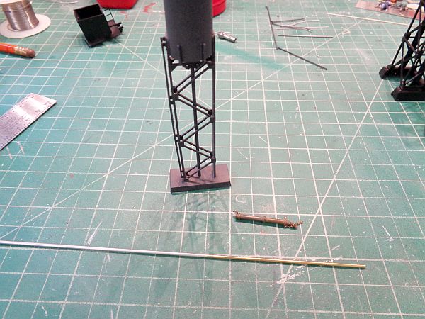

I had one other sub assembly to kit bash for the sanding tower and supporting structures.
I needed a way for the sand to get from the sand pit and into the sand bin. I used another sand tower from another kit and added a few extra pieces to it to get what I wanted.
Below is a photo of a small Walthers sand tower. I left off all the piping for this one to kit bash it.

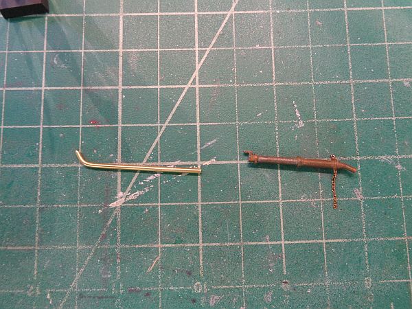

I used a short piece of spare brass rod and a sanding spout from an old FSM Coaling Tower kit.

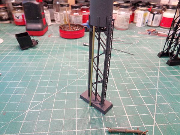

I drilled a hole in the bottom back side of the sand tower and cut the brass rod to fit as shown below.
I then cut a short piece of the brass rod to be glued to the back of the sand spout. It was bent to fit the angle for the pipe to be aligned over the sand bin.
I also drilled a hole in the front bottom of the sand tower. This hole was drilled opposite of the one in the rear.
The brass rod with the extended spout was then glued into the front hole.
By doing this, the tower became top heavy and wouldn't stay upright. More on this in the next few photos.

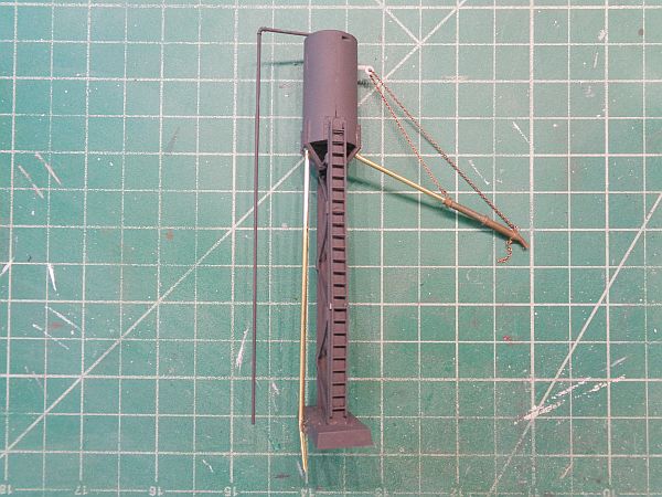

In the mean time, I added a small eyelet from another kit. I drilled a hole in the top front and glued this in place. You can see this piece in the above photo.
I then added some HO scale chain to the pipe as seen below.
I also removed the rear brass rod and added a longer one as also seen in the photo above.

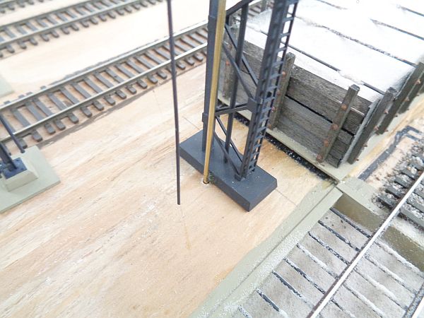

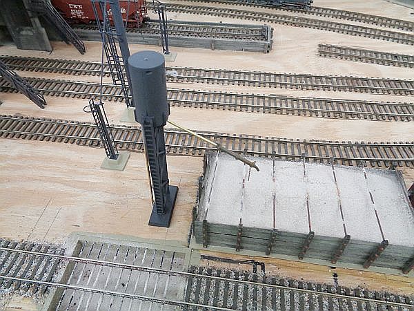

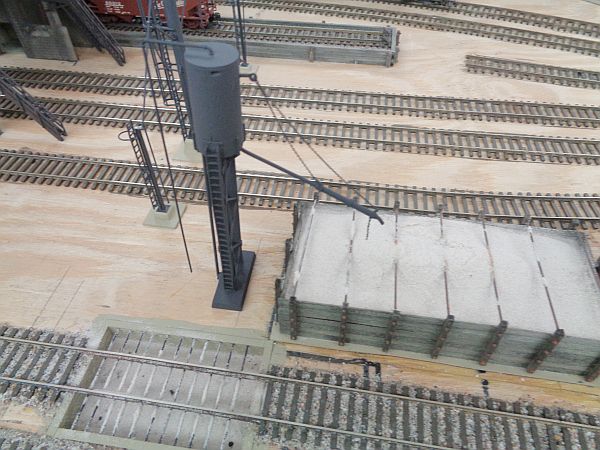

I drilled a hole in the layout plywood and used this hole to insert the extension of the newly installed brass rod. This holds the sand tower upright and in place.
I then resprayed the structure with Floquil Weathered Black.
I'll possibility have more to update tomorrow. I appreciate all following along.
