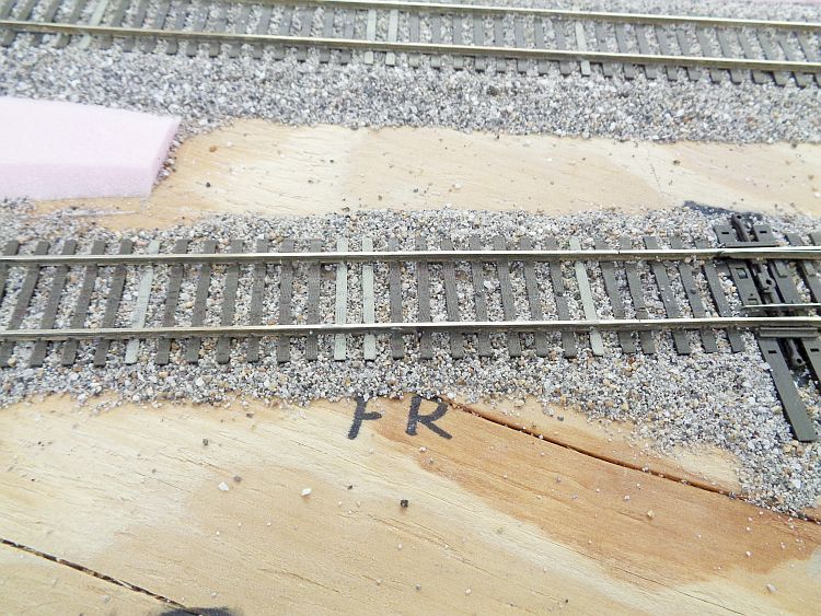

On the outside track I used Arizona Rock ballast. I used it here, on the island area, but experienced an issue with the ballast "floating" after the matte medium/glue was applied.
I didn't experience this at all with the rest of the layout. Here is what I'm referring to. You can see the ballast has floated and dried on the ties and up against the rails.
Not to bad in the next two photos.
Much worse in these photos.
This isn't a big deal but one that took some extra time and effort to correct.
This may be very common and basic in ballasting track but it's the first time I've experienced the issue.
