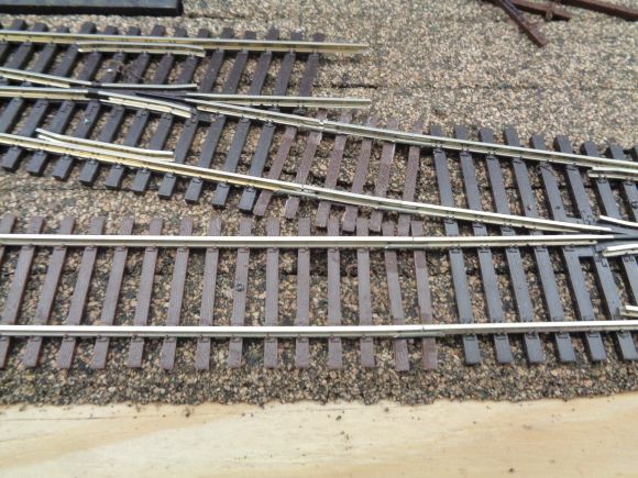

I was working on the north end of the yard when I came upon an issue with the last turnout. The turnout on the bottom has a dual purpose. It leads to a runaround track on the isle side and the top section leads to a soon to be built/installed icing platform.
The problem as shown in the below photo is that the two turnout rails don't align properly.

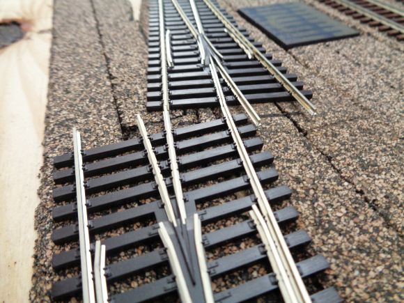

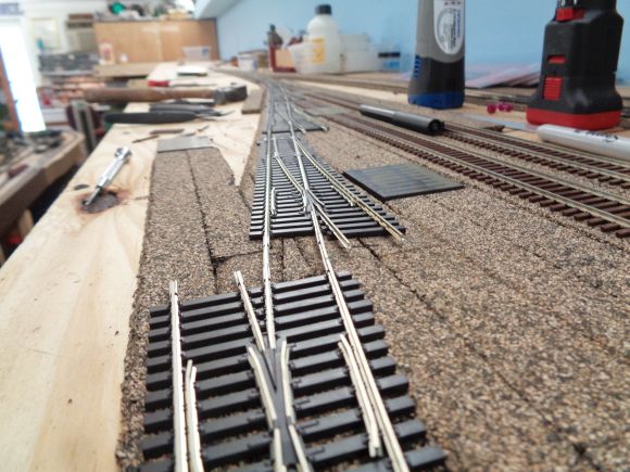

Here is how I solved the problem. I needed to move the bottom turnout back less than an inch and yet a straight section between the turnouts still wouldn't work. This 3/4" piece of track needed to have about a 60 degree curve for the turnouts to be properly aligned.

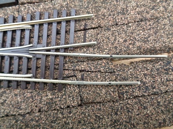

I took two three inch pieces of rail and gently bent them as shown. The bend was in the middle. When satisfied I had the correct radius, I cut off one end and soldered it to the turnout rails on the left.
The black marks on the rail is where the other turnout rails will go.
