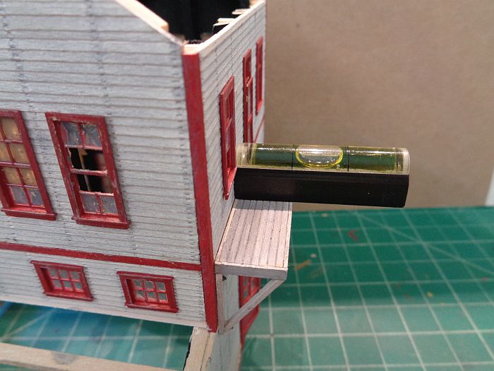

Time to build the second story porch/balcony. I wanted to do this so I had a better look at where the main signage would look the best.

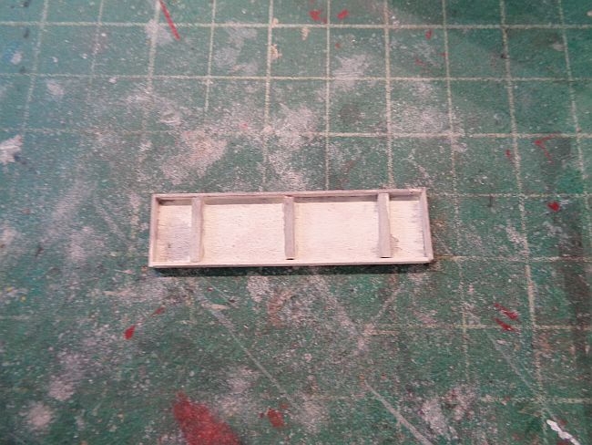

I made a small little deck using some scrap scribed siding and built a 2X6 frame around it as shown. It is 4.5 ft. wide and 15.5 feet long.
I supported the scribed siding by adding three short pieces of 4X4.
More in a few

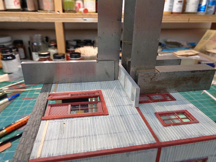

I glued it under the door frame and to the left just at the edge of the red trim.
I used metal squares to make sure it dried level and perpendicular to the wall.

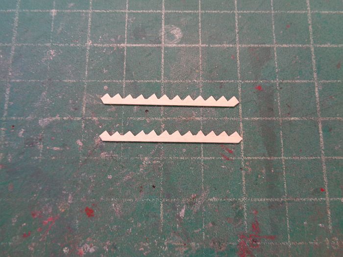

While that was drying, I started to make some staircase stringers out of HO scale 2X12s.
More on this in the next post.

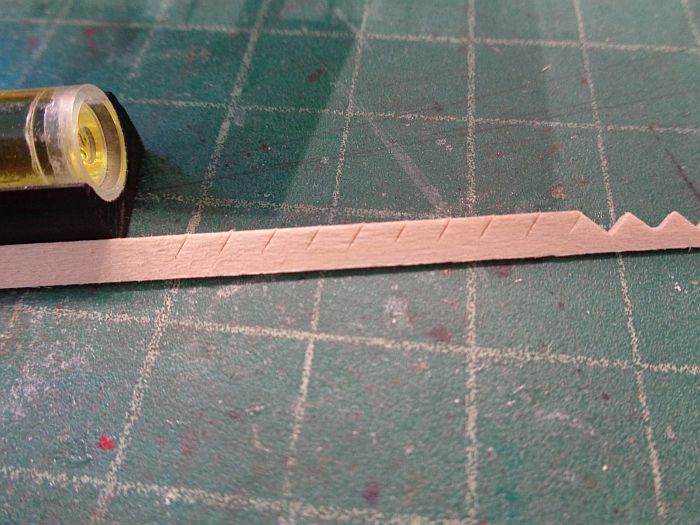

Several companies make laser cut stringers and steps but I didn't have any on hand so it was necessary for me to make my own.
A forum supporter, Rusty Stumps, makes them. Others do as well as I mentioned.
To make mine, I cut halfway into the 2X12 at a 45 degree angle.
I then cut from the tip of the inside cut to the edge of the next cut in line. All at supposedly a 45 degree angle.
Here are two I cut. I cut the bottom first and used it as a pattern to cut the second.

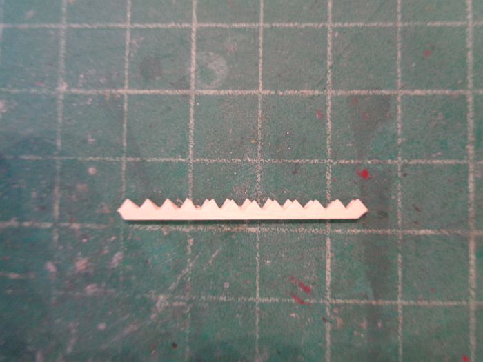

NOTE:  When gluing the two stringers to the model, make sure you glue them as they were cut.
In the next two photos you can see the two stringers I cut on top of each other. The second photos shows the two stringers with one flipped over. As you can clearly see, they don't and won't work this way.
Again, they need to be inside to inside to each other. I made a small pencil mark to indicate the inside of each stair stringer.

Okay, back to my 2nd. story deck. It is dry and level, thankfully.
I cut three 4X4 posts and glued them vertically to the front outside wall. These of course are attached in theory to the interior framing of the front wall prior to the siding being nailed on.
I then cut three 4X4s to use as diagonal support posts for the decking.
I drilled #78 holes and added N&Bs to the vertical and diagonal 4X4 posts.
The three N&Bs on the bottom of the vertical posts aren't glued and were removed so the diagonal brace supports could be added.
Did I mention level is a very good thing when building second story decking?
