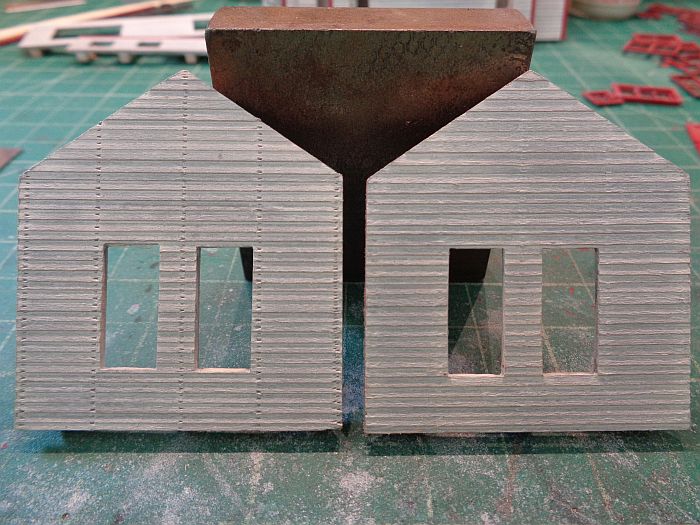

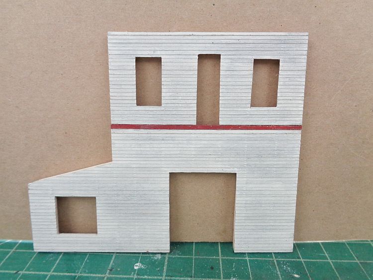

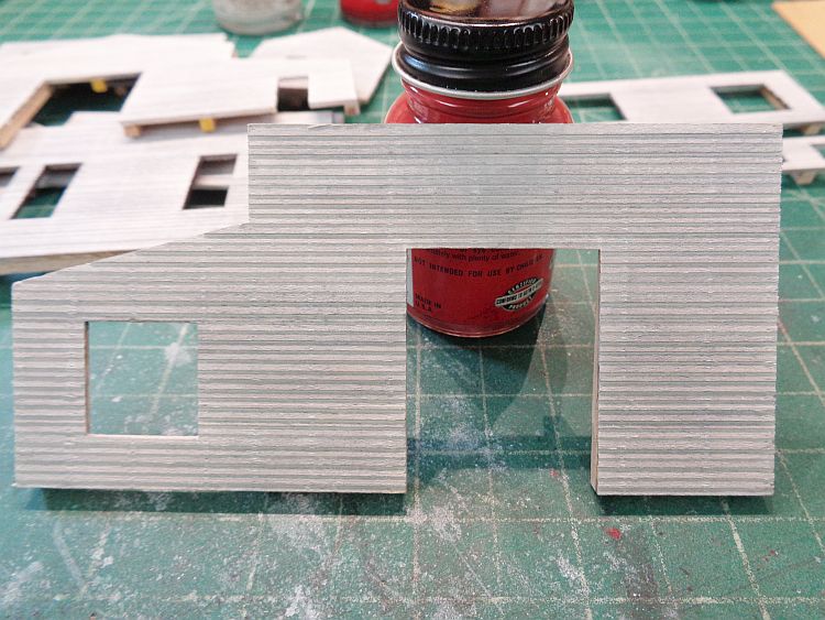

I knew my main color was going to be white so I went with Floquil Reefer White. However, I thinned the reefer white down quite a bit.
I  went with my white wash of 60% thinner to 40% reefer white.
I chose Polly Scale DTI Cherry Red for the trim, doors and windows.
Two coats of the white wash were applied to the walls. I allowed the first coat to dry but not cure. In other words, I applied the second coat of white wash about 10 hours after the first coat. It will take a couple of days for the white wash to cure thoroughly.
First coat of white wash -
Second coat of white wash -

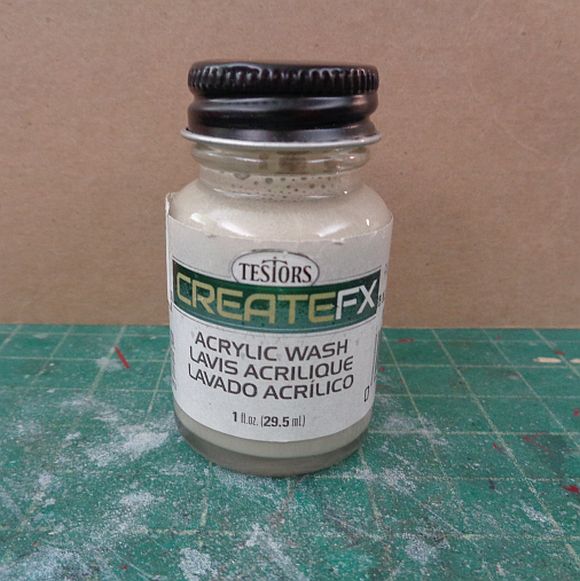

After the they were dry, I dry brushed them with Testors Driftwood Wash. If you don't have any of Testors Driftwood, GET SOME.
It is a great product to have for washes and color. I got mine at Hobby Lobby for $6.49, 1fl. oz. I didn't have any discount coupons and it was the only bottle left. My Babe got me another bottle for $3.50 with a store coupon.

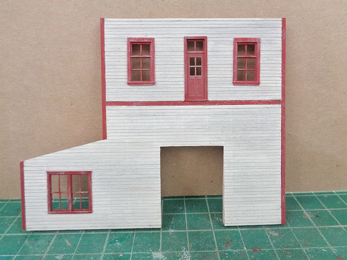

Here are the doors and windows painted in the red color with the driftwood dry brushing.
Here is a shot of the door and windows in place on two wall sections. They aren't glue in at this point. Window glass needs to go in next.
All walls set and left to dry/cure.

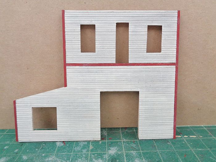

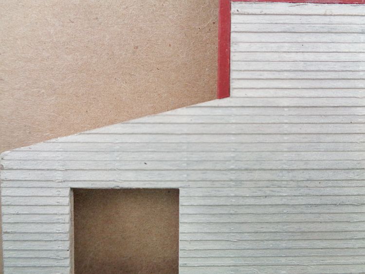

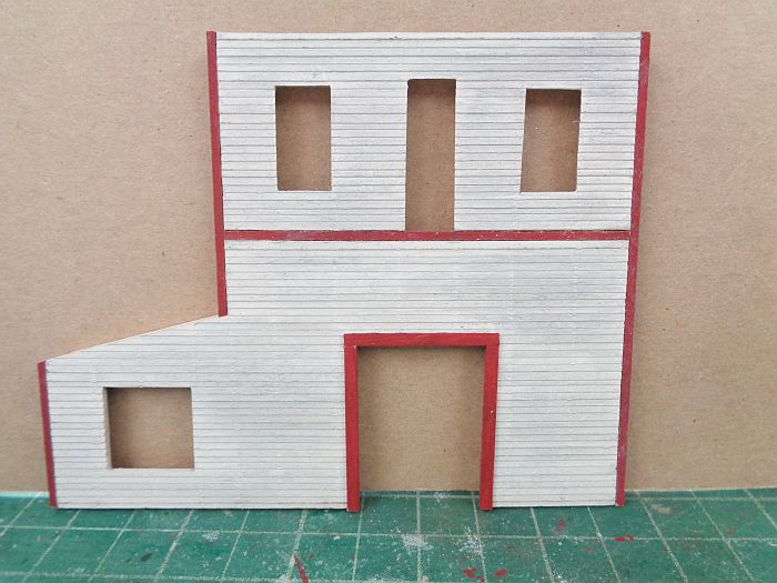

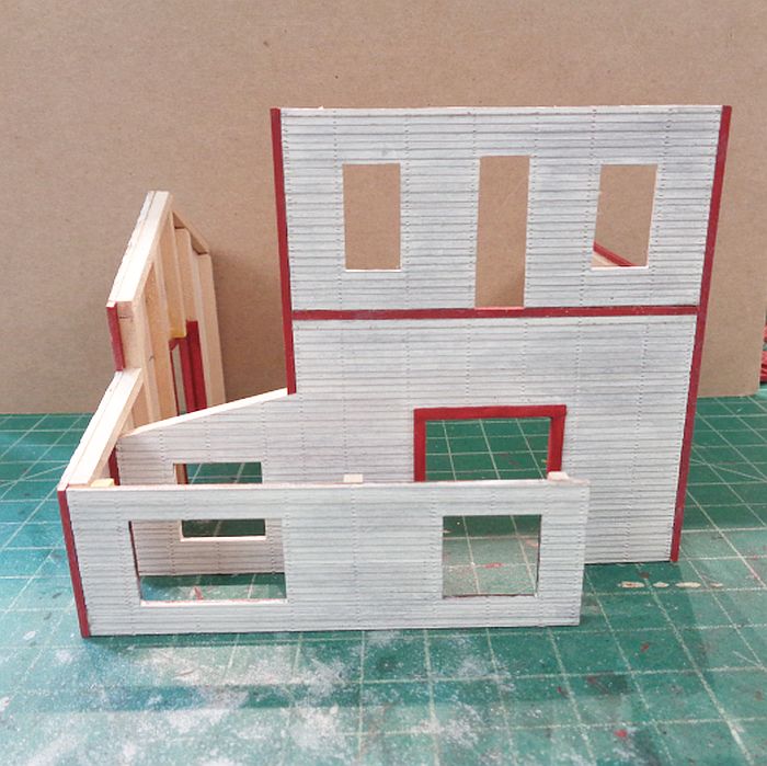

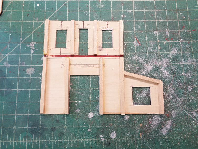

Prior to gluing the front second story wall onto the bottom, I added the 4X4 horizontal board to the top of the bottom wall.
When dry, I glued the second story wall onto the top of the red 4X4. I then used weights to hold it in place until the walls dried.
After a few hours, I removed the weights.
I forgot to take a picture of this but I added more vertical bracing between the two floors for more stability.
I then added the vertical corner trim to the three edges of the front wall section.
Be sure to make a clean cut for a nice clean fit for the corner trim as shown.

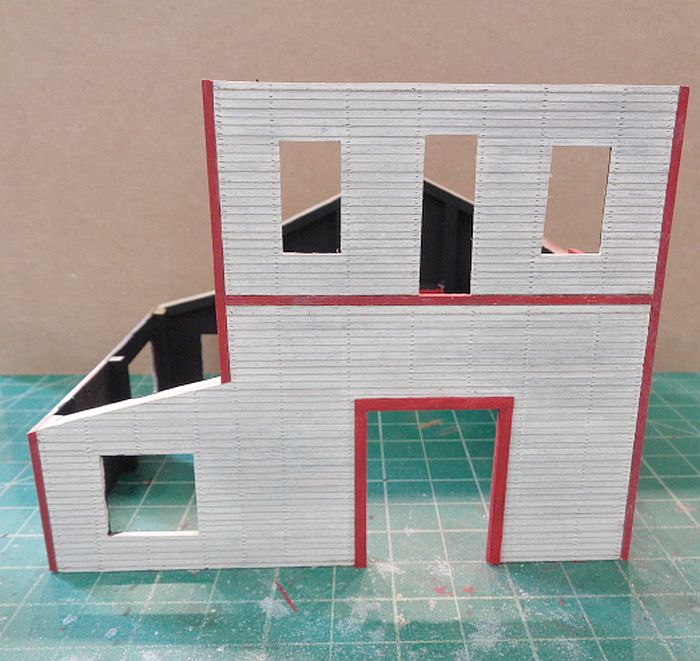

In the next photo, you can see the vertical trim posts glued to the wall edges. One long piece is the correct way to add trim to these wall edges. Nice tight trim makes for a better looking model.

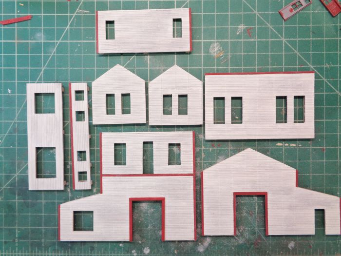

Here the door and windows are test fit. I needed to file a few openings as the thinned paint made the wood swell.
All fits now.
I added trim around the bay door as well.
Diet Pepsi time, back in a few.

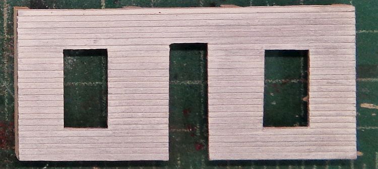

While some of the red trim was drying, I reopened the nail holes. After three applications of the thinned white wash, the nail holes all but closed.
Fast forward a few hours and all the trim has been glued to the walls.

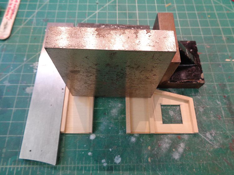

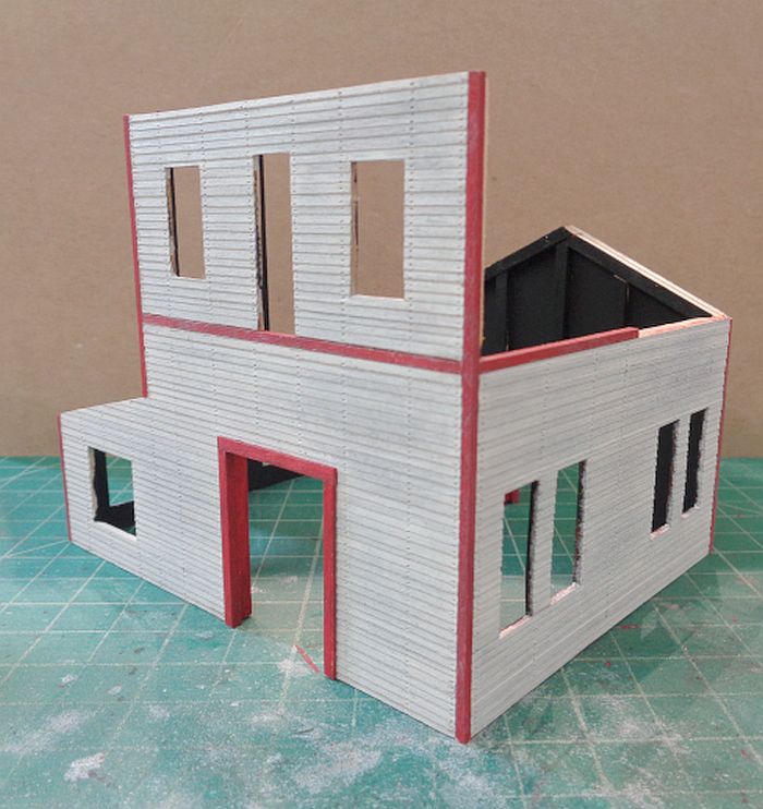

So, time to glue the walls together.

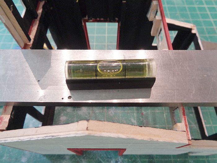

Two corners were glued together. Not shown is the fact the walls were weighted and checked with a metal square to ensure the walls were in fact square.
I don't plan on adding interior details or lighting the inside but I painted the interior walls flat black anyway. I used Tamiya Flat Black.
When the black paint was dry the walls were glued together.
You know me, just checking to make sure all is on the level. :P
