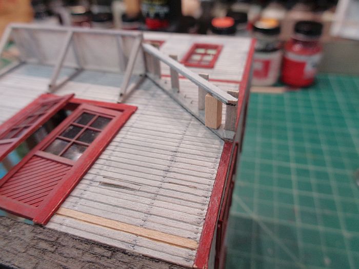

Here is what the modified 2X4s look like glued together.
Keep in mind the deck is framed with a 2X6. The HO scale inches of 6, now fits flush over the outside of the deck.
I glued the corner one in place and then added the front corner post. I made sure the post was vertical until the glue dried.
I let some glue get tacky and then glued the outside stringer to the edge of the deck.
I used a block to support the stinger until it dried. I added a few steps to the stringers as it dried for stability.
When the staircase stringers were dry, I added the rest of the steps and added a 4X4 support post under the staircase.
I added the rest of the deck railing posts to the deck.

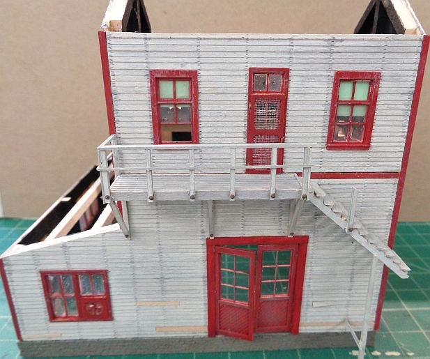

This whole process required a large bottle of Diet Pepsi to keep me focused. ;D ;D
I added the top railing using 2X4s and the middle railing using 2X2s.
I then added the N&B to the bottom of the posts as shown.

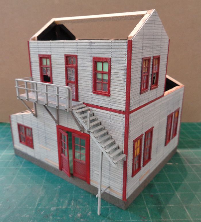

Tomorrow I'll add a corner landing and take the stairs down by the right wall and in front of the windows.
All is well and good, even level.
Done for the day and not only that, I'm finished.
Not only is your modeling skill up with the best , your how to's and way of sharing them is appreciated dearly Tom, thank you very much.
Watch out for that last step coming down from the second floor.....it's a doozy.  ;D  Give the inspector enough cases of Diet Pepsi and he might pass the stair inspection "as is".  ;D ;D ;D
Tom, it all looks awesome and fantastic, BUT, my bad knee would not let me take that first step.  I need a step ladder to get started.
It all looks amazing. I don't think anything you build would dare to be not level and square. ;)
