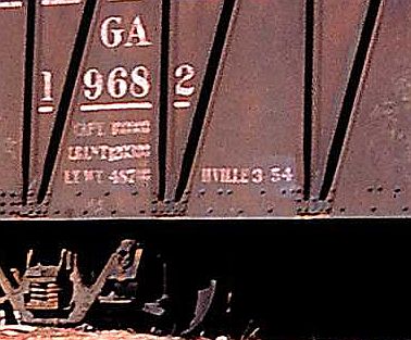

Tom, do you know if Georgia 19862 (the outside braced, steel sheathed car from June 4) is a USRA rebuild like Tichy's kit?  I have one I'll eventually need to build, but no prototype photos. Can you read the reweigh date in the original?

James,
I don't know if the boxcar is a USRA rebuild or not. The photo was taken, if I remember, in 1966 in Thomasville, GA.
The rebuild date is 3-54. The GA. RR had a repair shop in Savannah, GA so I'm not sure what the Hville on the rebuild date means. Possibly Hendersonville, NC? GA RR had no shops in NC.
If the Hville is Mville, it would be Milledgeville, GA. I have no info that a repair shop was there either.
jbvb
I dug into Tichy's site and find their steel/outside braced kit shown as Georgia 19580, but painted with light (gray? white?) sides and a dark roof.  Can't read the reweigh date in their photo, though. But this photo will be useful when I get around to building it; thanks.

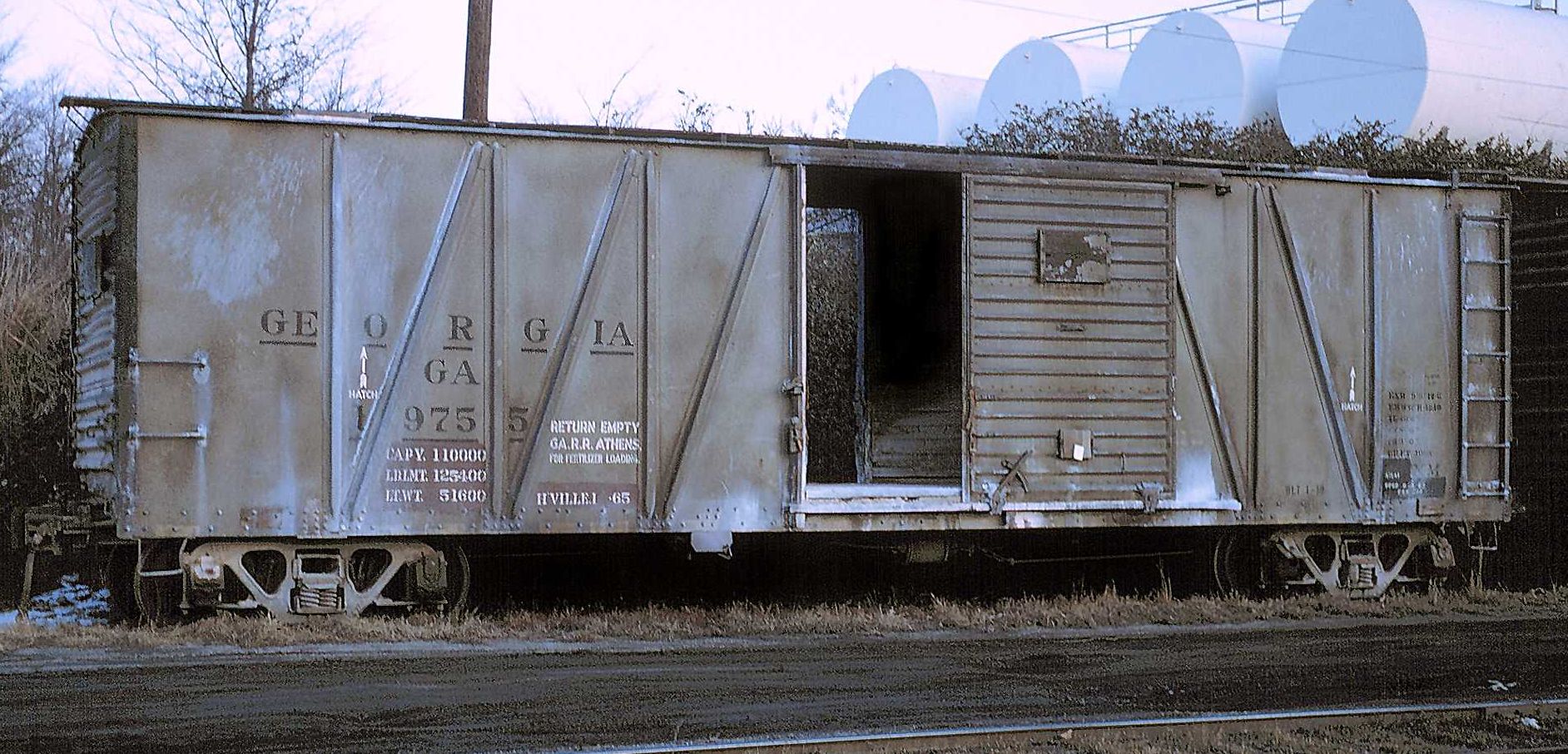

James,
The cars were light gray. This one has a build date of 1-19 and rebuild of 1-65. Hope this helps.

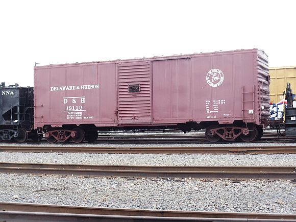

D&H boxcar from Steam Town.

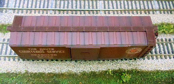

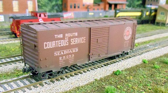

I went through a period of time where I weathered many of my boxcars. I did this after visiting Howard Zane. I liked how he weathered his but felt as though he over weathered them.
I think a mix of light, medium and heavy weathering is correct depending on the age of the car. His all seemed to be heavily weathered regardless of age. Certainly not being critical, but only giving my opinion.
I used an air brush to weather my boxcars.
The four main Floquil colors I used were Weathered Black, Grime, Earth and Mud.
If the boxcar was Boxcar Red, I used Floquil Boxcar Red. If Freight Car Brown, I used that. If tuscan, then Tuscan and so on.
The SAL below is a combination of Weathered Black, Boxcar Red and Grime.
I started by spraying a light coat of Floquil Boxcar Red on the sides, top and ends. I then used the Weathered Black on the trucks, wheels, lower sides and roof. A very light coat of Grime was used on the trucks, wheels and the lower sides and ends.
It is a Kadee PS1 boxcar.
HI Tom:
Nice. perfect light weathering.
