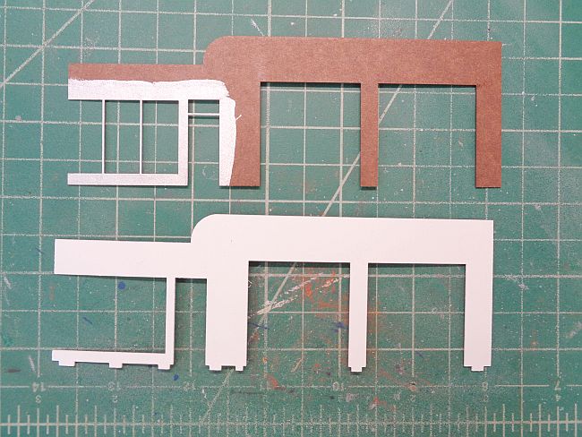

Below is a photo of the front/exterior wall and the front side of the middle wall. The front is on the bottom and the middle one is on top.
Although the paint on the top wall section appears white, it is actually silver.
The exterior wall is glued to/over the middle wall section.
Again, all exterior sides have tabs on the bottom for placement in the slots located in the base.

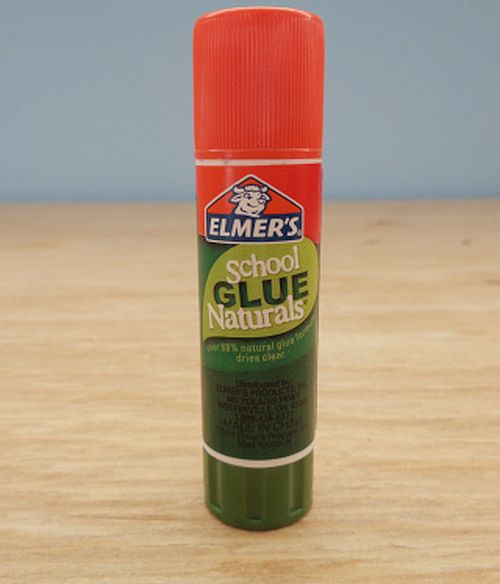

When gluing the walls together, I chose to use the Elmer's School Glue Stick.
This glue bonds paper together extremely well. I also use this to glue rolled roofing paper to the roofs of other builds.
I simply rub it on one wall section and then press the two walls together.
You have time to move and adjust the parts prior to the glue setting and won't squeeze out the sides. It also dries clear.

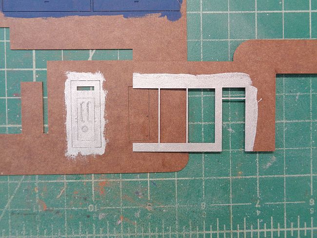

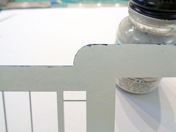

This next photo shows the interior wall section on the back of the middle wall. They have yet to be glued together.
In the photo you can see the brown color of the wall above the white. This needs to be painted your trim color, in my case the Gulf blue.
I painted the blue on the upper section of the wall. If you get a little on the upper portion of the front, don't worry. Well, if you only get a little don't worry.
I did this on purpose to show you that it can be fixed/covered.
If you are using a lacquer based paint, take a Q-tip, dip it in some thinner and wipe off the paint moving from below the paint to the top edge.
If using Tamiya, use Alcohol and if acrylic, use water. Of course this only helps if the paint is still wet. 8)

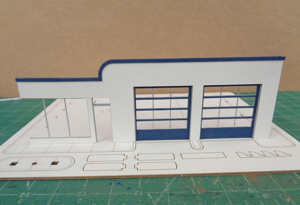

I left the paint on the wall and covered it with the exterior trim as shown below. I've also added the two garage bay doors so you can see how they look.
On my model the doors will be open so more on that later in the thread.

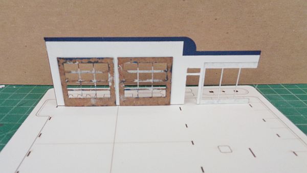

Okay, all three wall pieces are now glued into one wall section. Here is how it should look from the rear.
No need to paint the rear of the garage bay doors as they won't be seen when the model is complete.

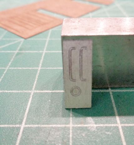

I then removed the front door push bars and glued them to the front door.
I used Canopy glue for this as it dries clear. I used a toothpick to apply the glue.
Once the glue was dry, I touched up the edges and ends with silver paint.
