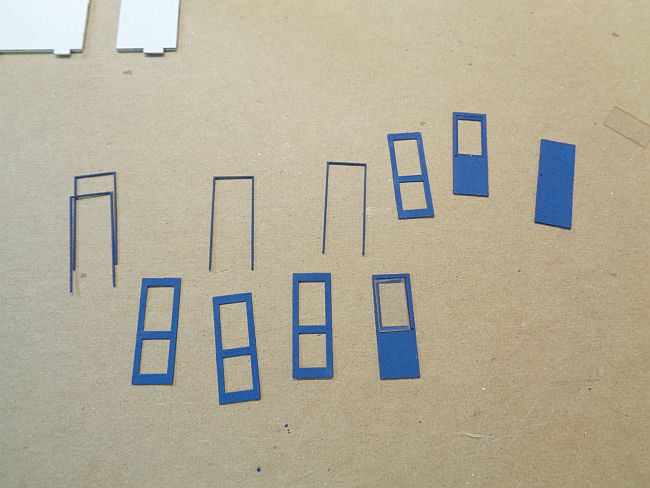

The interior wall came next. Unlike the exterior walls, this one only had two pieces. One side faces the office area and the other faces the garage bay area.
This wall has three doors. All the door parts were painted with the Gulf Blue.
Two of the doors have laser cut acetate/mylar windows. They fit in the door as shown below. The frames are to be glued to the doors to hold the windows in.

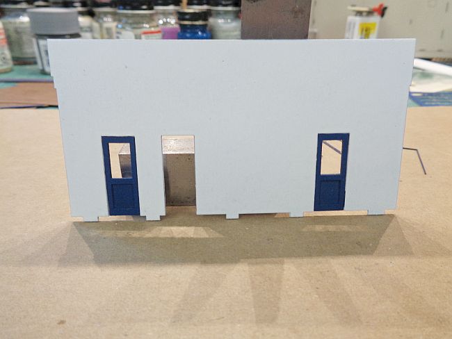

With the doors now complete, they were glued in place per the instructions.
Continued -
Here is a view of both sides of the interior wall.

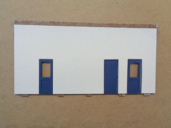

Office side -

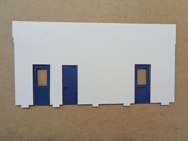

Garage bay side -

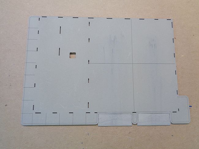

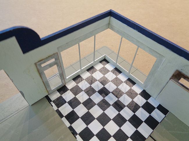

The office floor pattern was cut to fit and glued in place using the Elmer's glue stick.
Continued -

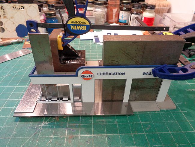

The front and left walls of the station were glued in place. Canopy glue was used for gluing the walls.
As you can see, every effort was made to ensure the walls were vertical and square.
Once these two walls were dry, I glued in place the front windows. The window is a large piece of acetate and laser scored in the middle to make the corner bend.
I used a toothpick to apply a very small amount of glue around the window opening. Using tweezers, I then placed the window in the opening.
I used a soft brush to press the glass in the opening. The brush also helped keep my latent prints off the glass.
I then added the two baseboards to the inside and below the large window. These also support the window display shelf.
When the baseboards were dry, the shelf was glued in place.

Can anyone tell where to get the weights Tom is using herein?
Quote from: BandOGuy on January 06, 2019, 04:40:29 PM
Late catching this fantastic build!
Chip,
Late or not, happy you found it. Thanks for the compliment.
The weights came from Micro Mark.
