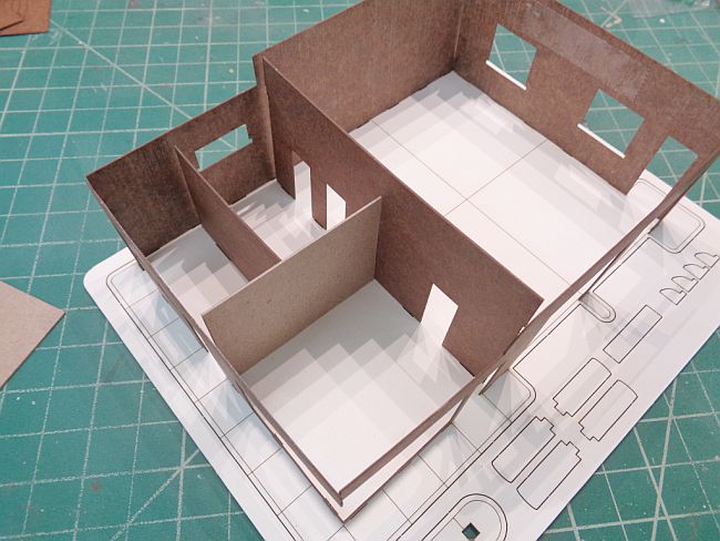

I identified the exterior/outside walls. They all have tabs on the bottom that fit into slots in the base.
I located these walls, removed them from the main carrier sheets and test fit them in the slots.
More in a few
Each of the four walls fit perfectly with no cutting/adjustments necessary.
I located one interior wall and placed it in the slots as well.

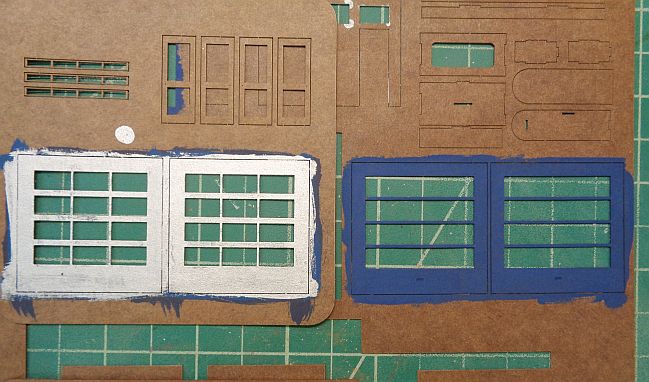

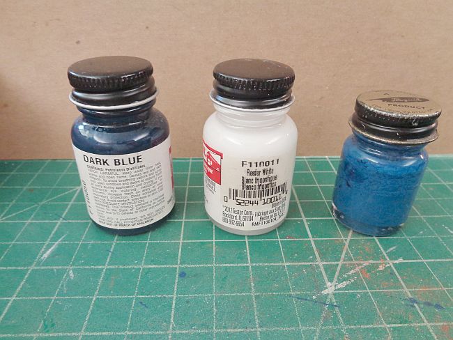

For the blue trim color, I chose Floquil Dark Blue. When painted on the garage bay door frame, it was to dark.
I mixed 70% Floquil Dark Blue to 30% Reefer White to get the Gulf blue color.
In the photo below, you can see the dark blue on the left, definitely to dark. When placed next to the gloss white walls, it looked black.
Referring to the photo above, that door piece is actually an interior garage door frame. This piece should have been painted silver.
I used Tamiya Silver to paint over the blue for the silver door frame. The correct (outer) door frame was then painted with the blue.
According to Darryl, Tamiya Flat Blue is also a very good match for the blue.
The door frames shown on the right in the above photo, fits over the frames on the left. I glued them together.
