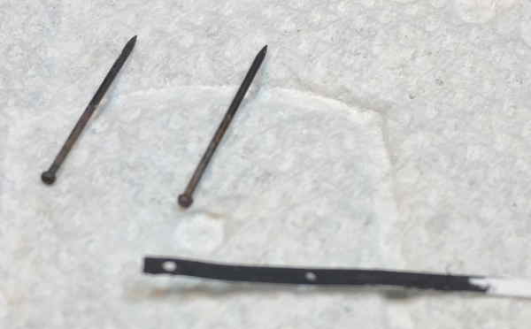

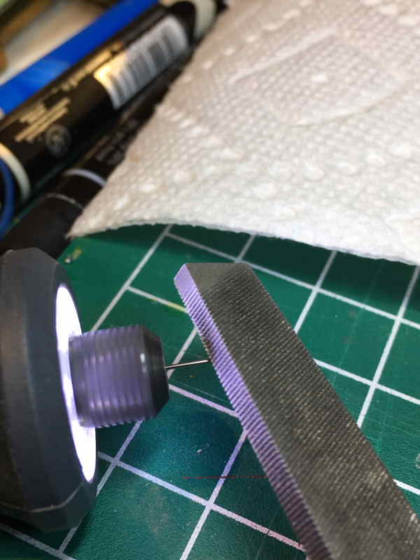

After gluing the roof together, I decided to tackle the door knobs. I started with Dritz #8s Sequin Pins. After chucking the pin in my cordless Dremel, I used a 6" mill bastard file to turn the head down to about 3 scale inches (.036"). The shaft of the pin is .020", but since it won't show, I elected to not turn it down.
The pin was then cleaned in alcohol and then dipped in Blackin-It and then in water to stop the reaction. While that was working, I made the backplate out of 1x4 styrene. The styrene strip was a bit thick, so I thinned it by drawing it across 320 grit sandpaper. After a couple of dozen strokes, the styrene was down to about .008", which should look ok. Charcoal color paint made for a good match to the blacken-it.

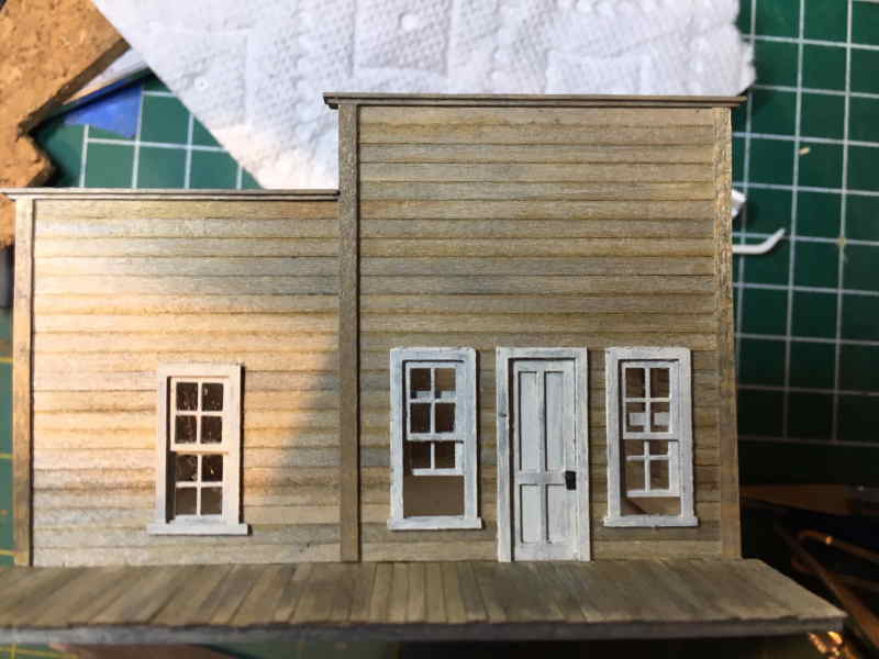

Next came the hole in the door. I used the styrene as a guide to drill the hole. Then cut the styrene to length, slipped the pin through the hole and secured with a bit of glue.

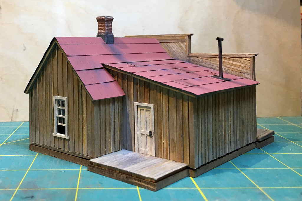

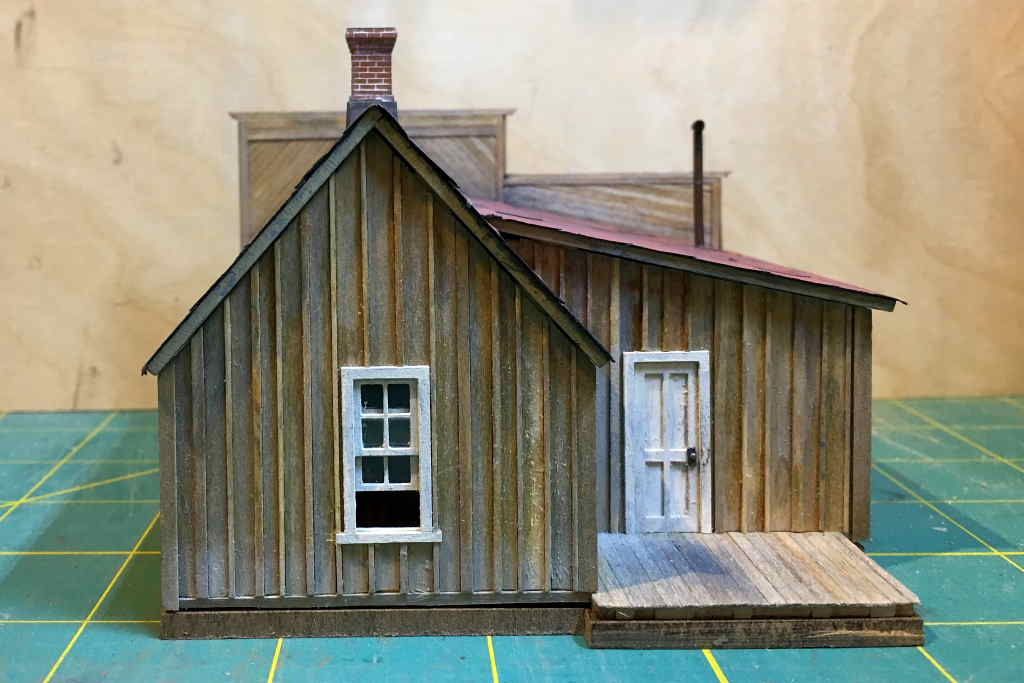

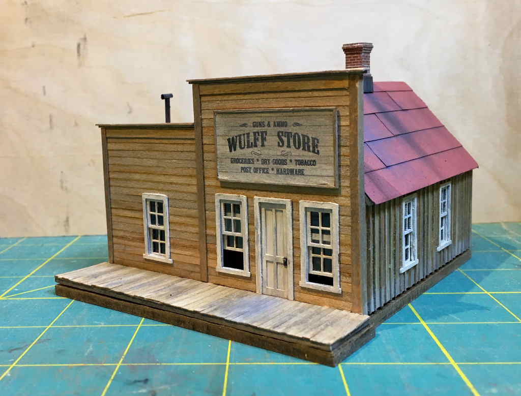

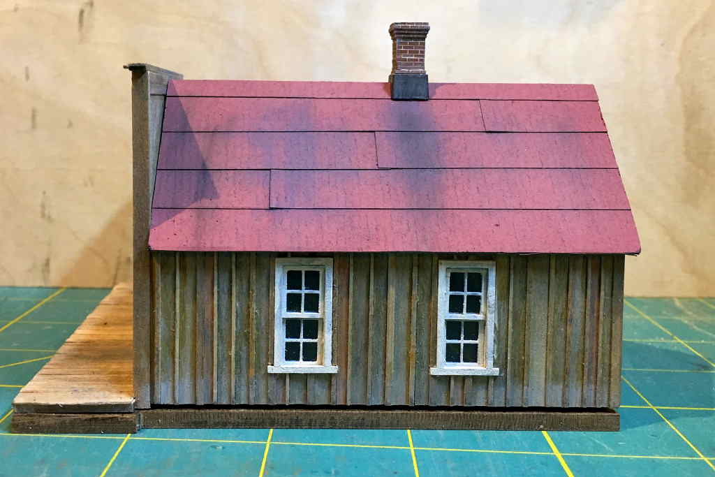

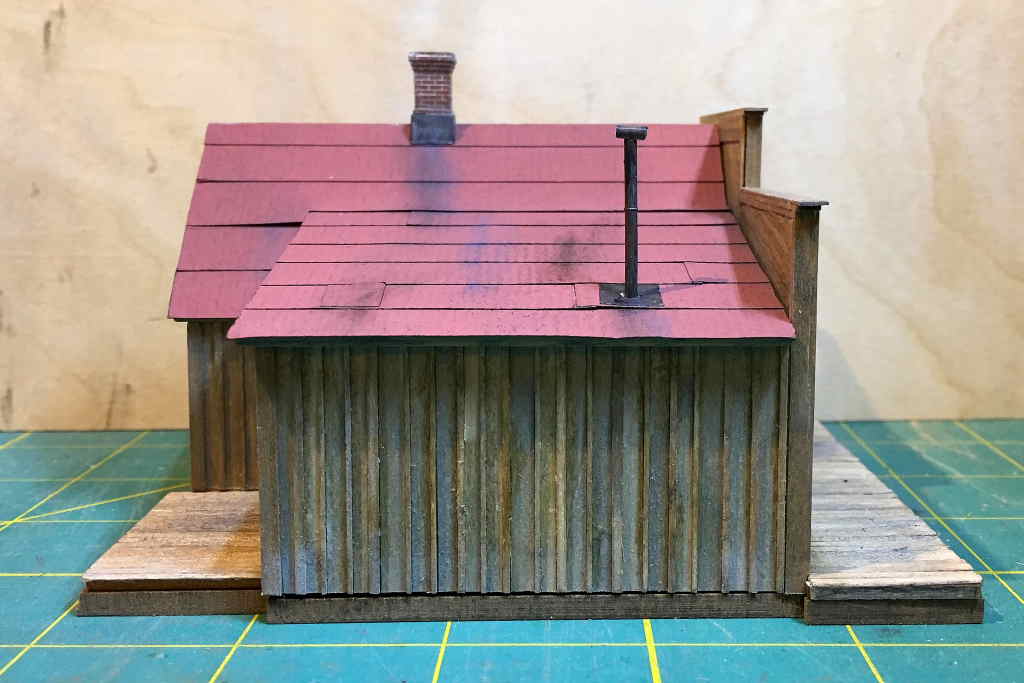

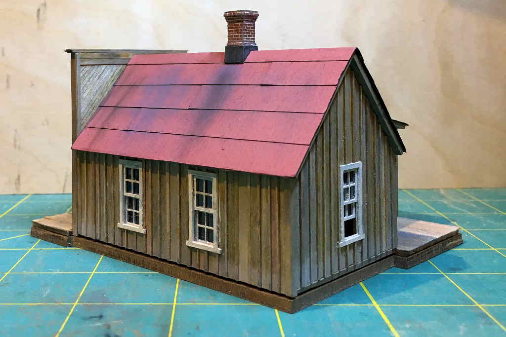

Well, I finished up the store today. After the door knobs yesterday, I installed the roof, and covered it with red tar paper roofing from Builders in Scale. I then added a Grandt Line chimney and stove pipe. I built a foundation from masonite that will be attached to the module so I can remove the building when traveling.
Weathering was done with Pan Pastels. Next I will construct the matching outhouse.

Larry, agreed, beautiful job and really nice attention to detail. The diagonal boards on the rear of the false front add a special touch.
--George
Thanks for a great build Larry , love the weathering of the wood , the red tar paper roof, and the sign looks very authentic.
