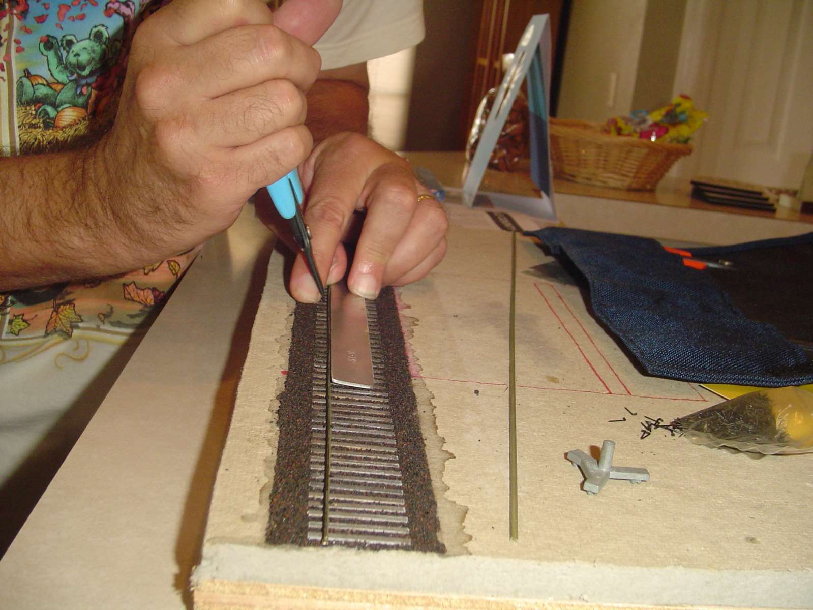

After lining up on rail on the edge of a tie and using a gauge to space the second rail appropriately I measured the distance between the second rail and the end of the tie.  I divided that by 2 so and used that the spiked one rail down that far in from the end of the tie so my rails would be centered over the ties.  This is probably the last time I'll get to do something like this on the kitchen counter.  That counter is now gone and we're waiting for the new on to be installed.  If I try doing this on the new counter I'll probably be homeless.   ;D

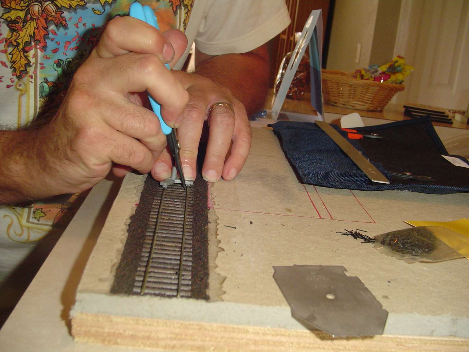

Using a code 83 gauge I spiked down the second rail.  The pros and cons of hand laying track vs. sectional track would be an interesting topic for a thread of it's own.

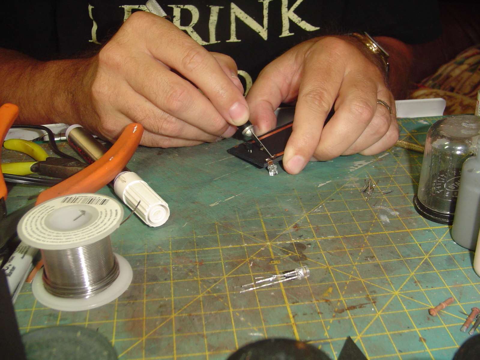

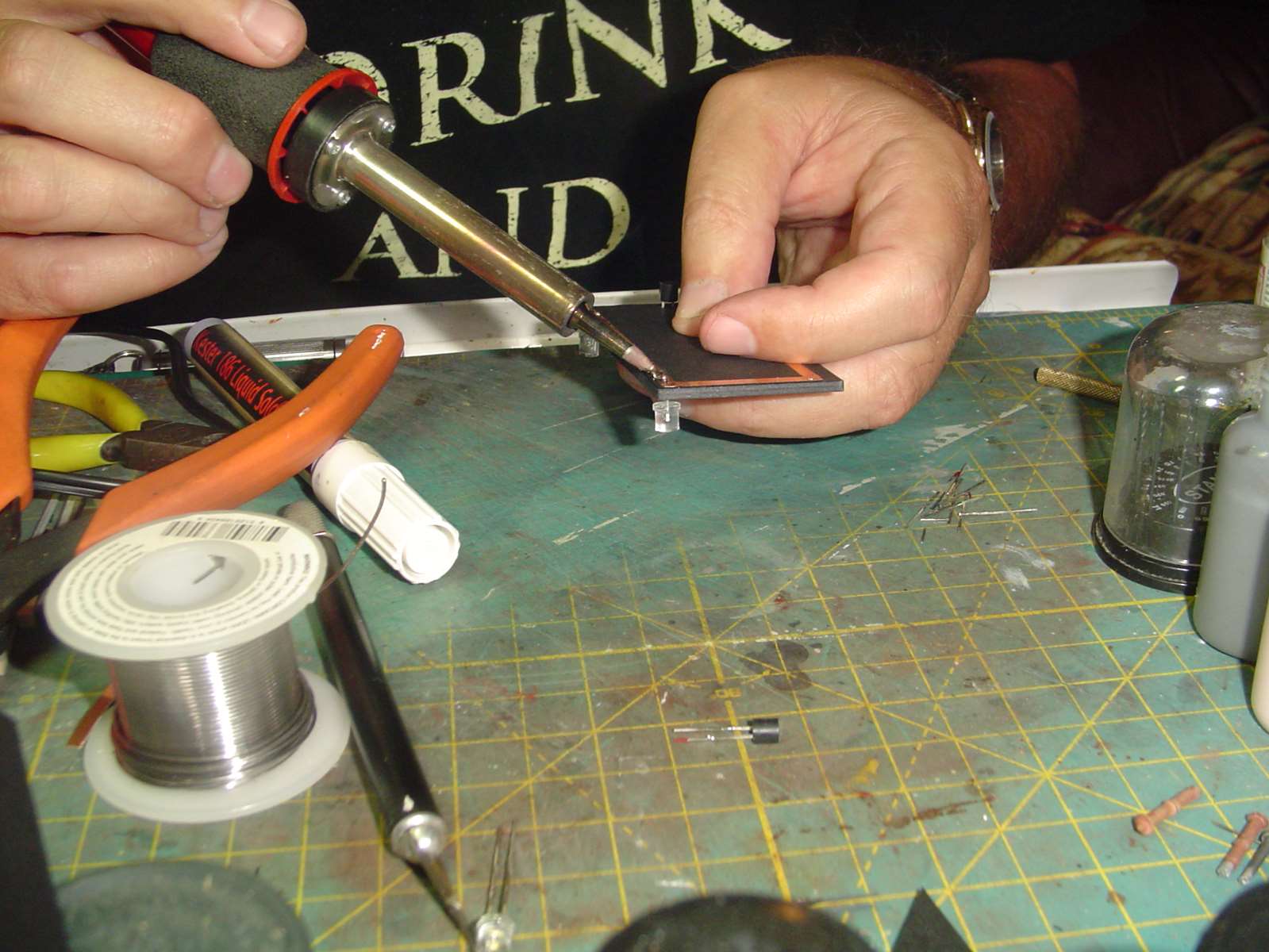

Getting closer to having to glue the main structure down to the base so I started working on the lighting.  I had a vision, in my head, of how I might be able to do this so I started constructing the components to go inside.  I use a black photo mounting board I cut into pieces along with LED's and copper tape to make it happen.
Basically I lay the circuit out with the copper tape, drill wholes through the tape and board where I want the LED to be positioned, push the legs of the LED through the holes, bend them to a 90 degree angle and trim off the excess.  After soldering the legs to the copper tape I cut out the section of the tape between the legs.

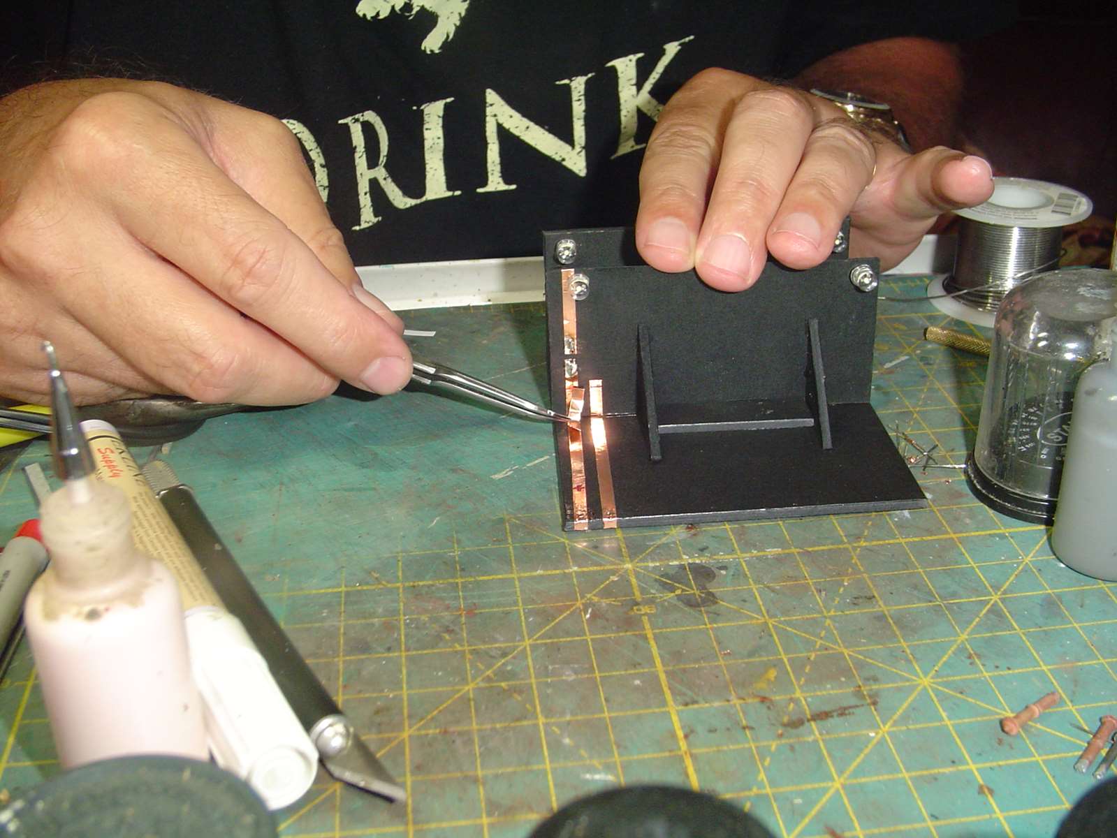

Where I have two boards join one another I had planned ahead so the tape would line up.  Then I use a small piece of copper tape to make sure the two connect.  I do solder this little piece in place.

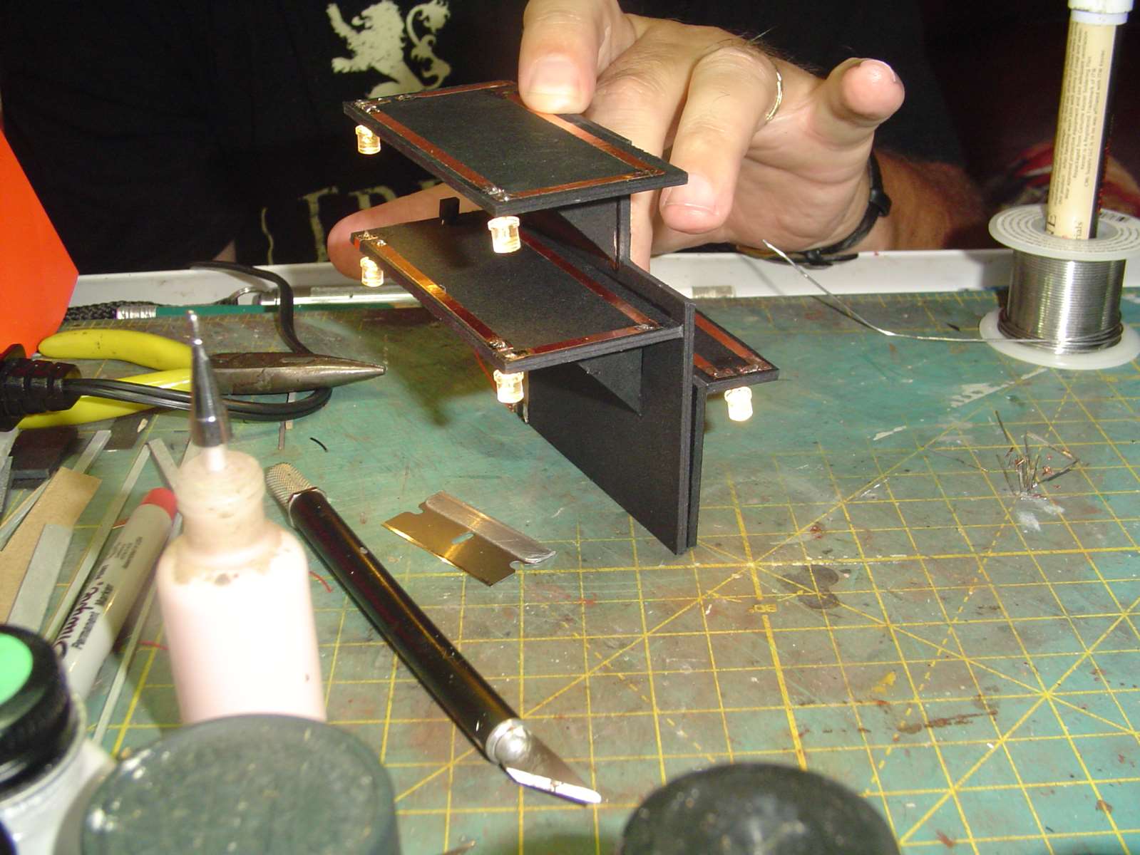

My 'vision' comes together!  In the words of Dr. Frankenstein "It's alive! It's alive!"   :P  8)
More in a moment.... ;)
This is how I plan on holding the two lighting circuits in place in the structure.  There's an interior wall.  One on each side and office binder clip.  Now I know how big an opening I have to cut in the base to be able to access the lighting circuits if they need to be removed for repair.

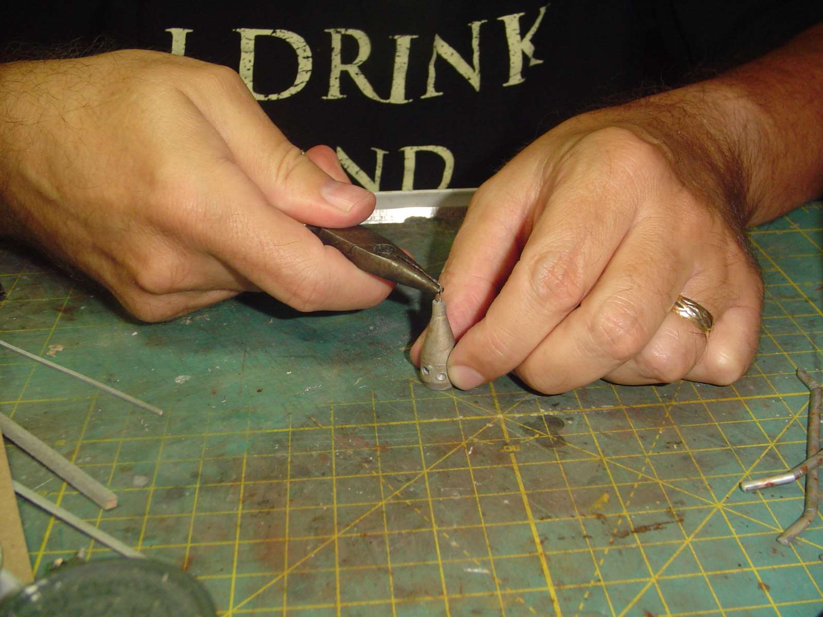

On the roof top vents.  I airbrushed these with Floquil Silver and then gave them a wash of AK Interactive Gray wash.  Now it's time to add some rust.  I opted to use oil paints for this.  I don't want these to be 100% rust.  Only patches of rust with silver still visible.  Oil paints are great because they're very forgiving.  If you over do it or don't like the looks just dip a brush in mineral spirits (odorless) and wash it off.  Lot's of working time.
A very light brushing, downward, with a brush dipped in mineral spirits will give some nice rust color streaks too.
After drilling the hole I use a file to angle it to match the roof (oriented as it would need to be in place - that's important).
Then I cut the head off the brass nail and glued it in place in the hole I drilled.
