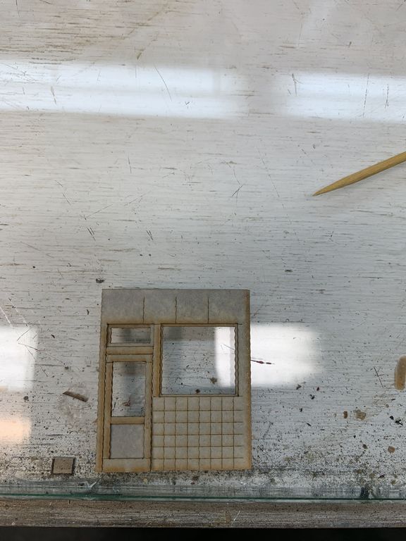

This is the door assembly for the right side opening.
Here it is all glued together.

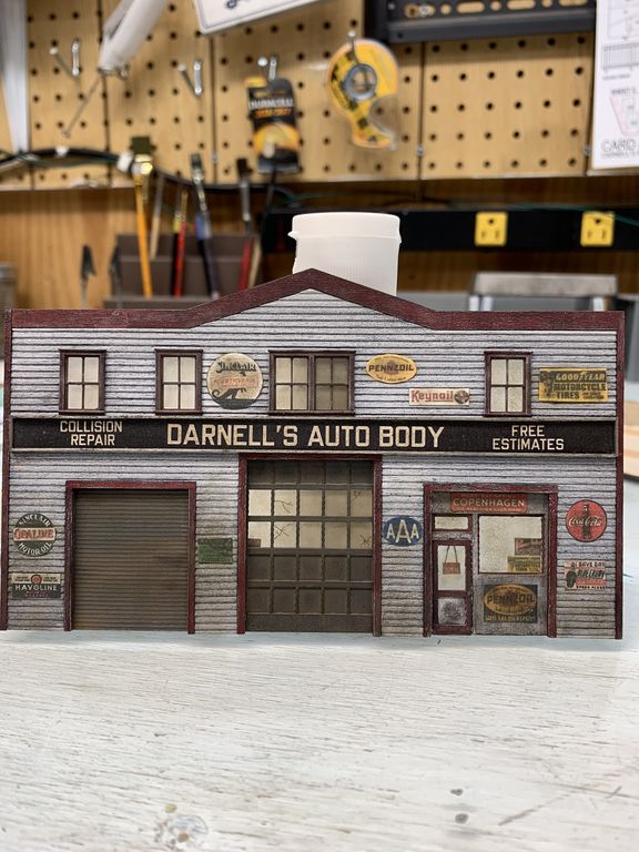

I painted it white and weathered it with some chalks and A&I. I covered it with some signs and glued it in place. I also dirtied up the lower couple feet of the building.

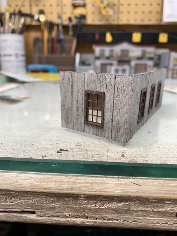

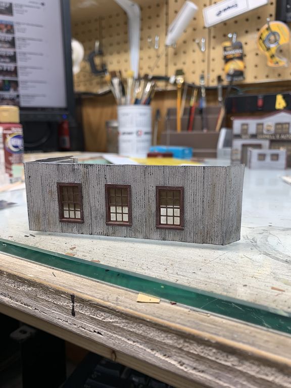

I started gluing the walls together. Not much interesting happening on the other 3 walls yet. I did add some window shades all around. I bought a combo pack of olive green, light tan and dark tan construction paper I use for this.

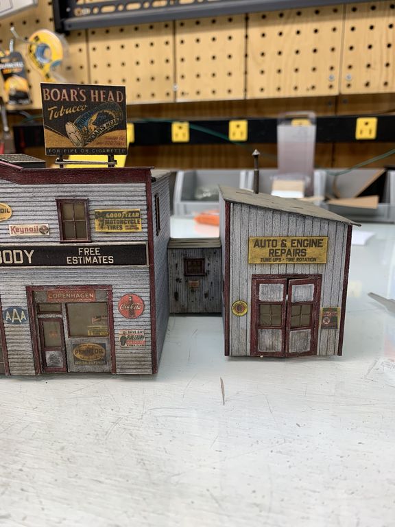

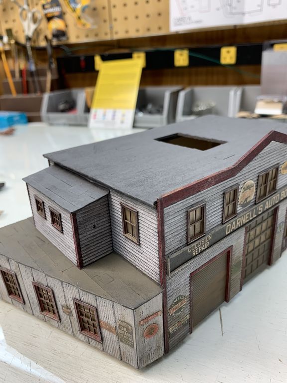

The biggest challenge I had was trying to get a decent coloring I liked for the corrugated siding portion of the building. I wanted it to be the same color as the rest of the building but some peeling and rusting on the panels. I always struggle with getting corrugated metal to look good to my eye unless it's super rusted.

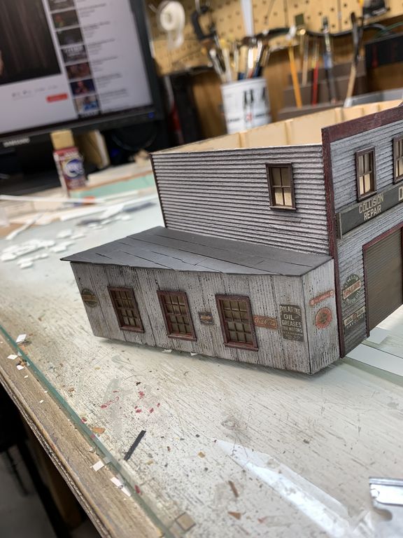

This is what I came up with. The corrugated material is wood just like I used for the metal door. After some experimentation I came up with a very easy way to do the peeling paint. I sprayed a base of dark gray krylon primer and let it cure overnight. 2 coats of white craft paint same color I used for the main building. I washed the walls with A&I and as soon as it started to dry I used some tape on my fingertip to pull up some sections. The alcohol in the wash causes the paint to loosen a bit. I poked it in spots with a toothpick also. I gave it another coat of A&I and some chalk weathering.

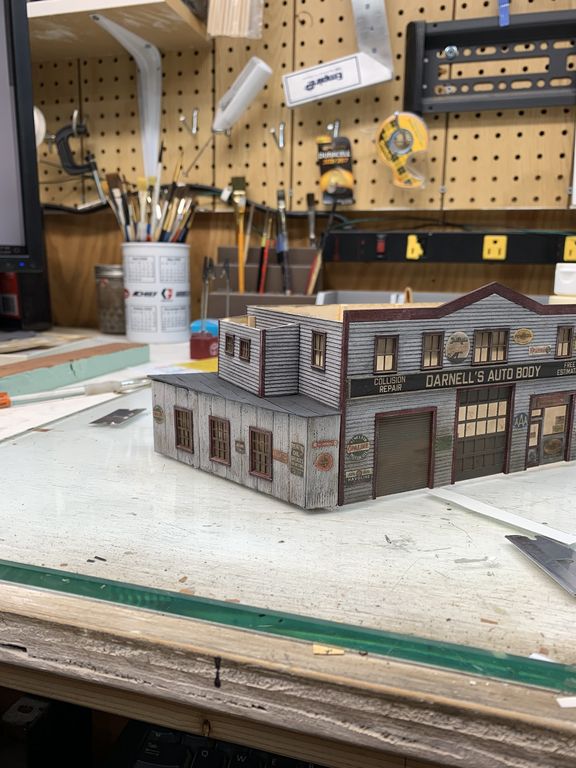

Here is the wall assembled. I didn't paint or prime any of the panels before I added them to the wall. After everything was dry I painted and weathered it.
The small side shed is a weird shape so I had to get a little weird to hold everything in it's position while it dried.
Once I started adding some signs it started to look right to me. After reviewing the pictures I'm going to rust up the bottoms of the walls a bit I think.

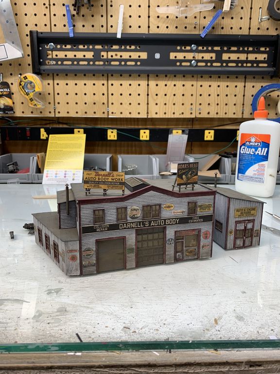

I added the roof. It was painted with dark gray krylon.
The little addition sits on top of the roof.
Here I have both roofs in place.
The kit came with this cool laser cut skylight.
I didn't take a picture of the skylight before I added it but I just painted it with the same dark gray I used for the roof and added some acetate for the windows.

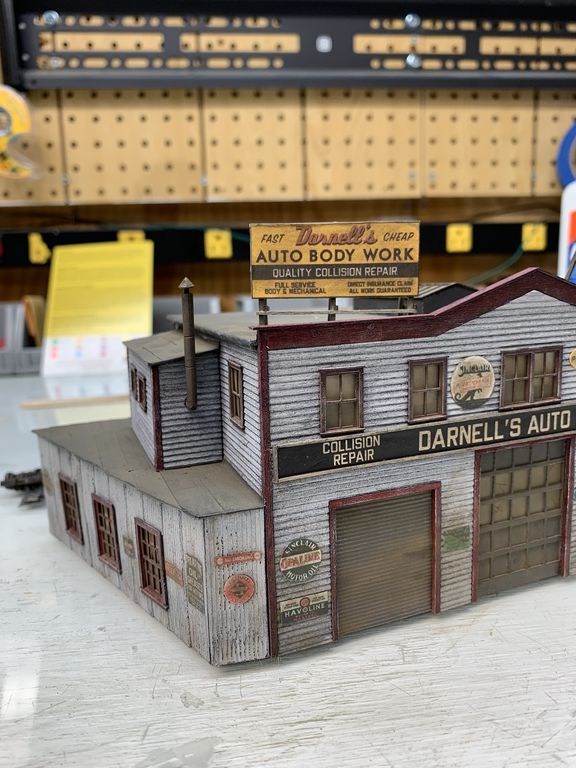

I added the 2 rooftop signs.

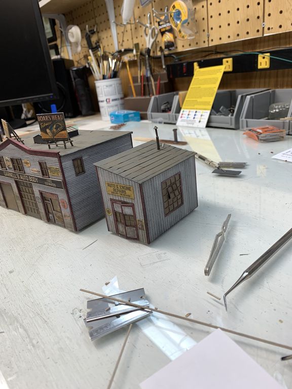

The corrugated metal pieces I showed earlier fit in between this smaller shed and the main building. The shed was built and weathered the same as the main building.
I added a few chimneys but I still need to add a bit of detail to the roofs.
