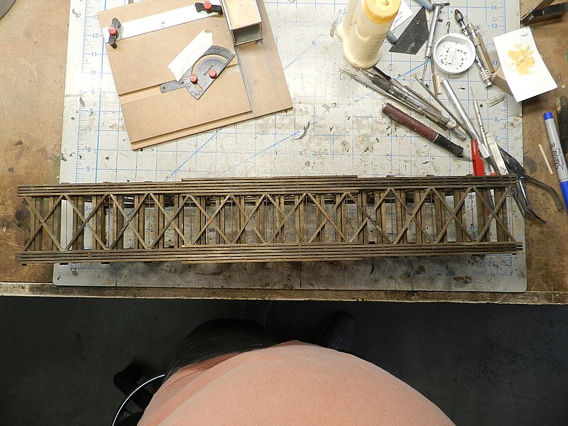

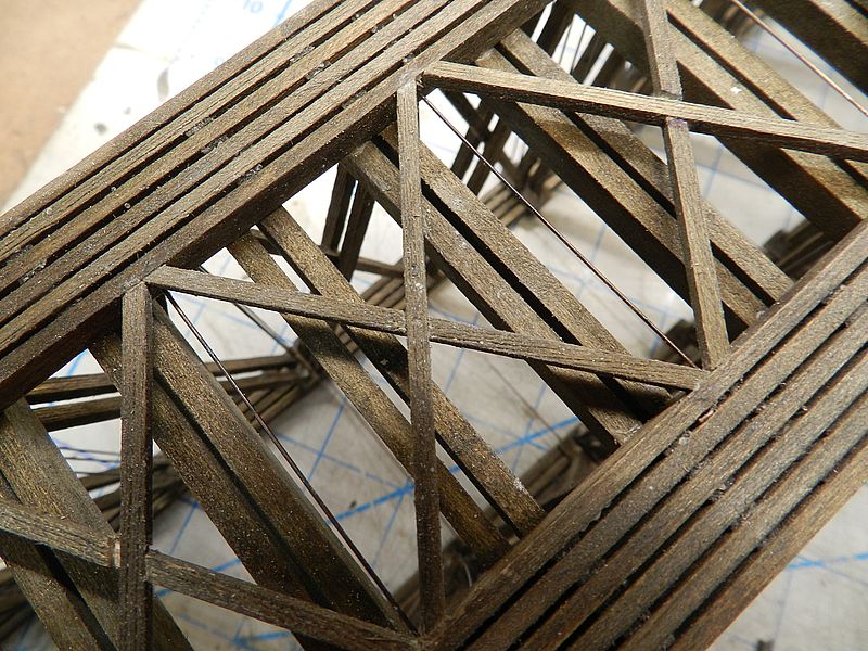

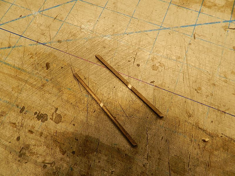

Attached are more progress photo's of the bridge.  I notched the cross braces that go on the bottom of the bridge as shown so they would sit flush.
Steve Drees
SP RR

Quote from: dick green on May 22, 2019, 09:42:26 PM
HO scale half lap joinery. I'm impressed!!
I second that!  And that top-down photo showing the complexity is a work of art in itself.   Nice build, Steve.
--George
sdrees
Thanks George, appreciate the nice comment.  What you are looking at in this picture is the Bottom Chord.
Steve Drees
SP RR
