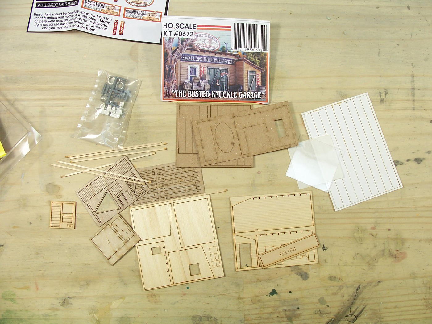

The Chainsaw Sharpening building is a Bar Mills kit. Here's what comes in the kit
They're really a pleasure to build. The parts fit together perfectly with only very minor clean up. Mostly done with a razor blade and a nail file. The only modifications that I did were making one roof corrugated metal and making my own signs. I still need to weather the building and add a lot of details.

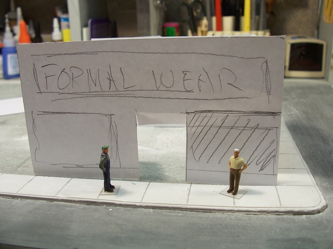

I did a couple rough sketches and fooled around with paper to get the "Formal Wear" building about the right size.

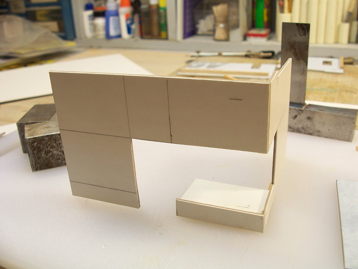

I'm using Illustration Board to construct the building.
The basic shape is there. I have to add the finish and details.

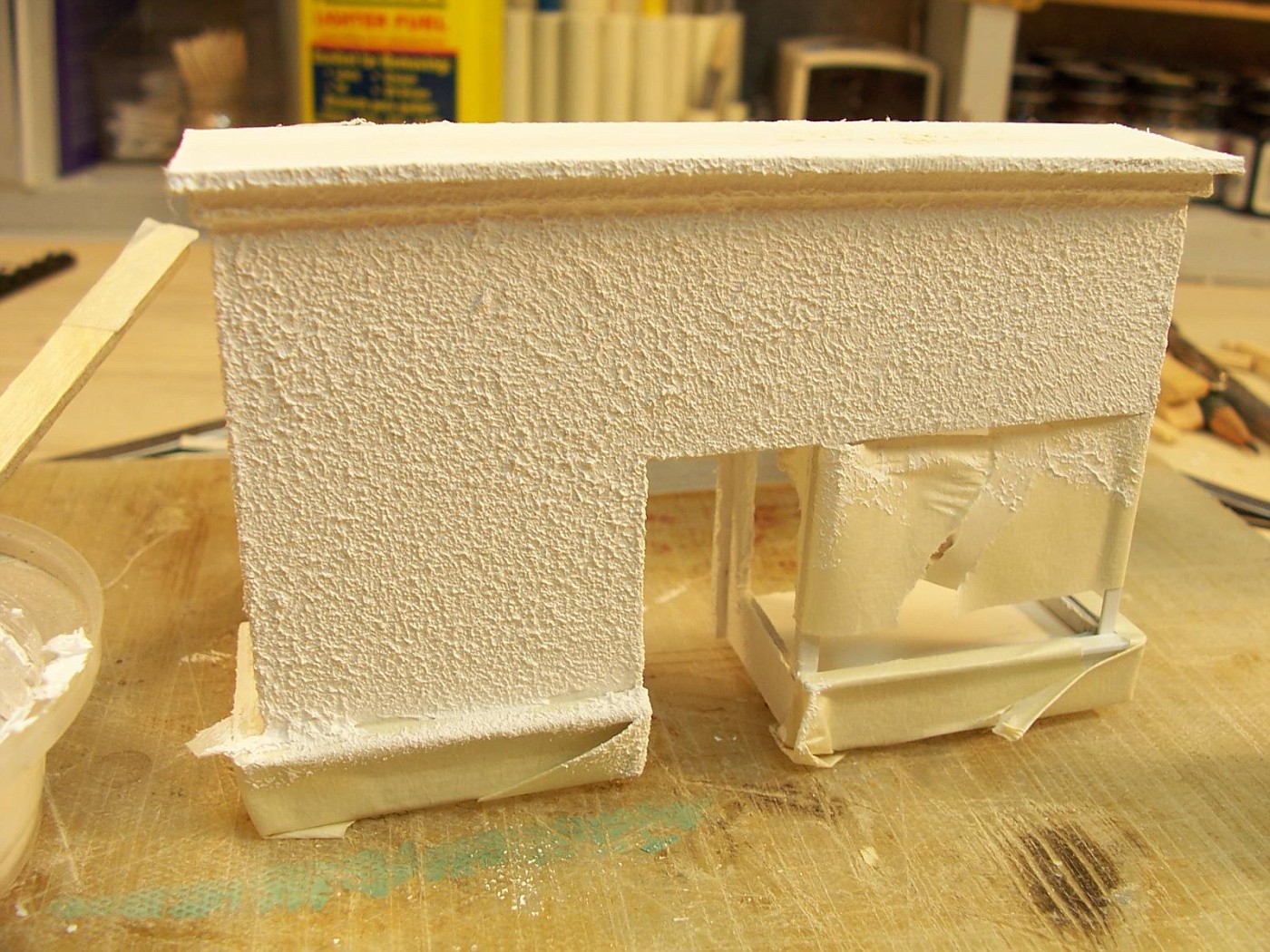

I added a few minor details to the building and then gave it a shot of white primer. Then I mixed acrylic paint and plaster about 50/50 and dabbed it on with a piece of foam rubber.

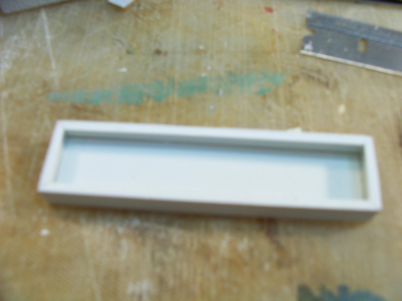

I made a sign box for the front of the building. It's going to be painted black.

Your way of modeling a rough plastered wall looks fantastic!
I'll keep this method in mind as a worthy idea to steal.

  Your doing some great looking modeling Dave.  Very clever way of making stucco, looks very real. Thanks for sharing.

great build, i must keep it in mind doing stuko
