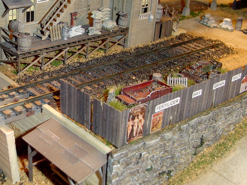

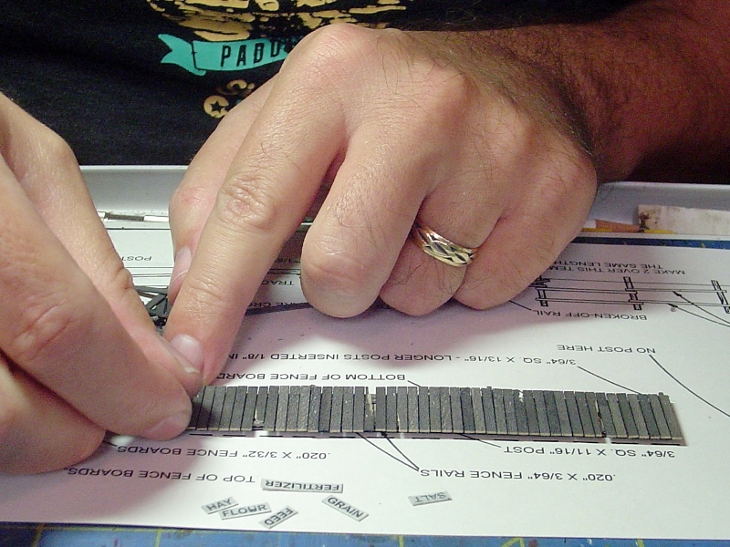

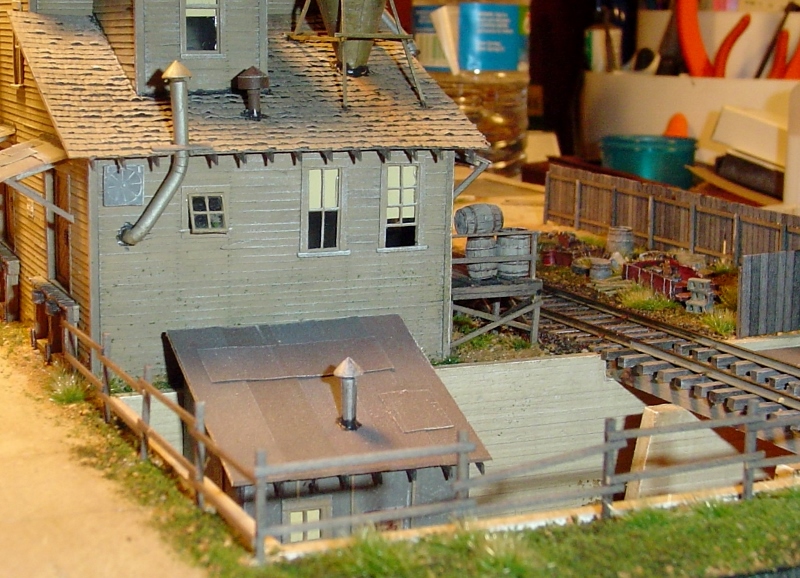

Just a mini update.  This past weekend I worked on the fences.  There are two types of fences that need to be built.  One, as seen below, is built directly over the template.  I split/broke some boards as I added them but had to be a little careful because this fence has a lot of signs on it.  I didn't want a missing board (or half missing board) beneath a sign.   :)
Here it is in place with the signs on it.  I still have more details to add around it.  More weeds and bushes, empty boxes, debris, etc.
The other fence is a post and rail type fence.  This one is built in place rather than over the template.  I just eyeballed it and used the template as a guide.
Aside from that I worked on the second of five or six Jordon vehicles I plan on adding to the diorama.  I'm not going to cover building those.  They're nice little kits but they're a real challenge.   :D  I'm also waiting on some Tichy Track stops I ordered so I can add one to the end of the track and finish detailing that area before I add the telephone pole and power lines.

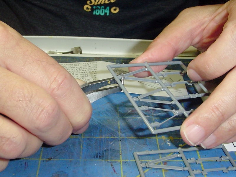

Here's a mini-update.  I've been building some Jordon vehicles to place around the diorama and I'm not going to bore you with those builds because I can only do a passable job with them.  Instead, I thought I'd share building a Tichy Track Stop.   :D

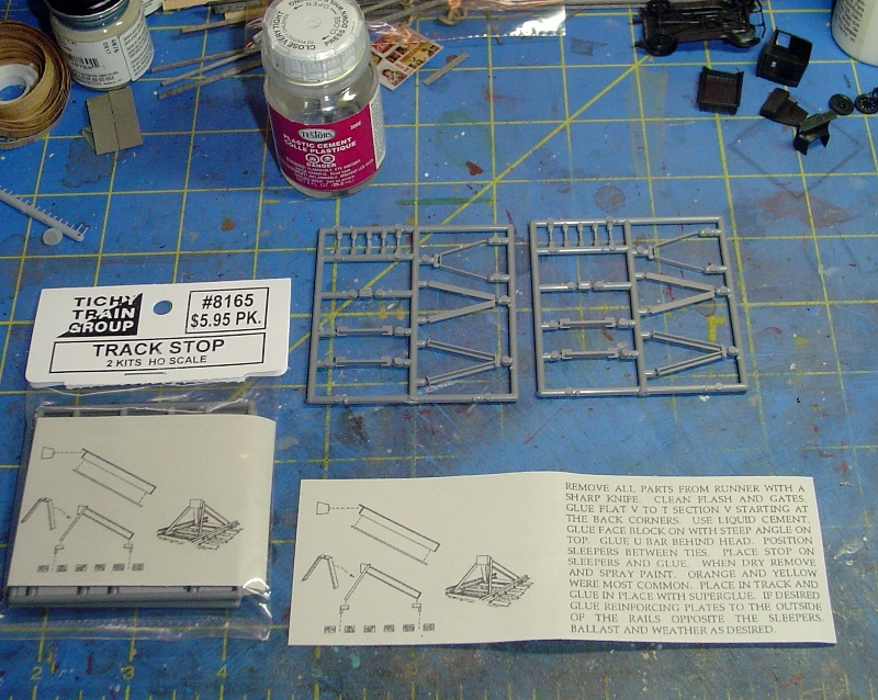

Here's the contents of the package.  Each pack contains two track stops.  Even though I only need one right now I'm going to build both.
I trim the pieces from the sprue using my handy dandy little sprue cutter.  Then I touch up any edges that need touching up with an emery board.

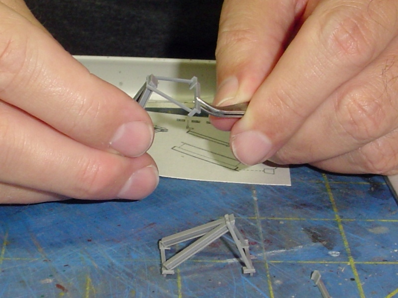

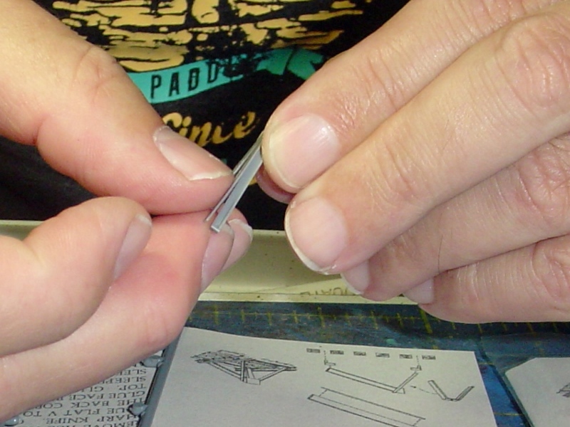

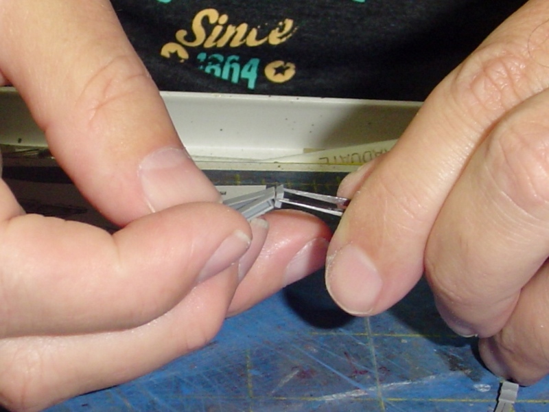

I start by gluing the two pieces (top and bottom) together that make up the I beams.  Just make sure they're lined up properly.
Next the head gets glued to the I beams at an angle.  The part is made to rest at an angle so it's not difficult to get it right.
After gluing the front support in place the only thing left to do is glue the sleepers in place.  (Note;  The instructions actually call for installing the sleepers in between the ties and then gluing the assembly in place but I prefer to build the whole unit first, then paint it and then install it in place).  This is mildly difficult because there's not a lot surface to surface area to glue.

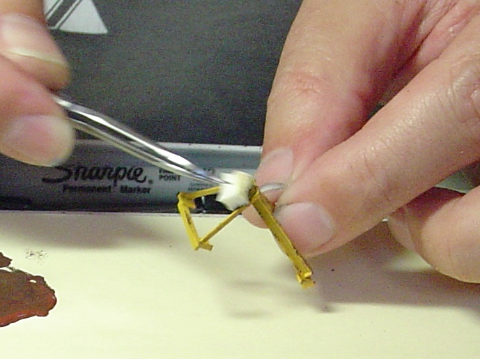

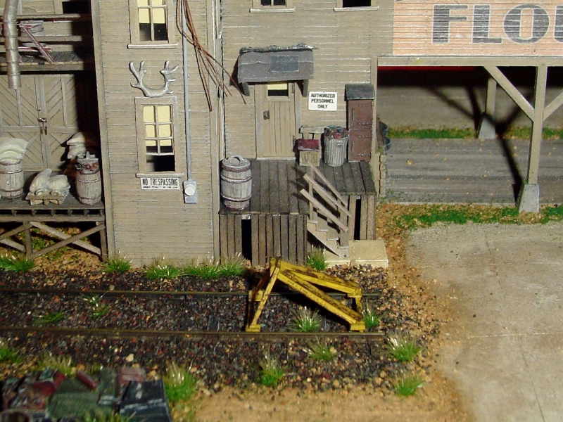

After both were assembled I airbrushed them first with Floquil Primer and then, after that had cured a few days, with Floquil CSX Yellow.  Next I mixed some Raw Umber and Burnt Sienna Model Masters Acrylics together to get a dark rust color and used a tiny piece of sponge to dab on a little bit of the rust colored mix.
Final photo in a moment...
Okay, here's the track stop in place.  One thing I have left to add are the reinforcing plates (tiny little plates with nut, bolt, washers cast on to them) to the outside of the rails where the sleepers are.  To install the track stop I first put a few drops of rubbing alcohol on the ballast to loosen up the glue.  I also wanted to add another layer of texture to the siding so I sprinkled on some cinders, some dirt and some more ballast to partially cover the track.  Then I wetted the area down, added some thin white glue and water, placed some full strength white glue where the track stop was to sit, positioned it in place and let everything dry.  After that I started adding some weeds.  I still have some other debris to spread around but it's coming along.
These are kind of delicate little assemblies so I wouldn't count on them stopping a car being pushed buy an HO Scale engine but I really like the look of them.   :D
