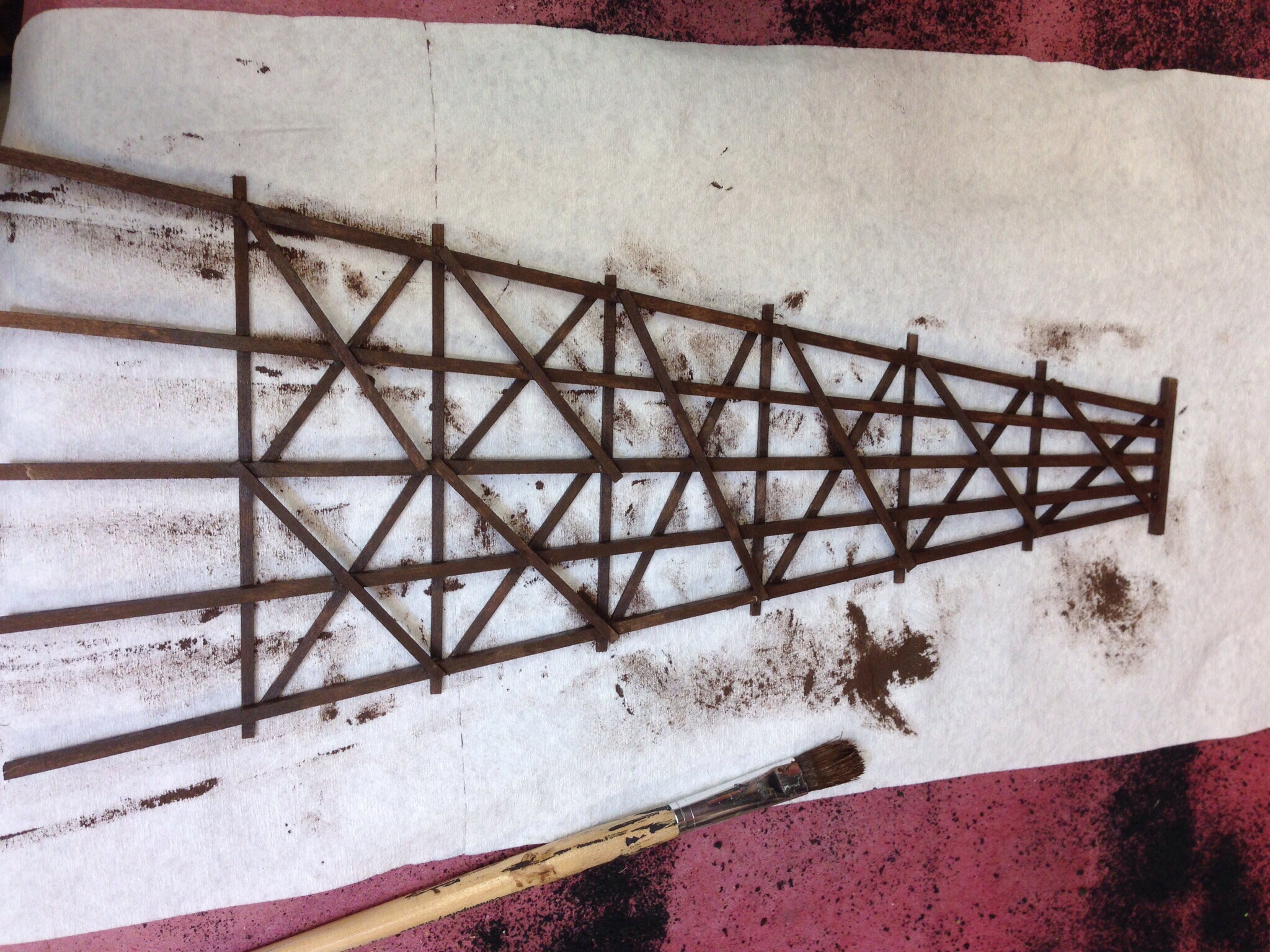

Here is a picture of the first bent after it dried.  It looks like the glue covered but is shinny.  It turns out that a wipe down with a rag left excess stain which did not soak in as I thought it wood at the joints. It looks like a lot of glue that is covered up but it's only a shinny area from excess stain.

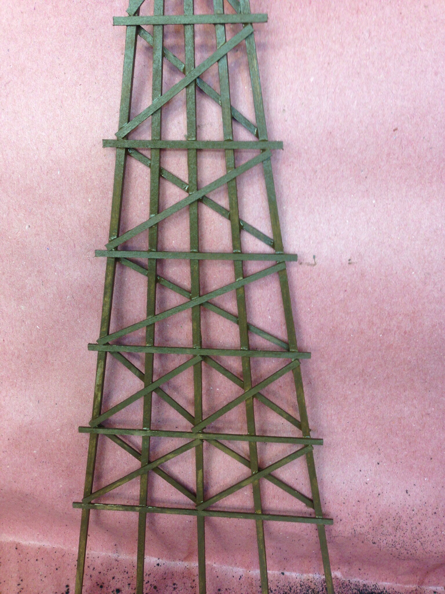

So I revised the process and wiped the entire bent with a rag and then took a dry brush and wiped down the joints.  Here is a picture after that process. What do you think?
The next step will be a A&I bath. I'm very interested in your feedback.
Minwax is an excellent stain and I'm not surprised that it covered. The shiny spots on the joints can be handled with Dull Coat. However, it appears the second coat being wiped on took care of everything. At least I do't see any shiny spots on the bent after the wipe down.

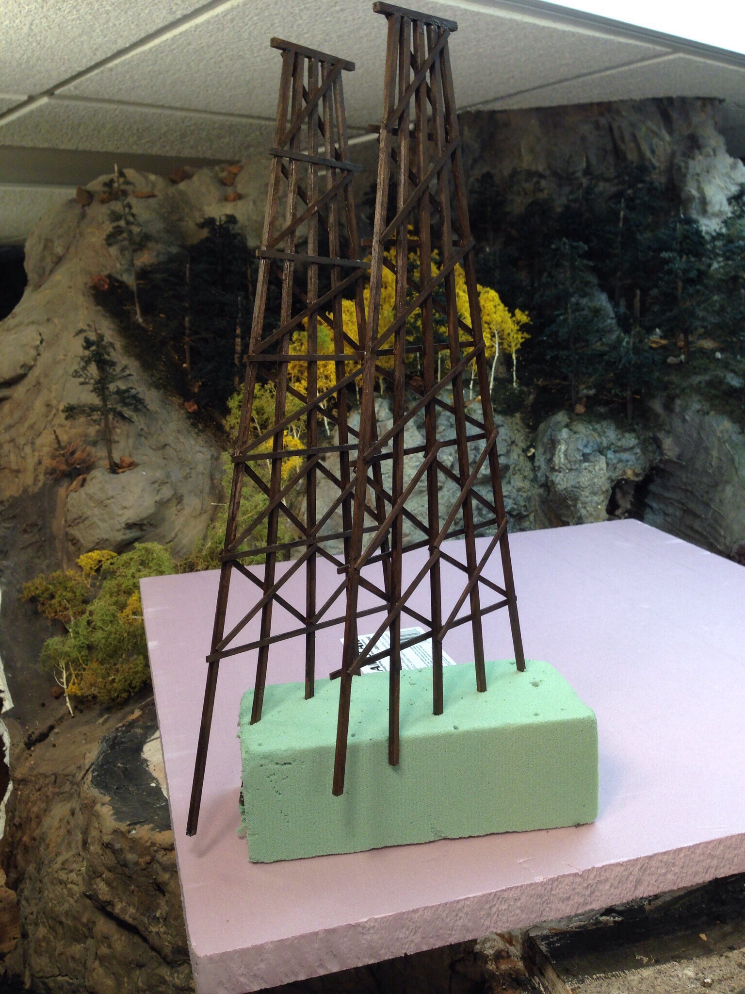

Here is a photograph of the first two trestle bents after the A&I step.  I'm using the 3 table spoon to a pint formula here.
gnatshop
Wowzzerrs!  That trestle looks close to the ceiling - do you have oxygen masks for the crew members??
The A&I finished them off great!   ;D ;D ;D ;D ;D

Thanks for stopping by the thread and for the input.  As you can see from the picture, I stuck the stained bents in a piece of foam next to the scenery.  I'm happy with the staining process but right now I'm leaning toward the bents look too new. It looks like the trestle was just built.   I'm going to make a bent up with the old fashion A&I at about 3 of 4 table spoons of ink and see if I like the older look better before I go into full production mode. I'll post some pictures and let you know what I decide.
One final point on the stain - I painted a piece of basswood with glue - let it dry and then stained it - it covered with the dark brown stain, but you had to let the stain dry before doing much wiping.  The process needs to be tested with a lighter stain.
