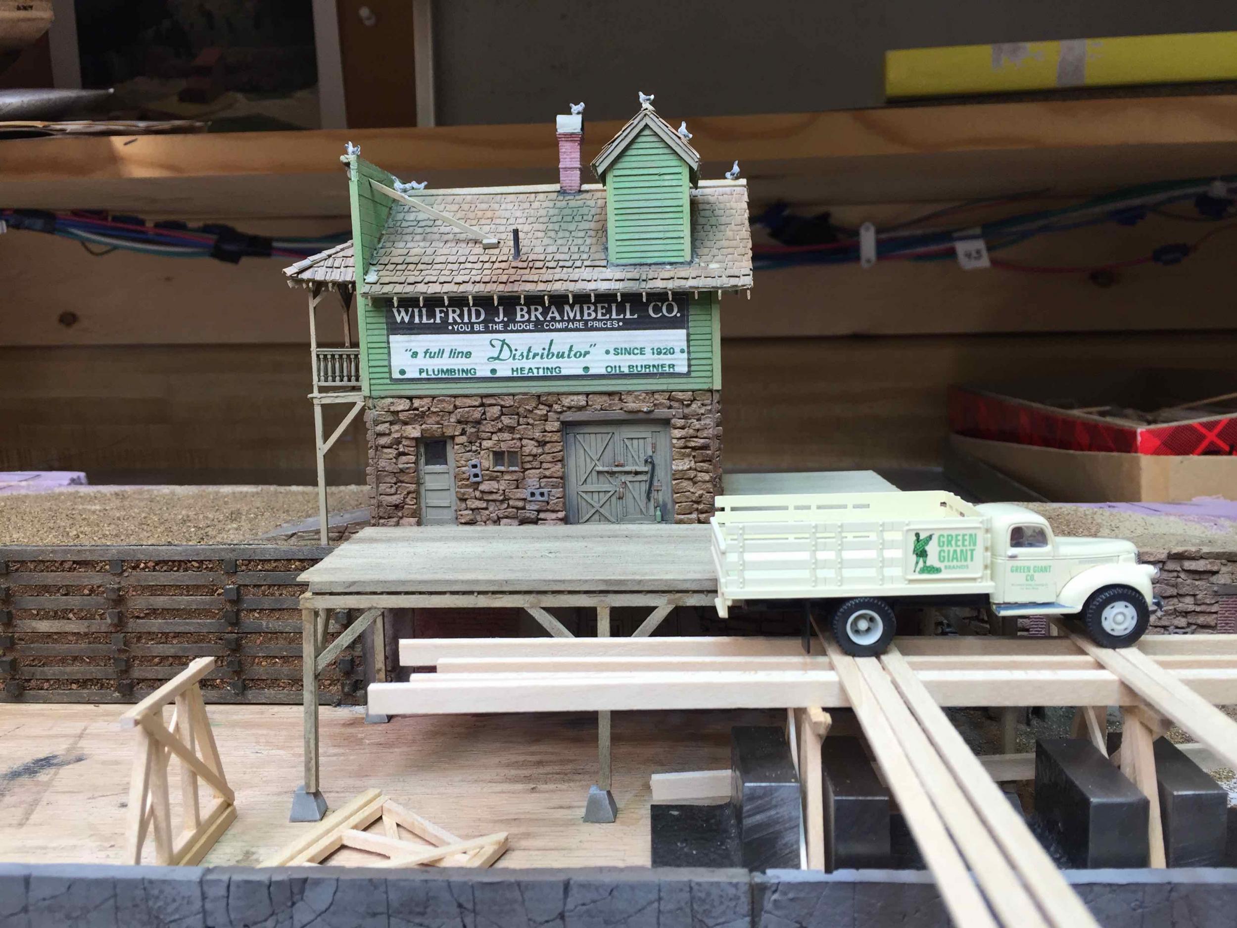

Today, I finished construction of the warehouse deck. Tomorrow, I will add the legs and glue it to the warehouse.
Today's progress pictures of the Brambell's build.  Finished the front porch and added more details. Next step is to add the completed deck.  In my version of the model Brambell's has added a new cedar shingle roof to the warehouse since the war.

Thanks - slow but sure it's coming together.   Posting these pictures is a great way of creating the "stuff I have to fix list".
I spent a few more hours on the build tonight and glued down the cement footings for the deck.  The deck is just sitting on the footings while the glue dries. I need to make some adjustments to the height so it clears the doors. George suggested in the instruction to wait until the pit area detailing was complete before actually gluing it to the footings and warehouse.  In the second picture,  I glued the cement sections of the fence to the baseboard.  A chain link fence goes on top of the cement.  As I explained early in this build thread, I need to modify the pit area trestle for two reasons.  First, it needed to be narrower to fit my spot on the layout. Second, my trestle is for truck traffic because the rail siding on the S&S RR fits great in the original location and there is not enough room behind the warehouse to get a truck to the back side of the yard. In the instructions George explains that the original use for this building was for a coal facility.  Hence, the coal shoots on the back of the pit.  For my application the rail cars will use this location.

Today, I started building the trestle - that in my case will carry truck traffic from the front to the back yard of the complex.  Some redesign was required  to get the height right, but by the end of the day we had a plan and bent production had begun.

Oh, and a suggestion:  At the top of the brick chimney, there's flat black around that round chimney topper.  Suggest toning that down with a dark grey, in general I save pure black only for shadows.  It doesn't "scale" properly.

Thanks for the suggestion - I added it to the fix list.  One of the things I'm finding with photographing my models is that color contrasts seem to be exaggerated.  The chimmy top is concrete but the inside is flat black.  The difference looks much greater in a photograph than to my eye. The gray concrete color is lighter and brighter and the flat black seems to have more gloss and is darker in the picture.
I'm taking a little break and thought I would post some progress pictures from this morning.  I started assembling the trestle.
