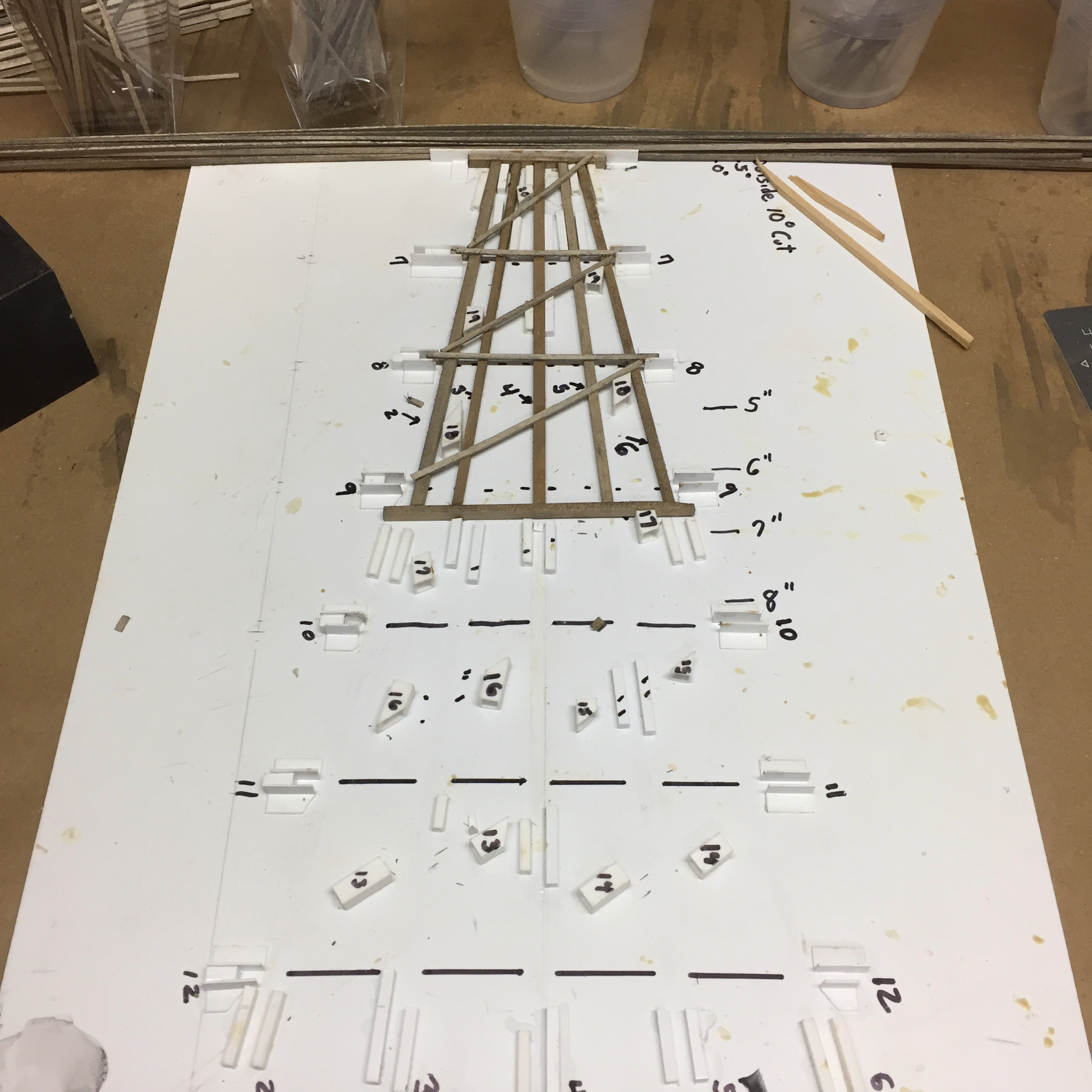

Just a quick reminder - both of these trestles are for the HOn3 line and will use smaller lumber sizes than the main line HO trestles.

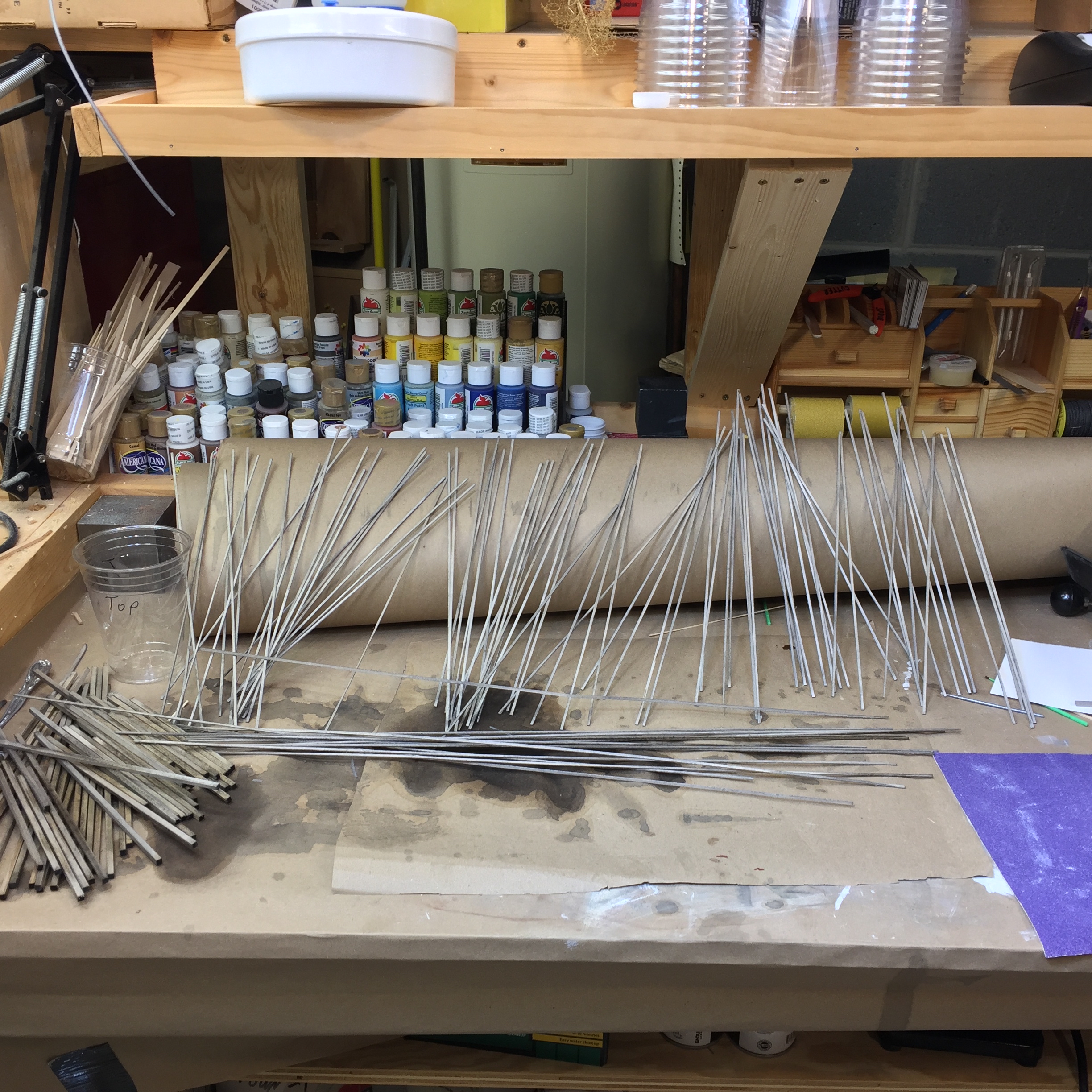

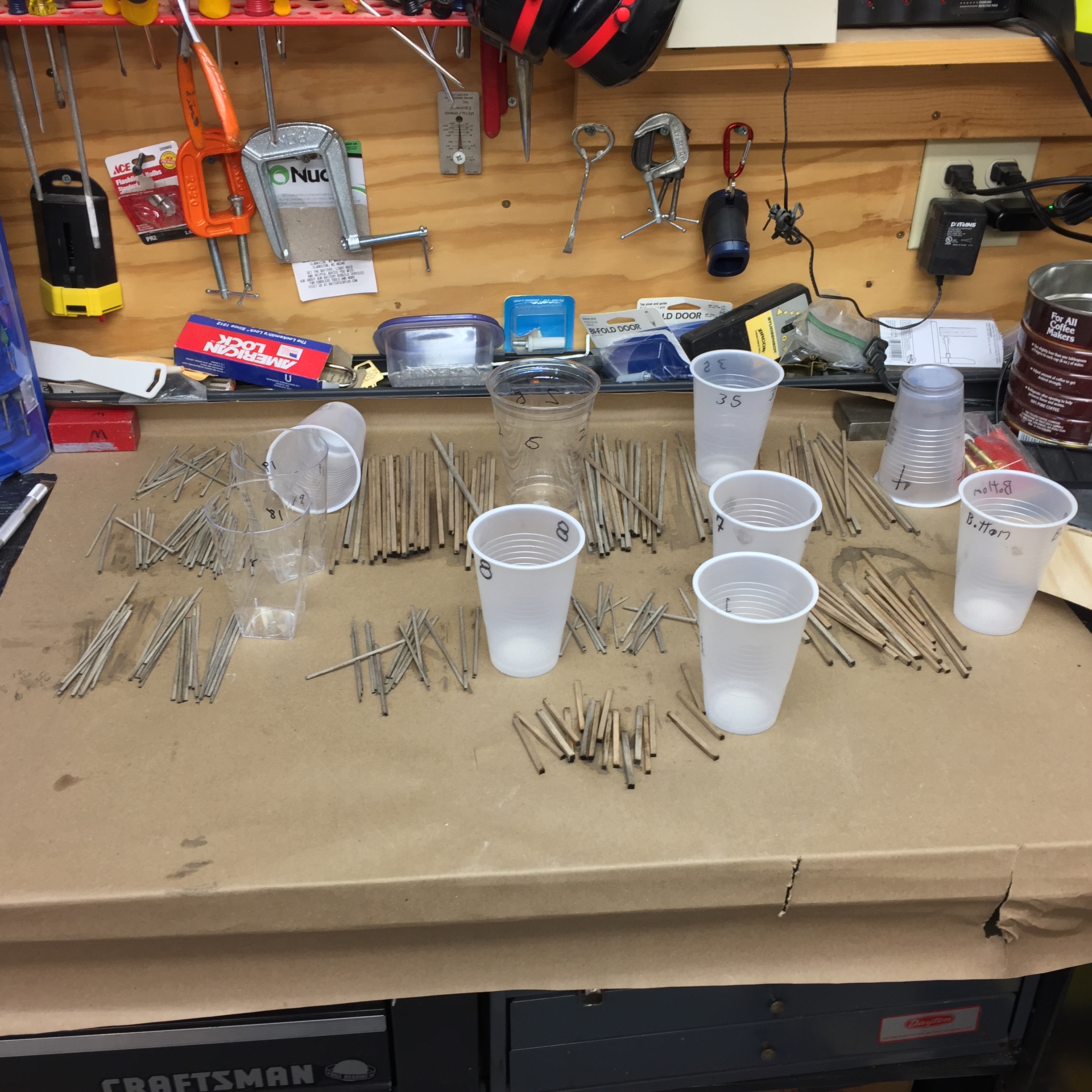

The strip wood for the two HOn3 Trestles is all cut and stained.  Let the building begin.
That was a lot of cutting.
I also started cutting some of the strip wood for my next scratch build project while I had the saw set up (not shown in the pictures).
John what kind of stain did you use on the wood?  The old A&I ??
MAP
Wow!  That's a lot of stripwood John!  The stain/paint job really looks great.

Quote from: Jerry on November 22, 2016, 08:50:37 PM
Hi Jerry
Yes, it is the old standby A&I - 4 TSP Black and 2 TSP Brown in a quart of 91% alcohol.  It's a stain not a wash but I like the color for trestles.
Quote from: MAP on November 23, 2016, 06:14:50 AM
Mark
Thanks for the kind words - I cut the 2x8's for the rafters on my next build at the same time so only about half the run was in the picture.  Thanks for stopping by the thread.

Speaking of the monster trestle, I made a test bent for the new trestles using the gluing jig that I made for my large trestle.  It is going to work just fine. ;D   I sure have made a lot of trestle bents with this fixture. I need 16 more for these two trestles.

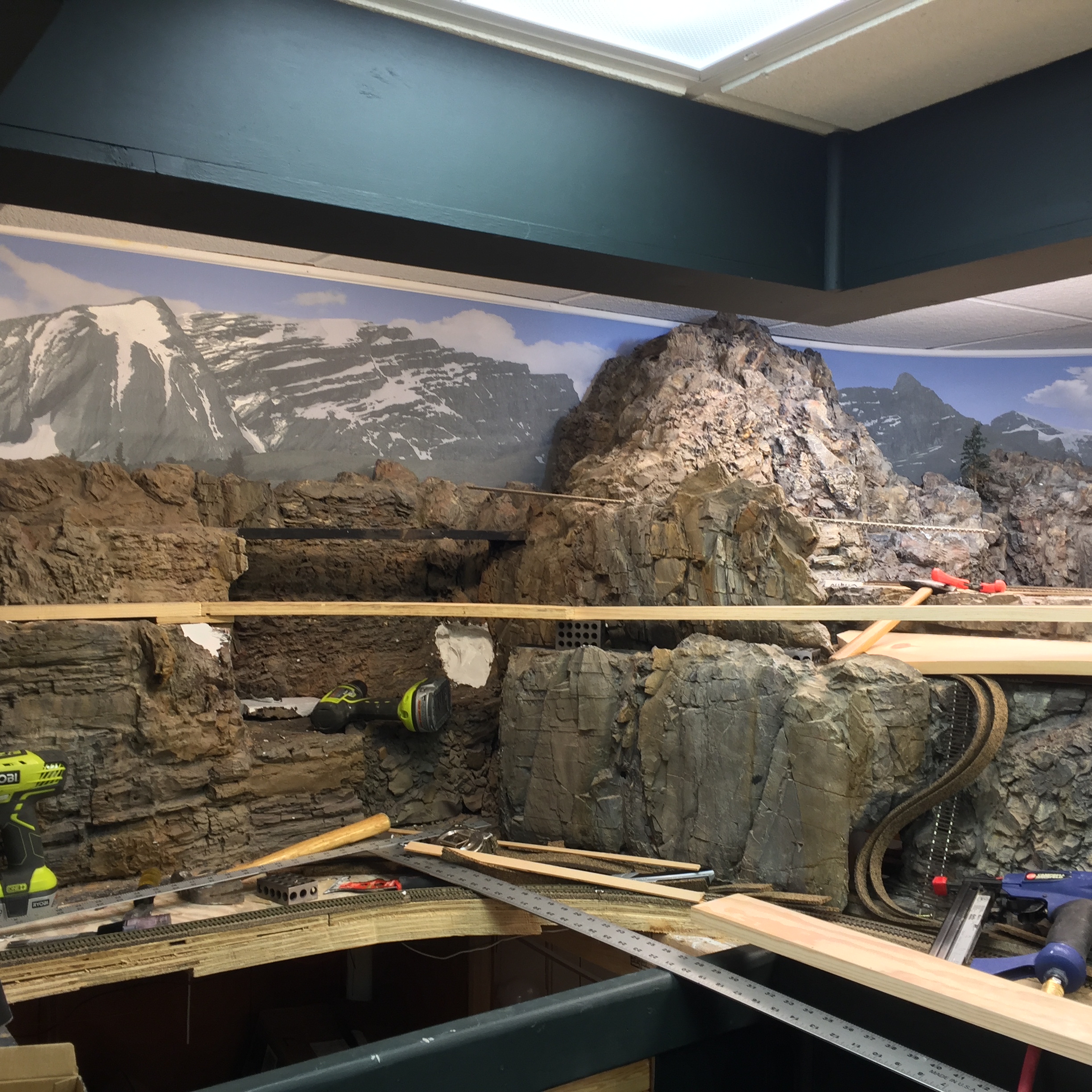

I'm making some changes to the grade on my track work project.  I had an area that did not make specifications with grade so some new benchwork and plaster work will be required. This work is sure a lot easier with a laser level and a digital clinometer.
