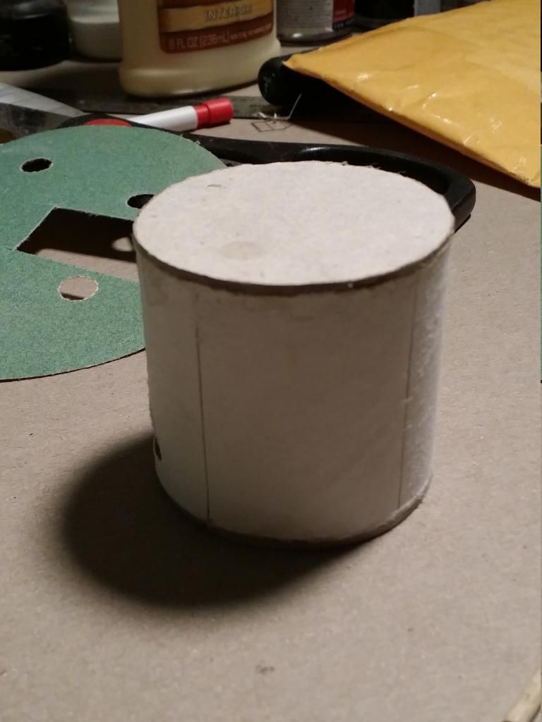

I am in need of a two water tanks so I decided to scratch build them. I found a article in MRR mag that will fit my needs. so here is the build still in process.. more pice to come over the next few days while I wait for some things to come in the mail. I always see where people are using AI washes. and in the mag its saying A and water based paint so why not give it a try.
started out with a shipping tube just about 2 1/4 wide. cut to 2 inches long.  I traced the circumference  of the tube on heavy chip board and then cut them out. Next I glued them to the tube  then trimmed the chip board up the a hobby knife.

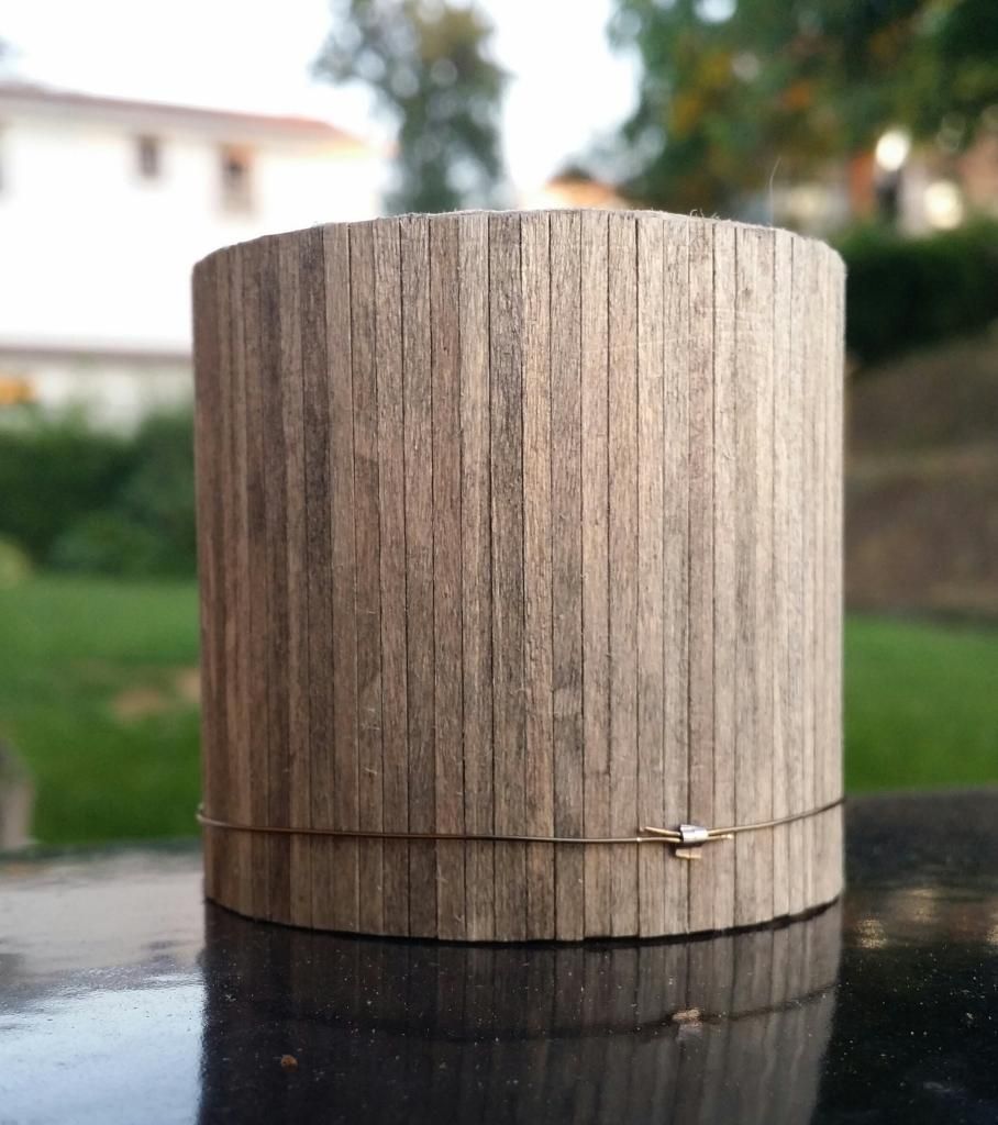

I drew a few lines on the tube with a square for some guide lines and then started gluing. I did not worry to much about if the boards was a little over the top but I wanted to keep the bottoms flush. this is after I got them all glued on.

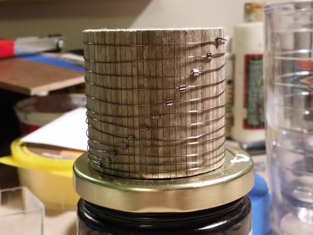

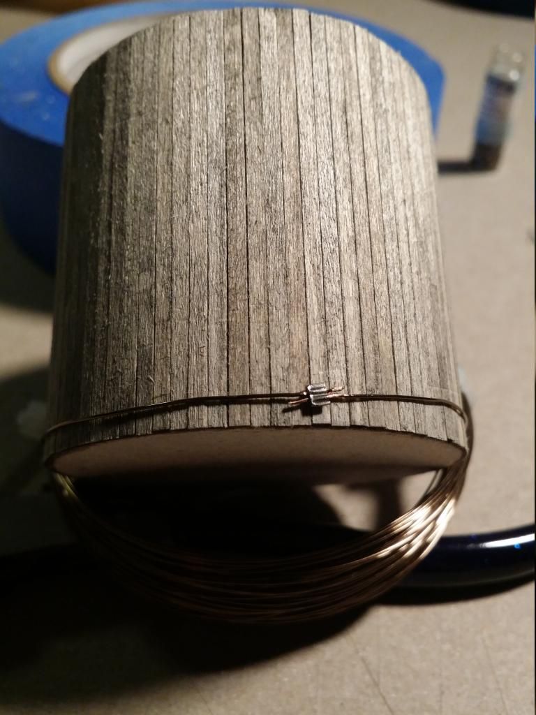

for the bands I used wire from michaels craft store and used these crimps for bracelets.. still playing around with this until I get them how I want them. will post more as I go.

I have to space the band's and paint them but I could not sleep.

just need to make the roof. bands all glued up and a shot of dull coat.
Those crimps look pretty good.  I'm surprised the pain and alcohol mixed so well.
rustyfawcett
Thanks Jeff I need changed the color on the crimps.  I am not happy with it.
engineerkyle
Hi Rusty,
I'd say the wood staining looks excellent. Realistic weathering.
EK

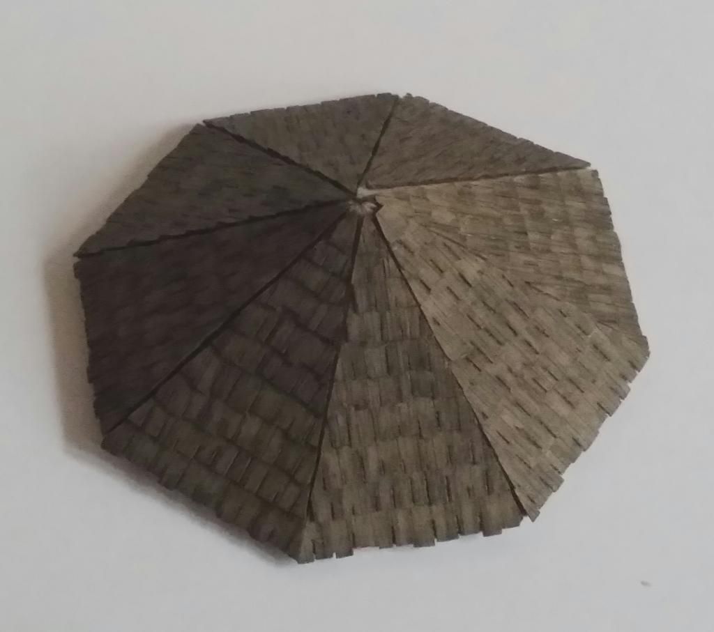

its been slow progress with work the last week+ but I did manage to stay up late last night and get the shingles on. need to cap them and add the trap to the roof.the plan is, to get more done today while it rains.
Rusty
The roof looks great.
