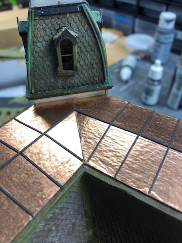

The final part of the roofing is above the dorner sides and frankly is a lot of fun. In the instructions they have you put in place the pre-cut cardboard, glue roof battens in the places scribed and when time just paint. Instead I went with a copper roof look, however by this time I had given up on attempting to get copper to oxidize to the dark brown look with some green. It just does not look right, being done in 1:1 world it looks 1:1 in size. So airbrushing was the choice I went with. (I went back and cleaned up the copper I had oxidized on the tower as well since it kept getting greener!).
First I found at Hobby Lobby thin 12 x 12 copper foil on a backing used in the Cameo printers in the craft paper area. I had the printer cut out the needed shapes. I then put the 3M 465 tape on each cardboard roof piece. The copper foil was then carefully attached to the roof. You could do this just as easy by rough cutting the foil to the roof shape and trimming away excess after foil had been attached to roof using the tape. A printer is not needed. I had already painted the roof battens Ceramcoat Charcoal Gray so I simply glued them in place using Canopy glue. The foil is so thin that the scribe lines can be seen as creases in the foil.
In the above photo you can see where gutters are needed for where the copper meets in the troughs. In a later picture you will see them. I made them from the pressed edges of brown paper bags (G Demayo's tip)and had the width of each side of the crease set to 9 HO scale inches. I cut each to shape, painted them the charcoal gray and glued in place. Another was placed as flashing up against the tower back wall.

With all copper in place it was time to weather it. I taped off the model preparing it for airbrushing. To minimize the chance of splattering I used only paint sold as made for airbrushes. I set the Iwata Neo airbrush to 22 pounds to allow for smooth flow.
First color up was Vallejo Dark Rust #71.042. All paint strokes are made from top down, starting in the air off the model (in case of a splatter coming out) then evenly down. Then repeat. Next up Vallejo Dark Rust (panzer aces) #302. Here I started off the model but at the bottom and worked my way part way up, stopping randomly. Further, I sprayed each batten, top to bottom. Next, I used Ranger Patina for all metal Jade. Lightly spray from top to bottom near the battens to give the roof a slight age look. Finally, Ranger for all Metal Onyx. I VERY SPARINGLY sprayed along the roof bottom edge and near battens. I went heaver (perhaps too heavy) near tower as this area would collect water.

Note: Gutters in place as well as flashing against tower
