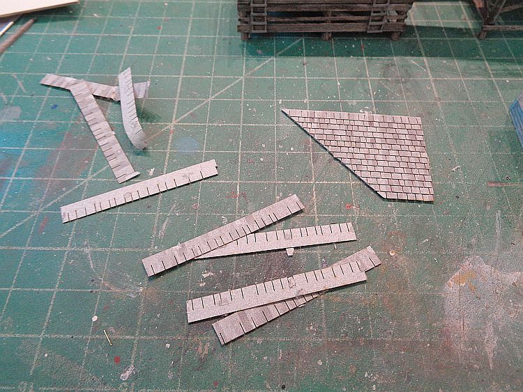

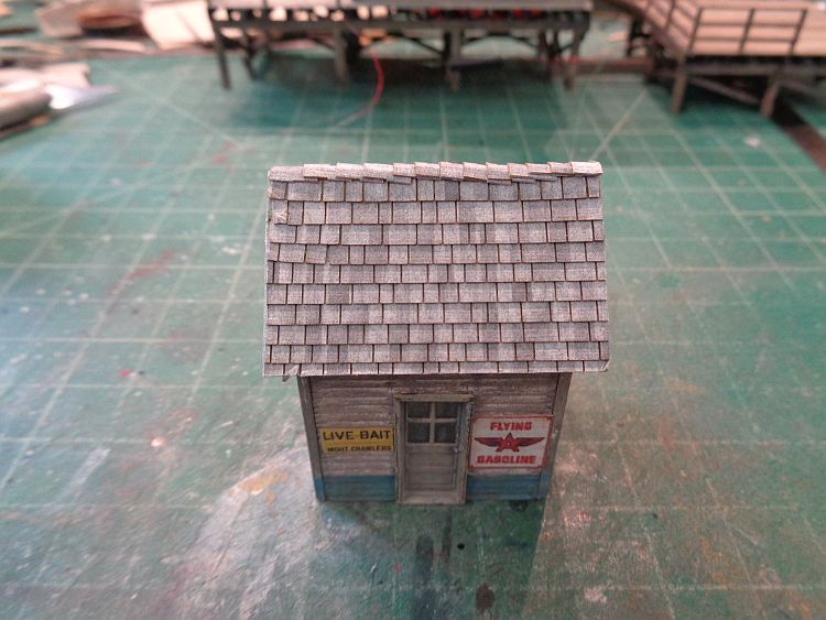

I used the same roofing shingles to add a ridge cap to the small building.
I carefully cut the rows apart using a sharp #17 Exacto blade. I then cut individual shingles from the strips and glued them in place.
The original roof panels are to thick for me so I used a very much thinner cardboard for the roofs.

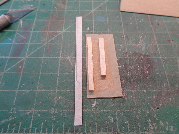

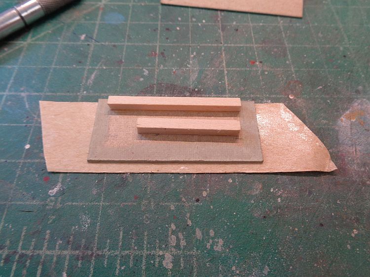

Original roof card -

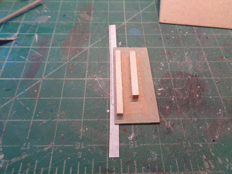

I cut two small pieces of 10X10 and braced the underside of the cardboard. I also tried something different for the flashing on the roof. I cut a thin strip of rolled roofing paper. I added a little glue to the top edge of the roof card and then glued the paper to this portion.

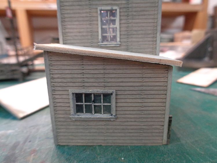

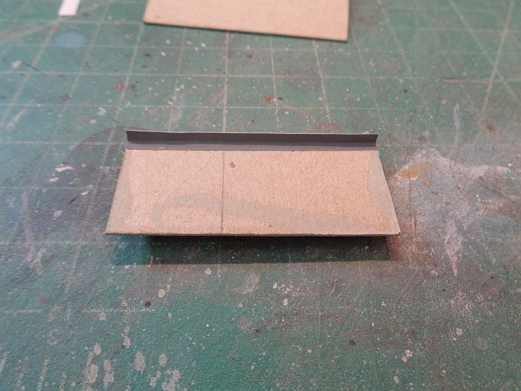

Continued -
The over hang was removed. Now you can see the colored rolled roofing flash.

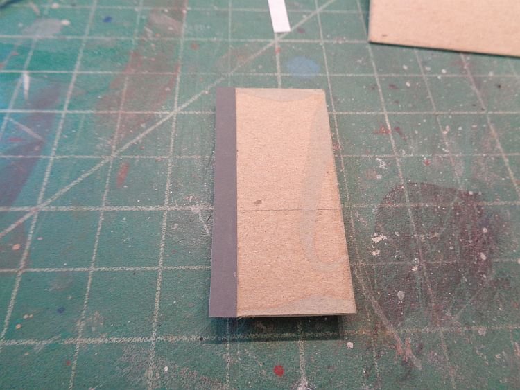

Continued -
I used the edge of the cardboard roof panel and folded the paper up at a 90 degree angle.
I used 3M transfer tape and added it to the top side of the roof.

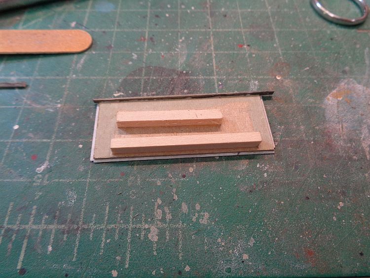

Continued -
The excess transfer tape was cut off and the rest of the rolled roofing paper was added. I also edge glued an exterior rafter to the roof panel.

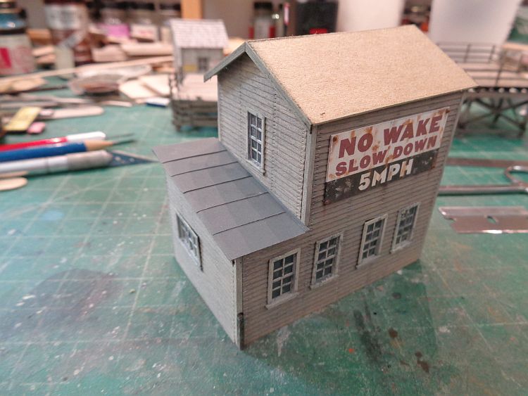

Here's a river side view.
Next is the weathering of the roofs and added details.

Outstanding build, I really like the No Wake sign.
-Steven

Looking rather spectacular Tom!
Your tile caps and tar paper flashing both worked very well.
