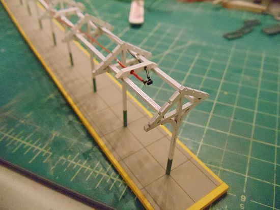

I started the lighting for the passenger sheds this afternoon. At first, I was dreading the project. Not sure why but the LED lighting in structures is new to me.
But alas, I just jumped in and started.

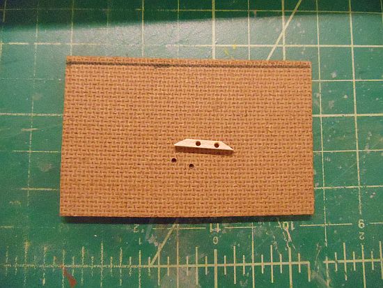

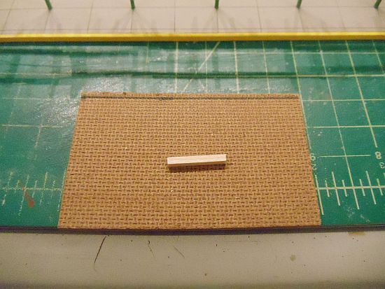

I cut several pieces of 8X8 scale strip wood just a little longer than the width of the "rat runners".

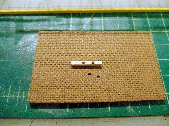

I then drilled two holes close to the center.
I then cut at an angle on each end. This is so there is no interference with the underside of the roof.

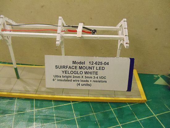

I didn't have enough of the LEDs I got from Slim so I chose to use the Miniatronics surface mount LEDs.
You can also see how I glued the short pieces of 8X8's across the rat runners. Notice the misspelled SURFACE on the card. Maybe Miniatronics should teach the Chinese how to spell.
Note also here that by drilling two holes in the block, the red (+) and the black (-) wires are kept separated.
These surface mounts are bright, even though it states they are yellow glow. I dummy downed the LEDs by painting black paint across the surface and just left a tiny amount of surface to show the light.

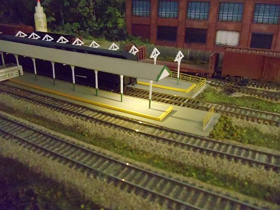

Here is how the one light looks with half of my layout lighting off.

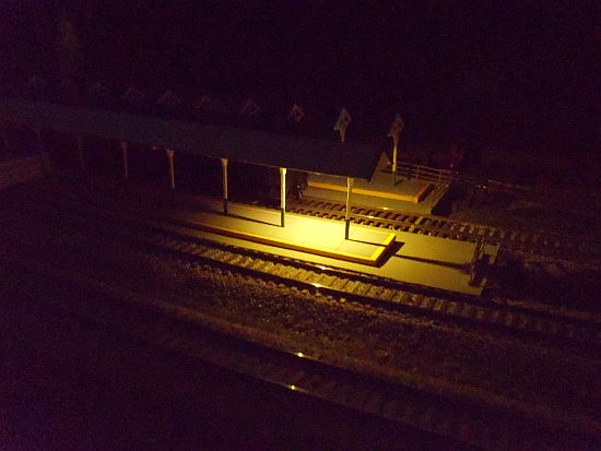

And with all the lights off.
I'll install four more LEDs on the shed.
