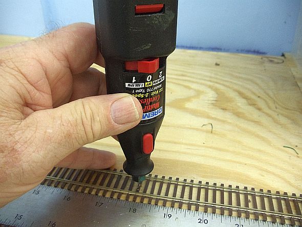

Using a small dremel tool and either a # 78, 79 or 80 drill bit, I drilled a hole in the center of the track tie.
I use the Micro Engineering track spikes. I say spikes here when in reality they are very small and sharp track nails. ME sells a long and medium length, I've used both on the staging with no issues.
I mount the drill bit in the Dremel a little shorter than the short nail but long enough to drill through the ME track tie as well. This way when the hole is drilled you have a pilot hole for the nail in the tie and plywood and room to secure it into the plywood. I've enlarged the next photo to show the nail so it appears much larger than it actually is.

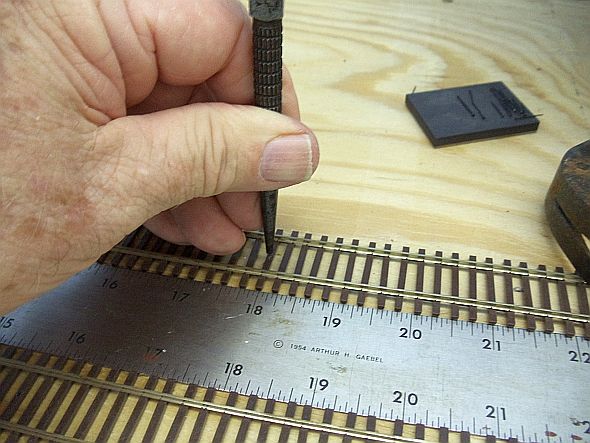

I then use a 3/32 nail punch and a small hammer to "drive" home the spike/nail. I tap it so that it is secure to the tie. This 3/32 nail punch has a round head and the nail head fits into it perfectly so it doesn't move when hammered.
NOTE: Do not "hammer" the spike/nail to hard as it will bend the tie and pull the track out of gauge.
