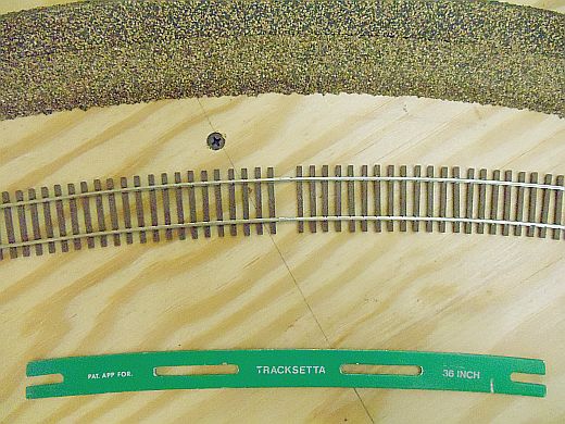

This is probably a no brainer for most but it's been on my mind now for several years to mention.
When I see pictures of layouts, one of the things I look at is the trackwork. Specifically with curved trackwork. The trackwork needs to be smooth in the curves. If you are using flex track or hand laying track the solution is the same.
However, let me mention the problem first. Say you are using a three foot section of track or rail and you come up short in the curve or your 38" radius. A great majority of people just slip on a rail joiner, solder it to another piece of straight rail or track and spike it down continuing the curve. The problem here is that you create a very small/short section of straight rail in the curve. It's not that noticeable to the eye but trust me you rolling stock trucks will notice it.
The solution is simple but requires a little more patience in the track laying department.
Prior to bending/making the curve I want/need, I solder two straight sections of track together.
When the track is then bent/curved to your radius, you have a much smoother curve and your train will appreciate the effort.
In the past I've found it necessary to solder three sections together prior to laying the track on the curve. The bending of flextrack in 9 foot sections is very difficult but then again you get what you pay for.
Each of the curved track in the photo below has two 3' sections soldered together prior to spiking them to the cork roadbed.
Hope this helps someone.

Great tip Tom - I would add that you want to be careful how far you go with soldiered sections of track.  You need expansion and contraction joints because it is very easy to get a expansion buckle in the track that can spoil that beautiful continuous curve. If you are modeling mountains - like some of us crazy people - the buckles always show up in the tunnels where you can't see them.
LongHornCaddy
Quote from: S&S RR on June 14, 2015, 08:34:41 PM
Thanks for adding to ther post. I should mention that I leave several places around the layout track work where the rail joints aren't soldered. To help with the track staying in line yet letting it expand/contract with the weather, I use Atlas "N" scale code 80 rail joiners. They are much smaller and fit tighter than the HO rail joiners.
