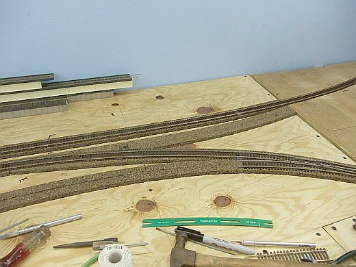

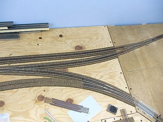

Another area of the current track plan I changed is in and on the south reverse loop. For some unknown reason I installed two turnouts with a short section of 3.5 ft. of track between the two.  All that did was to shorten the one leg of the reverse loop. Here is a photo of that area. For those of you living in the Central Fl. area, I'm referring to the track in the middle. ;D ;D ;D ;D
You can see how short the section is between the turnouts. It was a waste of two turnouts, two Tortoise motors and wiring time.
This is just another angle of the area.

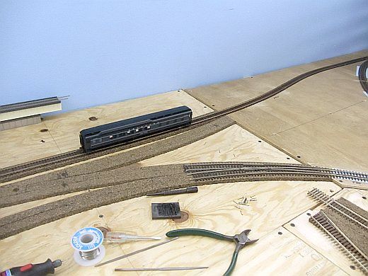

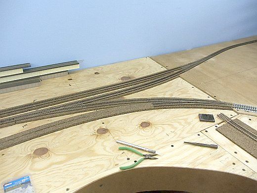

The turnout in the above photo was removed along with the short section of track. A new section of track was installed.
The lower section of track was removed along with the middle turnout. A new section of track was added. I'll leave the cork roadbed and add ties without rail in the old section.

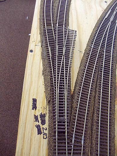

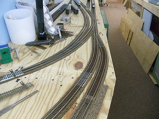

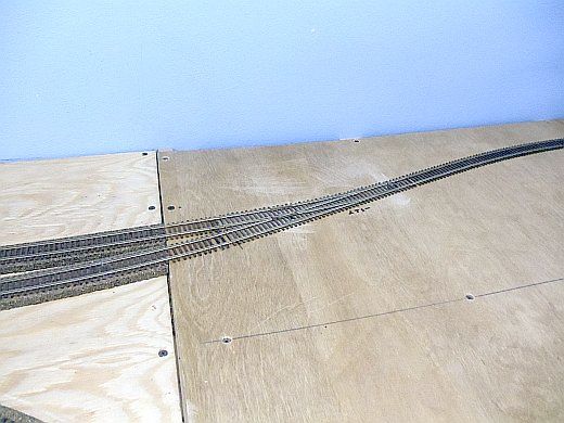

Here is another unsightly area of track work I'm changing. This has worked fine and I've had no derailments here. After several months of looking at this section, I've decided it needs to be a bit smoother looking.
I used a lefthand turnout here. The above photo is looking South. The next photo is looking North.
A righthand turnout is more appropriate and will look much smoother.

Great looking track. When I first looked at the change above, I thought you were going to install a 3 way switch and then once I put my glasses on I saw that you had a right hand switch laying on top of the left hand. Then I said to myself - A three way would look marvelous there. Just my humble opinion.
Frank / Erieman
Looking very nice, Tom.
I must admit - I looked at your picture and thought 'there's a track missing there' and then realised it was an overlay!  Very nice work!
Quote from: Erieman on November 10, 2015, 10:35:44 PM
Frank / Erieman
Frank,
Thanks for the kind words on the track. I did consider the 3 way switch but didn't think the location was the best. I didn't like the lefthand turnout as it took the track to close to the edge of the bench work. Besides that, the area under the turnout has two 1X4 braces and not enough room for the two Tortroise motors required. I'll have photo of this new area on Friday.
