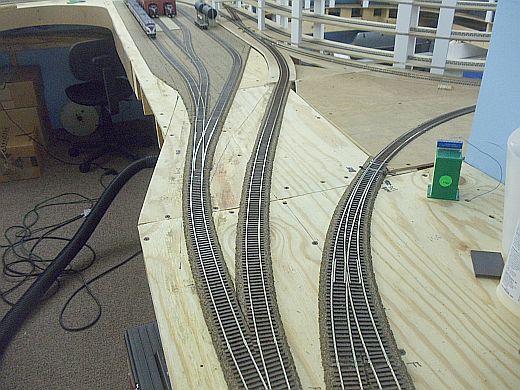

I appreciate your kind remarks. The picture is a bit confusing when I look at it now. I'm running trains in this area and will have photos up probably Friday evening.

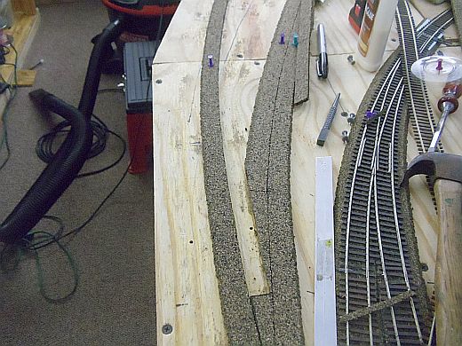

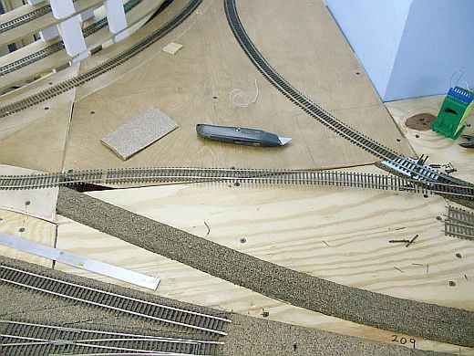

You can see that I just moved the flex track out of the way.

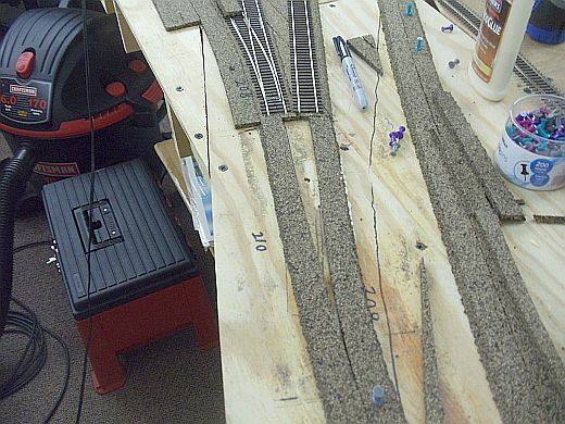

I then removed old cork roadbed  and the rest of the track from the area.
I glued new cork roadbed for the new track.
I removed the left hand turnout and replaced it with a right hand turnout.

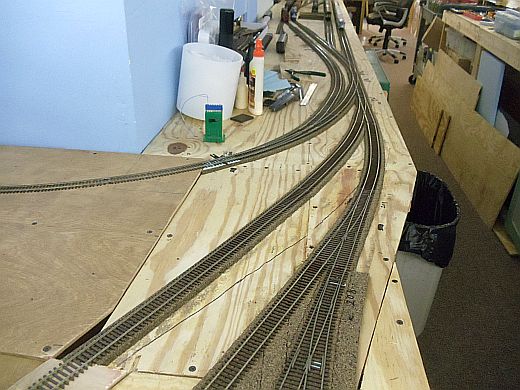

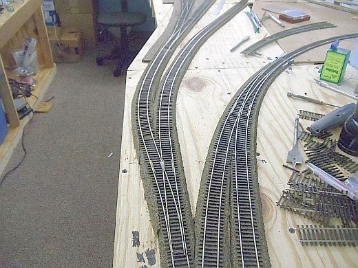

Here is the new mainline. You can see the black line in the middle, this was the old mainline angle.
Here is another view of the new mainline - looking South.
New mainline looking North.
I also finished the tracks in the small lubritorium.

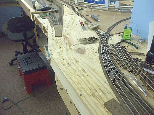

And now, here is the before photo.
And the after photo of the new mainline.
Much smoother and better mainline trackage.

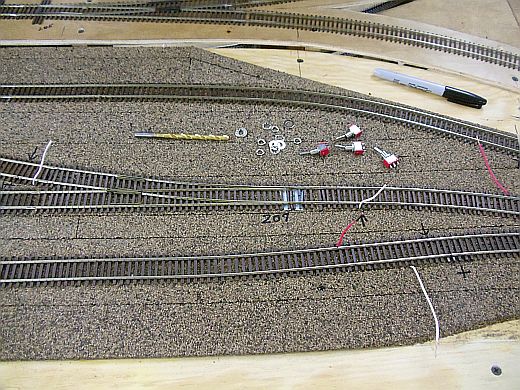

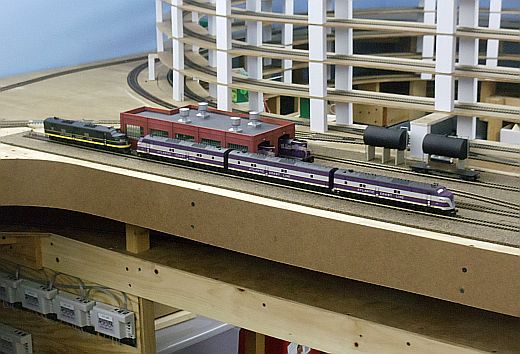

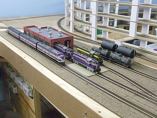

Over the past few days I've been doing little things that take time but are necessary. Yesterday I drilled holes and inserted the wires for the small lubritorium.

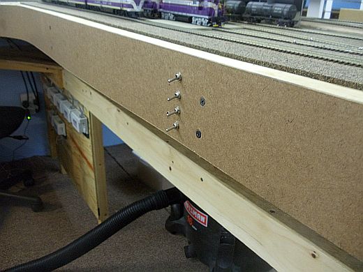

Since this area will also be used for small diesel storage, I needed to have the four tracks wired  and be on on/off toggles. This way I can turn off the tracks and thus the diesel noise. Several diesels at idle are quit noisy. Fast forward and the toggles are installed and wired. I still need to paint the fascia.

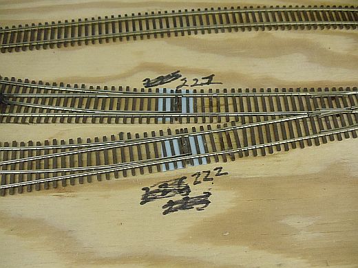

You may have noticed in earlier photos the light blue paper under the track and turnouts. I used the paper to shim the track where only a minuscule of adjustment is needed.

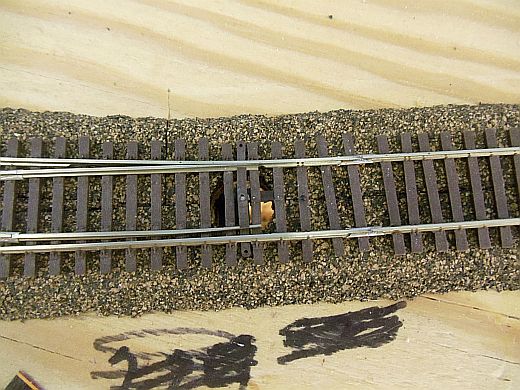

For the turnouts, the paper is used for an entirely different reason. When I drilled the holes in the plywood for the Tortoise turnout linkage, I made them large enough so I had room for adjustments. After the turnouts were installed you could see the hole.
When the track is ballasted, the hole will be more obvious in the area of the throw bar. I used the light blue paper to fill in these areas. The paper slips under the track and will be secured with the ballast glue. The paper is so thin it doesn't affect the height of the turnouts.
