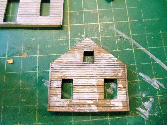

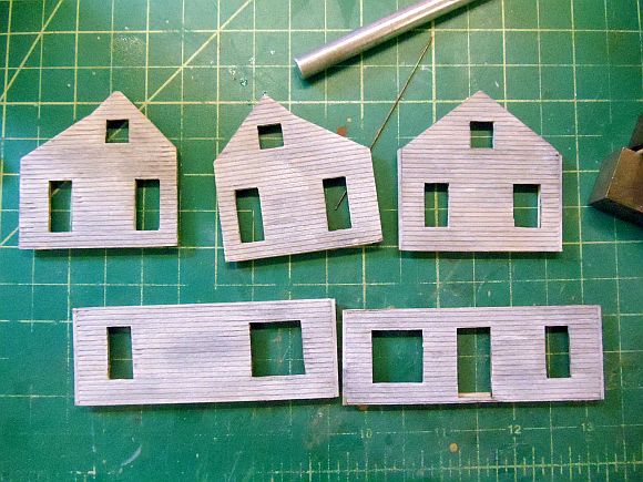

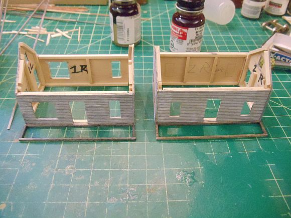

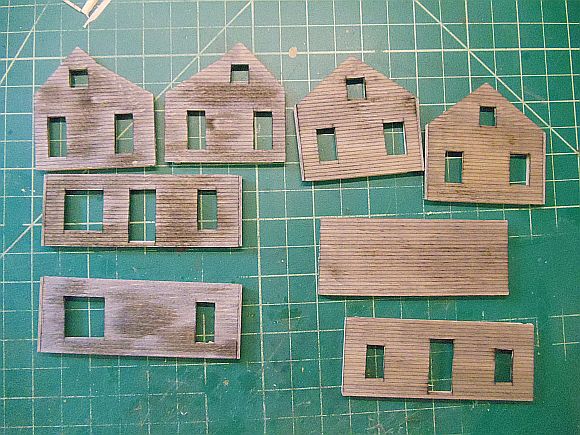

Once I had the two coats of Hunterline Creosote Black A&I stain on the walls, I set themn aside to dry overnight.
I used Floquil Reefer White and dabbed the paint on the walls. I then dipped the brush into some clean thinner and blended the white paint into the walls.
The two house will not be foreground structures so I didn't add any nail holes. I will add one final light coat of Hunterline Light Gray A&I to the walls when the finished.

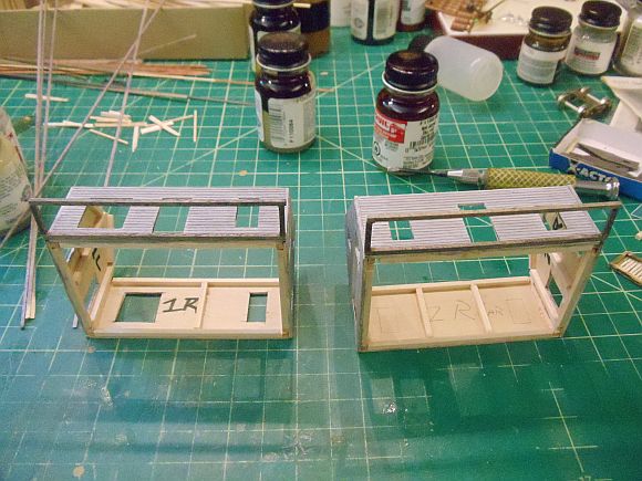

I made two porch frames out of scale 4x4's and added them to the front of the houses.  I made them the width of the house and came out from the house five HO scale feet.
The two porch frames were glued directly to the front of the houses just below the door opening.

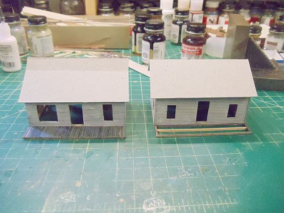

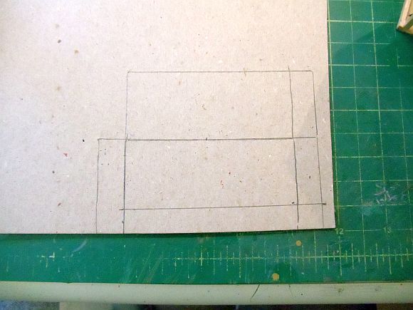

The roof decking was cut from plain cardboard. I cut each house roof decks to fit the particular house.
In the next photo you can also see the proch decking already in place. I forgot to take a photo of the porch being constructed. I stained scale 2X6's and glued them in place on the porch. The roof was added next.

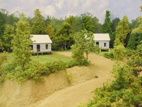

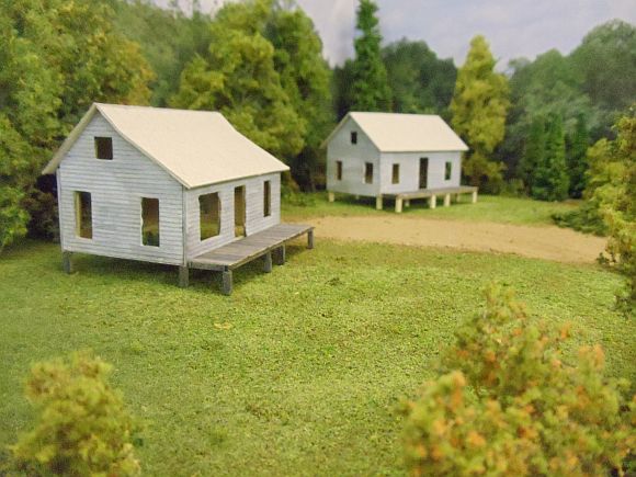

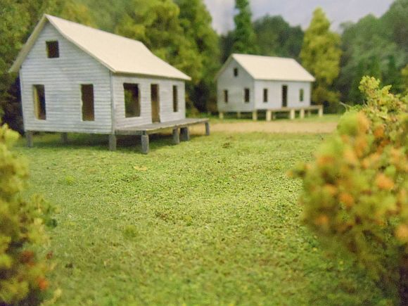

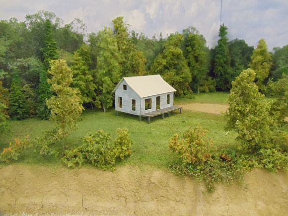

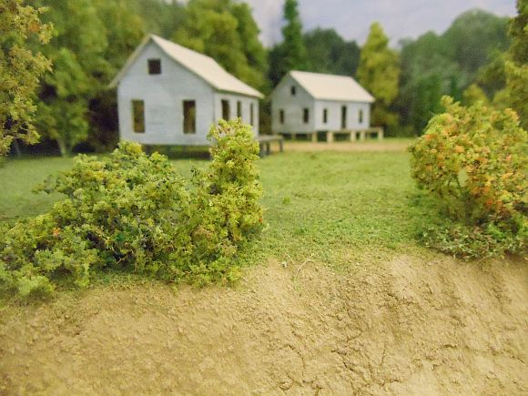

Here is a quick little pictorial of the two Cracker Houses.
After the houses are finished, I'll need to finish the scenery around the houses. Just imagine all the junk I can put in the yards, old cars/trucks and all the other "yard art" these folks display. :-[ :-[
