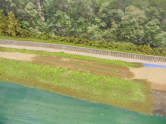

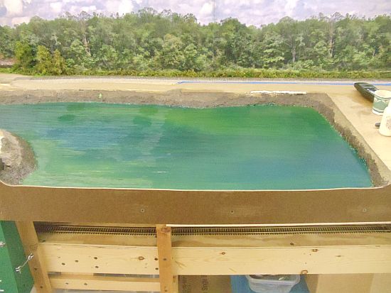

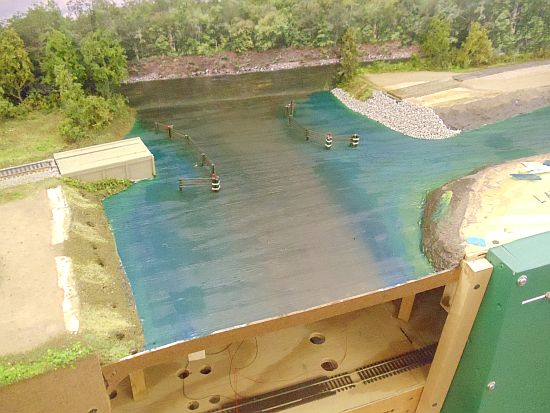

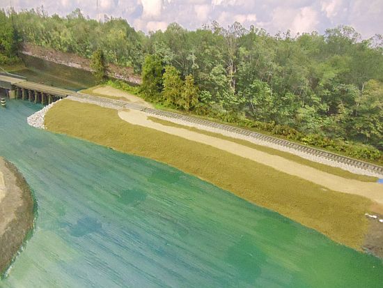

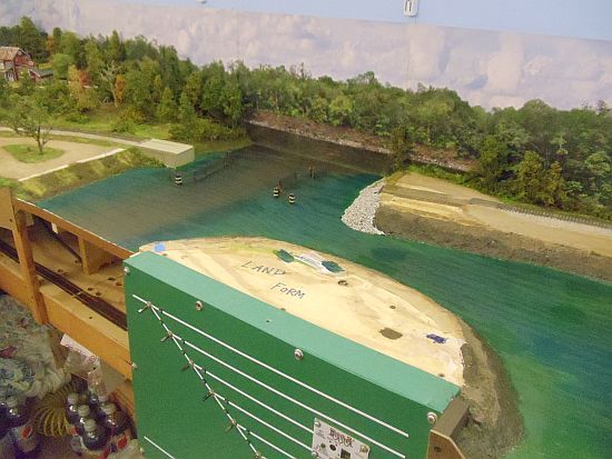

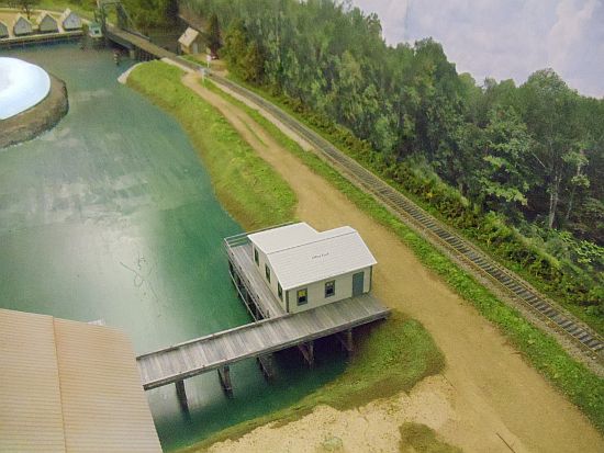

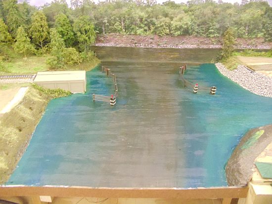

Here are some pictures of the Suwannee River Basin area. The river bed is painted and ready for resin water. First though, I have several other things to finish here prior to the water being poured.

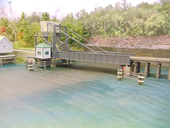

I next got the bascule bridge ready to be installed permanently.

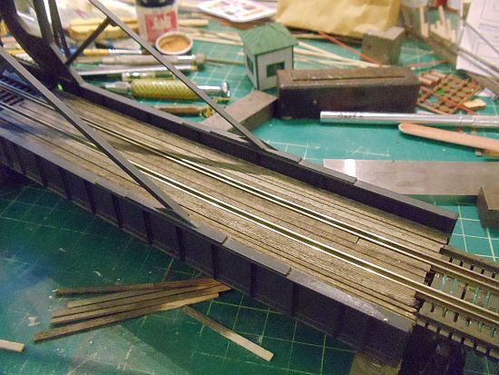

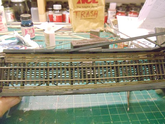

Here is how it looked prior to me adding additional bridge planking.
I removed some of the old planks and added the extras. I used scale 2X10's, stained them with Hunterline A&I and glued them to the bridge deck.

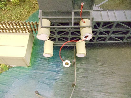

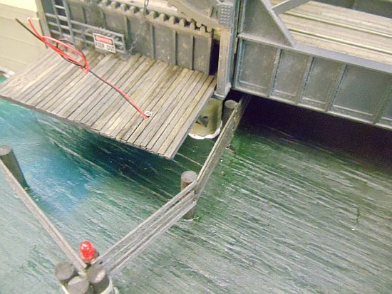

I plan on having the bridge pilot house lighted so I needed to get the wires in place.
I drilled a hole in the side of the piling and into the bottom. The light wires were strung through the holes.

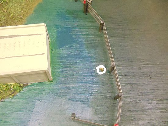

I then drilled a corresponding hole in the river bed and added a ring of glue.
I then pushed the wires through the river bed.

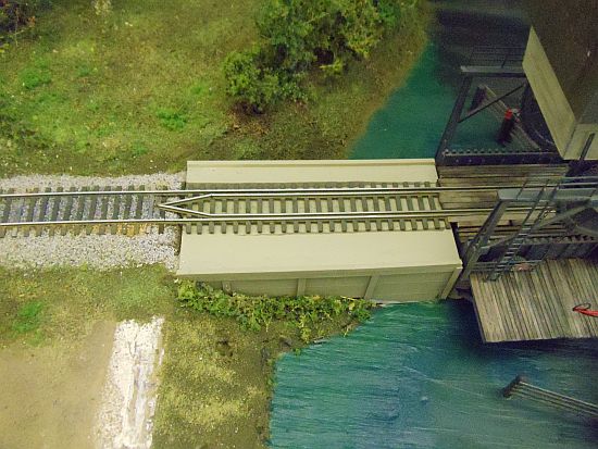

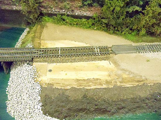

The bascule bridge was repositioned on the river bed.
I used a Micro-Mark weight to hold it in place until the glue dried.

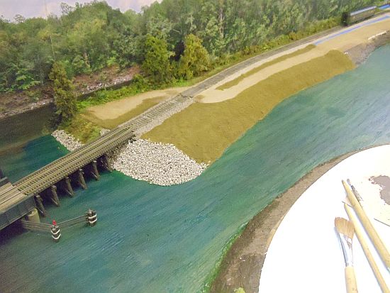

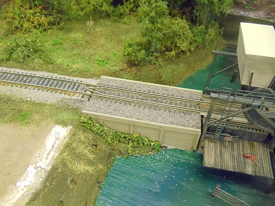

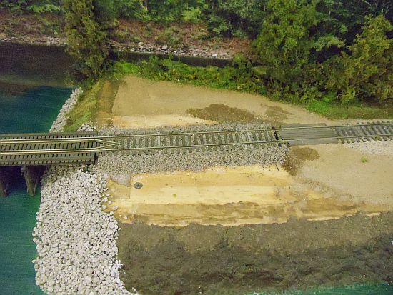

I then aligned the track to the existing track and tacked in place.
I then added the new ballast.
I then started adding scenery to the river back.

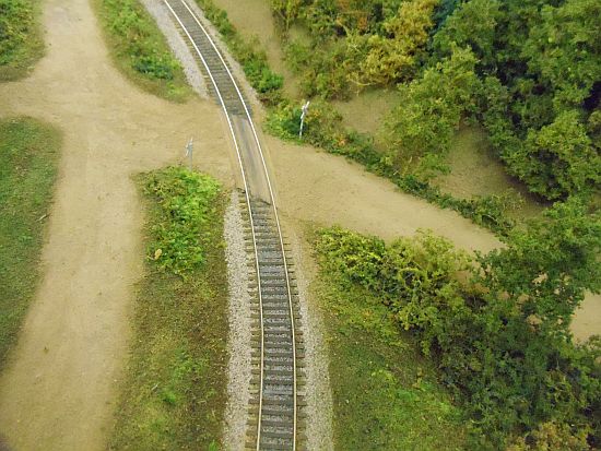

Added some weeds in the dirt road as well.

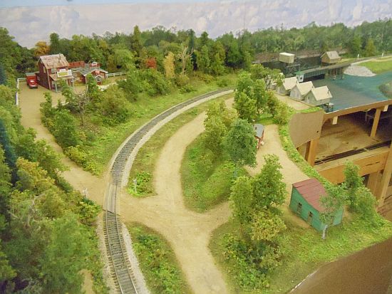

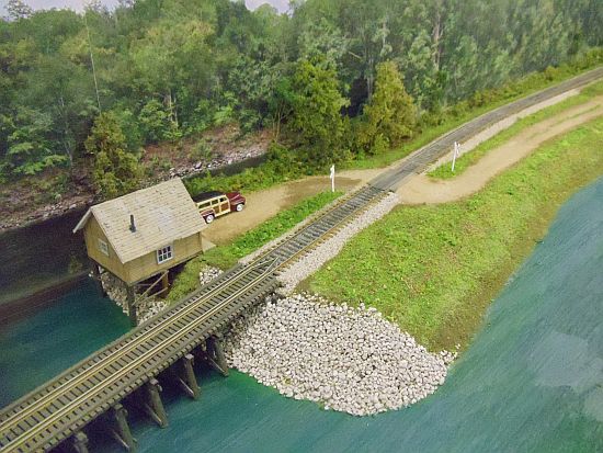

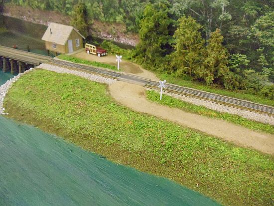

I added more scenery to the Suwannee River Basin Curve area.

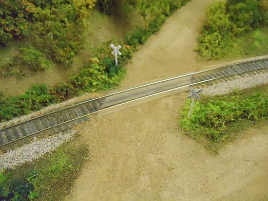

RR planks across the tracks. Well, actually between the tracks.

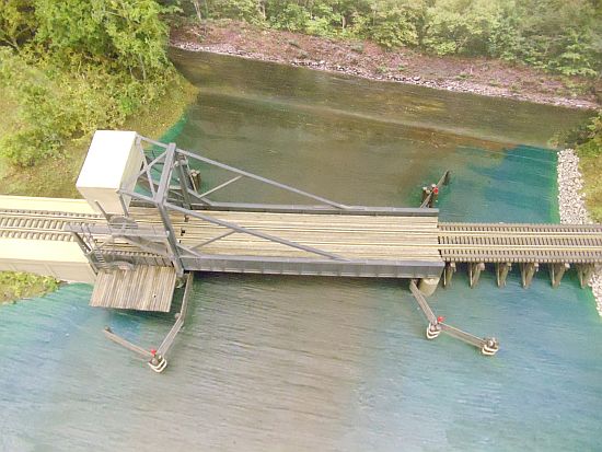

Now is as good a place to add in the video of the bacsule bridge and blinking markers.
The video was done prior to me adding the channel barriers and dolphins.

Nice work Tom! The crossing came out nice with tjose boards. When do you plan on pouring "water"?
