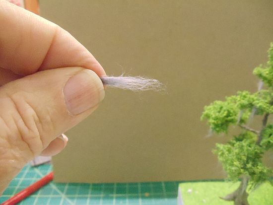

I pulled some cotton off the Q-tip and kept pulling until I had a little wisp of cotton.
I used tweezers to hang the moss on the bottom of the branches.
I can't say I'm happy with the results and it took about 90 minutes per tree. I did two trees and won't be doing any more.

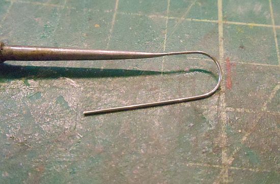

I decided to add billboard lights using micro LEDs. I uised Ngineering parts for the lights. These are available from Slim at www.microlumina.com.
I used my Xacto knife to bend the .018 OD tubing.
I used a small pair of nippers to cut the tubing to the desired length.
I reamed out the tube where I cut it. I didn't want any metal burrs to short the wires.
I then punched a hole in the lamp shade.
I super glued the shade on the end of the tubing as shown.
