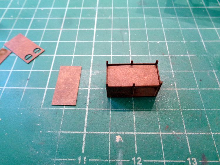

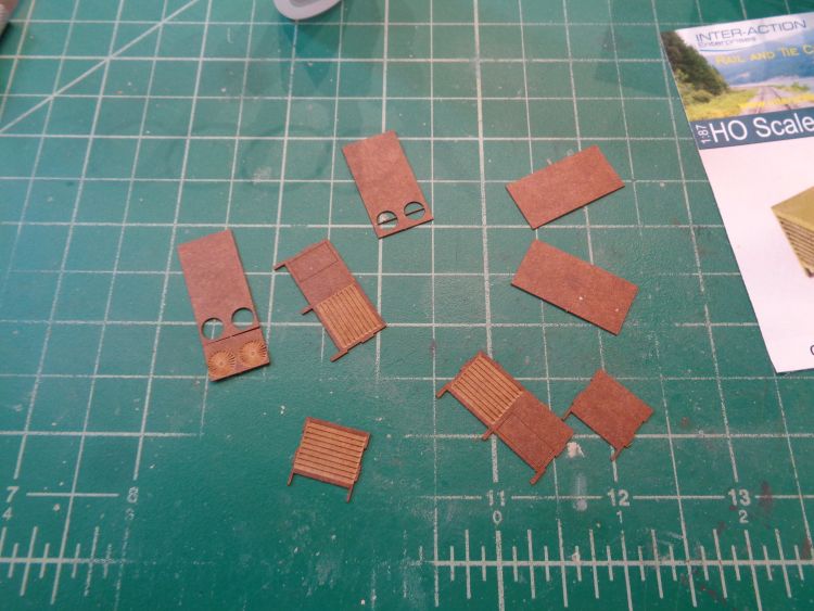

I used a single edge razor blade and cut the A/C pieces from the carrier sheet.
I then used an Emory board and carefully removed the small kerf tap where the sections were attached to the carrier.
I then glued the pieces together using Elmer's wood glue. When the glue on the main unit was dry I glued on the bottom piece. This piece fits nicely between the four sides. That is provided you get the unit square.
Continued -

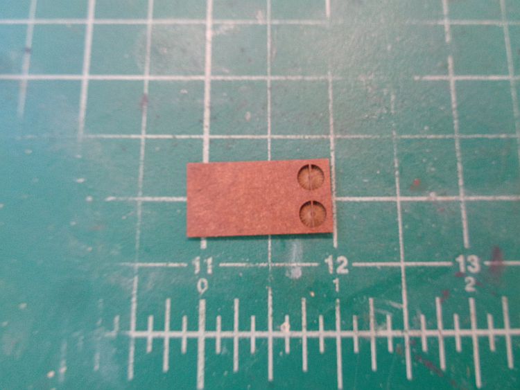

The top of the A/C unit has three pieces. There is a bottom piece, which has the fans laser cut on the board, a middle piece and the top piece.
I glued the small fan piece to the bottom side of the middle piece. This section/piece has two holes on one end. Make sure the fans are centered under the  middle and under the two holes.

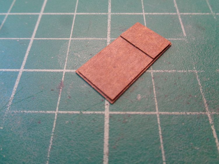

The top piece has two holes and two thin bars across the holes.
The next photo shows the three pieces glued together.
The top piece is slightly larger than the middle one. If you center the middle piece under the top piece, the pieces will look as they do in the next photo.
Notice the difference in the pieces?

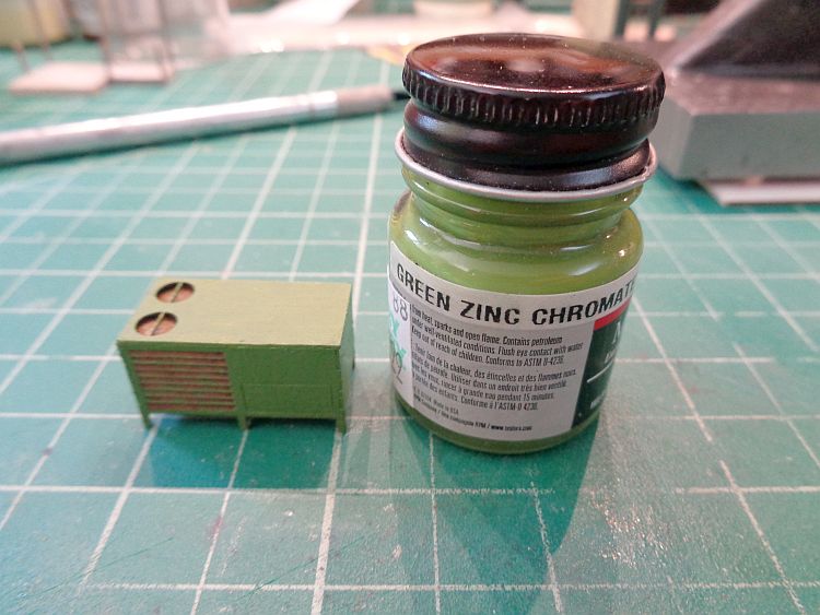

I used Model master Green Zinc Chromate to paint the unit.
I'll add weathering when the paint has cured.

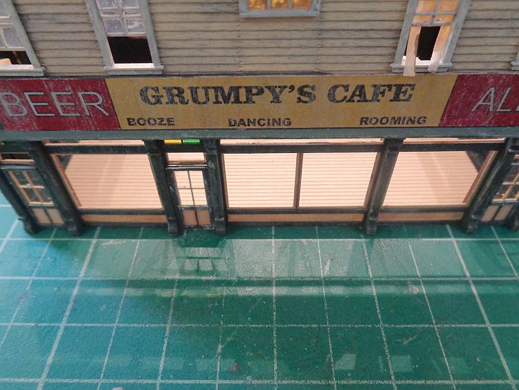

I installed the windows and Grumpy's Cafe sign.
The roof is yet to be glued in place.

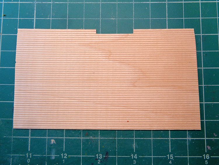

Old buildings that had multiple stores on the bottom had wood floors. So, I'll add a wood floor to the three stores.
I cut a piece of Northeastern Scale Lumber 1/16" X1/32" scribed siding for the floor.
Now to build partition walls and side walls.
