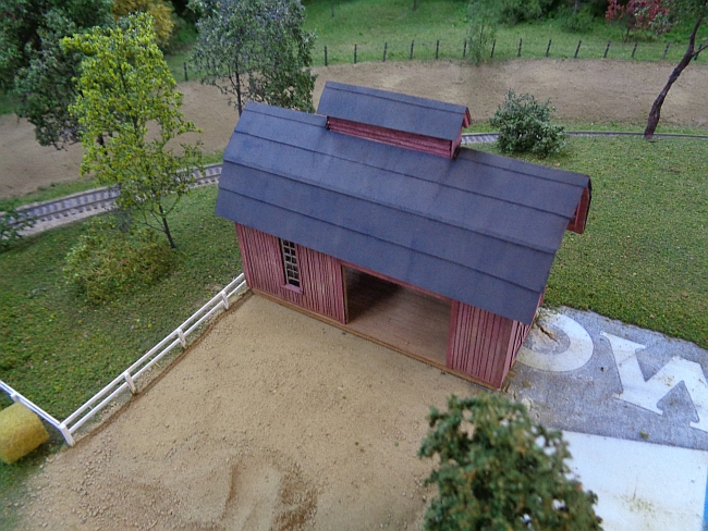

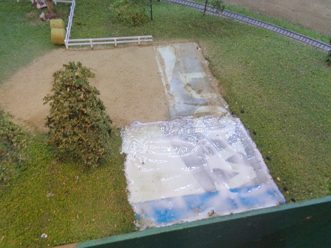

Since I finished the Perkins' Farm barn, I wanted to update the scenery in this area. I think this area scenery wise is about 8-9 years old.

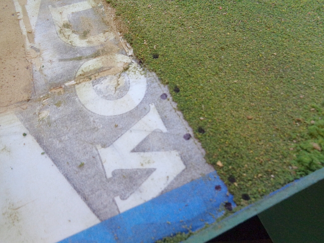

This is where the4 barn is located. The two black dots to the right shows where the west barn doors are located.

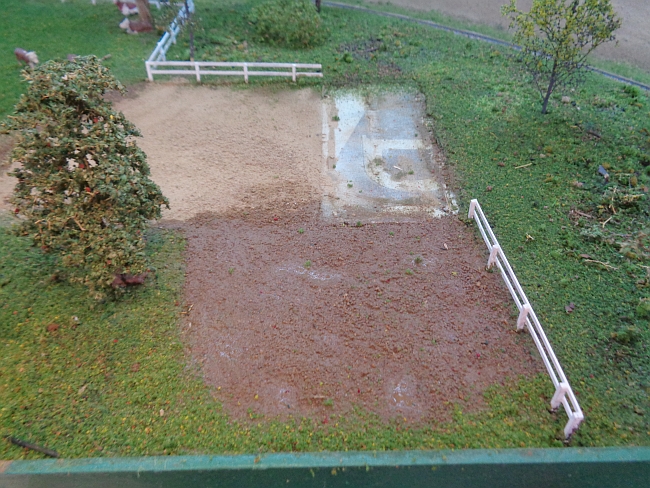

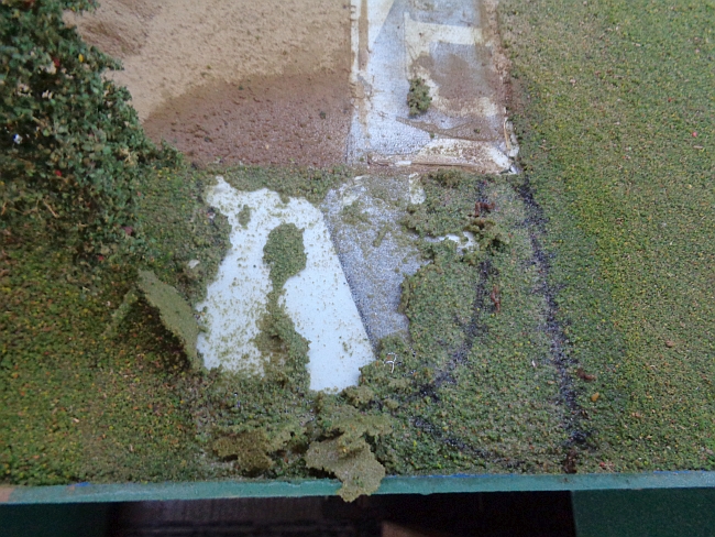

I wet this area with warm water and let it sit for about 30 minutes. That gives it long enough for the glue to soften.
I then used a putty knife and removed the old glued scenery.
Scenery removed and area dried. The black dots show the new location of the fence.
This white fence in this photo is the one that will be placed where the black dots were shown.

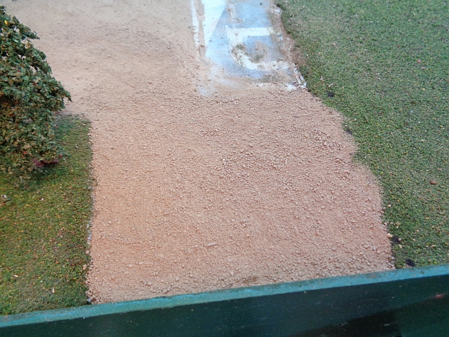

I spread white glue to the new farm yard area.
I'll shovel this pile of dirt to the glue area.
The pasture is next. I'm done for today.

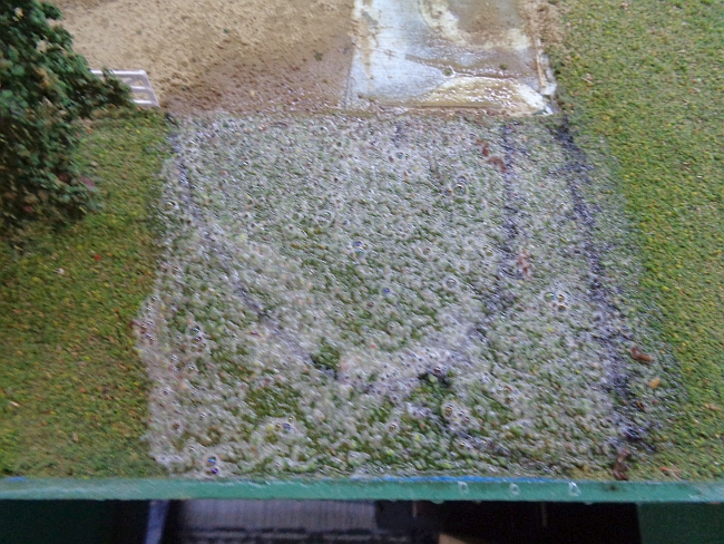

Once I got the loose dirt shoveled over to the west side of the barn, I secured it with matte medium.
I sprayed the matte medium on the dirt with a light spray/mist so I didn't move any of the top layer of dirt.

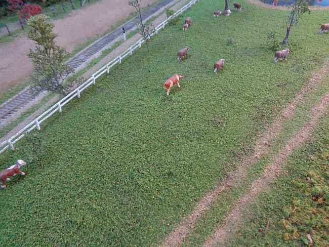

I also added some grass and weeds next to the fascia and installed the fence.

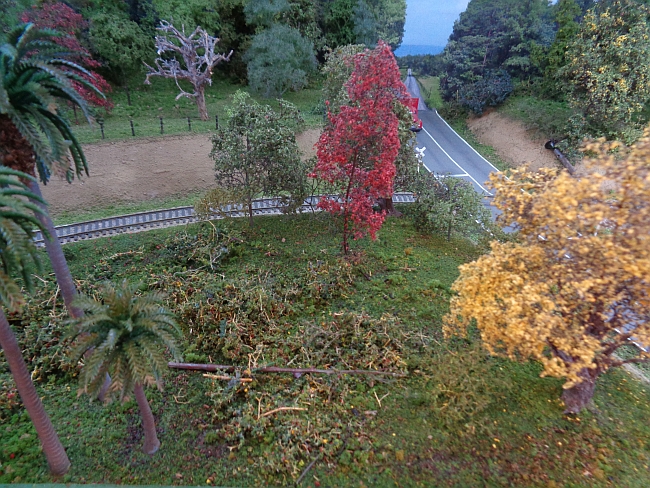

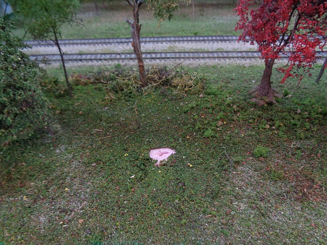

While that area was drying, I added some additional trees and piled wild bushes to the area just north of the barn and pasture.

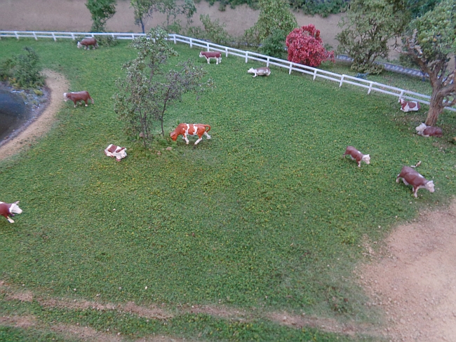

I then moved on to the cow pasture and updated the greenery.

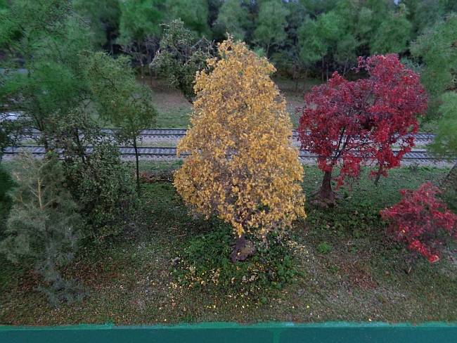

While replacing the plexiglass, I broke on of the trees in the Piney Woods area. The tree was unrepairable so I added one from my tree farm.
This is a custom tree for the Atlantic and Southern RR made by Kris Cutler. She made several kit bashed trees and gifted me the others from the Pennsy, Six Miles West of Altoona layout. It is now a Fallen Flag Layout.
