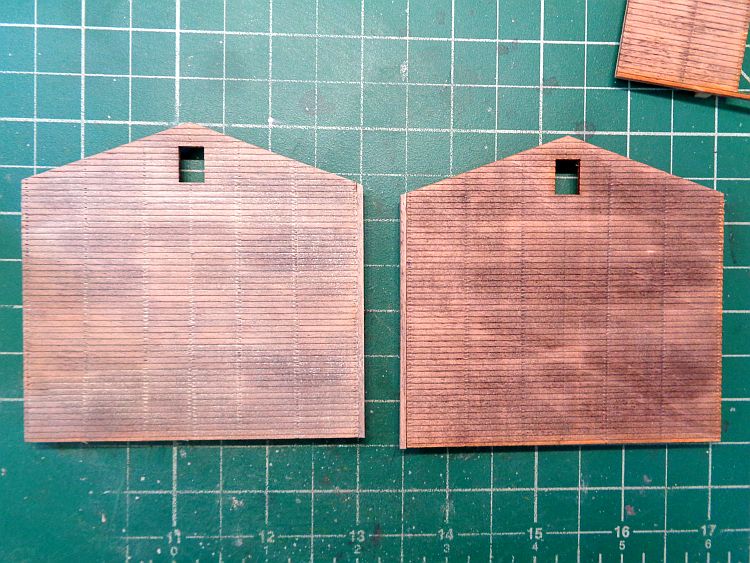

A couple comments on staining.  (1) different pieces of wood, or even different parts of the same tree, will take stain differently.  You can usually darken by adding more stain to the lighter sections.  (2) I like spray shellac to seal before applying stain.  That helps get a more even coat and reduces warping.  (3) I also learned the hard way that it's best to stain the full 'slabs' of wood, before adding bracing or cutting out openings, and let those slabs dry thoroughly under weights (flat surface bricks, $.69 each at Home Depot, make great weights.  Put wax paper between the wood and brick, though.)

I'm not looking to darken the wood but rather have it much lighter. I didn't want the darker pieces. Hopefully, I can make the adjustment to even it out after painting.
I've learned the hard way to brace and then stain. I've stained first in the past and then braced. Even though I've added weights until dry, I didn't feel it was better. I guess it's just personal preference here.
Tom  ;D
I've tried it both ways.  What's happened to me several times is that the bleeping bracing warped along with the wood panel.  Maybe that means my bracing wasn't sturdy enough.  But on my recent Laird Stone flat project, I wanted to keep the structure relatively shallow, so 1/4" bracing was right out.  (The first attempt, bracing then staining, warped badly.  I ended up tossing that piece out, but also because I mis-cut the doors on it.)  On the reworked piece, "stain then brace" worked much better.

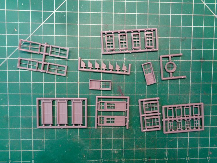

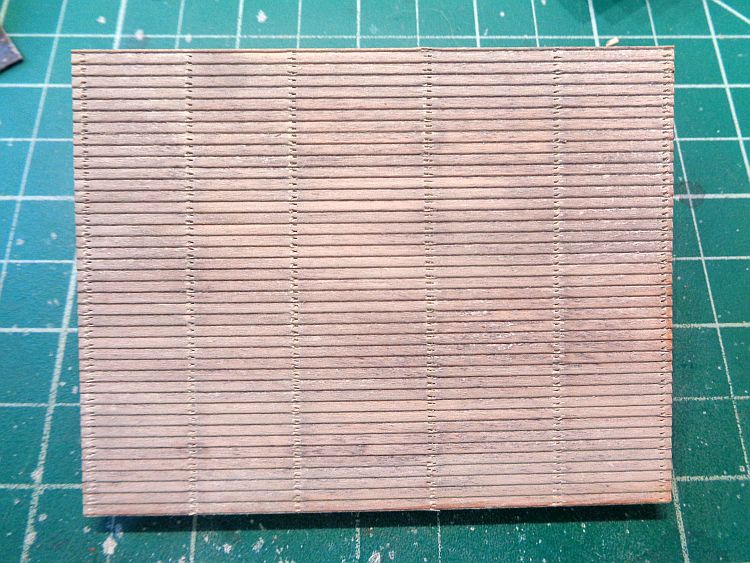

I took all the plastic doors and windows and washed them in warm soapy water to remove any lasting mold release. I set them aside to dry on a paper towel.
I left them on the plastic sprues for painting later.
I've decided to paint this structure with Floquil Driftwood. I found an old bottle of Driftwood that was still usable and combined it with another one.
I've had this bottle of floquil Driftwood for some 35+ years. Back then the Floquil Flo-Stains didn't sell very well and this one was on sale for .99.

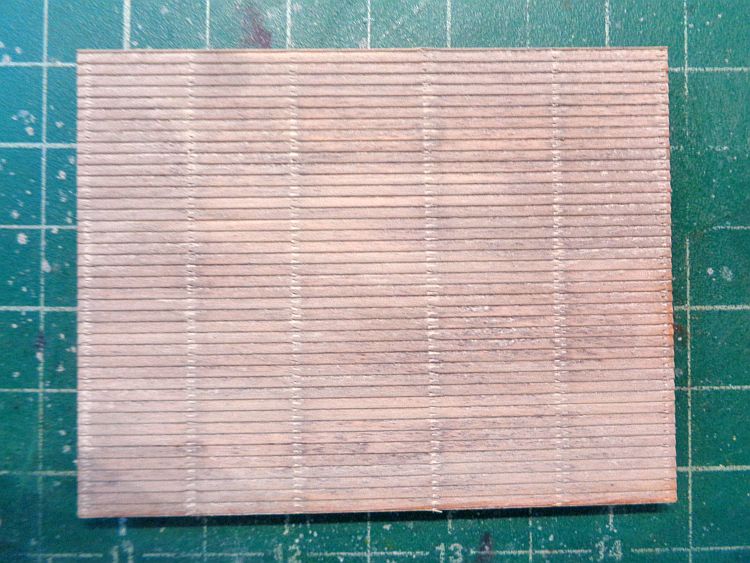

I used a 1/2" soft bristle brush to paint the walls with Driftwood. I dipped the tip of the brush into the paint and then into a bottle of clean thinner. This helped thin the Driftwood and gave me a Driftwood wash.
As I mentioned earlier, this also gave me the coverage I wanted to lighten the darker stained wall sections.
After the Driftwood wash dried, i noticed it settled into the nail holes.
I carefully went over the nail holes with the ponce wheel.
Continued -

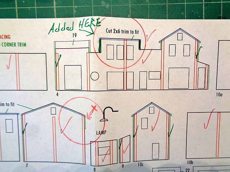

Not shown here but I also stained and painted the 4X4 corner trim. When all was dry, I edge glued them to the walls per Doug's suggestion.
However, I did deviate on two of the walls with respect to the trim.
In the photo below you can see he suggested gluing the corner trim to the top of walls 5 and 7, bottom circle. This was guess work on how long they needed to be.
An easier solution was to cut and glue this trim to the center of the front main wall, shown in the upper red circle and marked in green. I test fit the walls and this worked perfectly.
