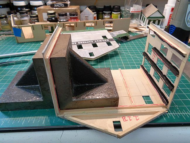

I added several cross braces to support the warehouse flooring. Here is the first one, an 8X8.
Here is how the flooring will look.
The flooring wasn't wide enough for the span. I decided to have the flooring run across the warehouse instead of length wise.
I also forgot to add an interior end wall. So that came next.
You can see in the next photo how the flooring runs across and not length wise.
The gabled end wall was painted to match the other walls.
I also made a final floor test fit prior to staining the floor.
I set the warehouse to the side and glued the main REA structure walls together.
I used weights and metal squares to ensure the walls were square and held in place as the glue dried.
The rear side wall was short. This was a measuring mistake on my part but was an easy fix.
The next photo shows how much I messed up on the wall.
I used an HO scale 8X8 and glued it under the wall and between the two corner posts.
The main REA building is square and level.
Done for today.

Good save on 8x8 at the wall bottom. No one will ever notice except you and I (and anyone else following along).....my lips are sealed
Terry
Great progress Tom and good save on the wall.
