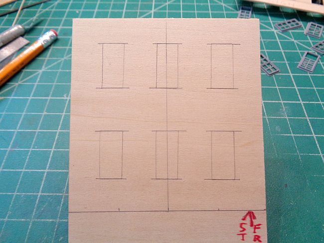

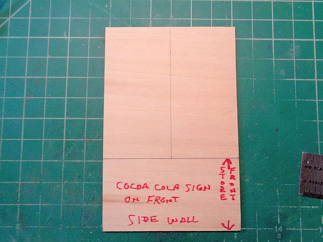

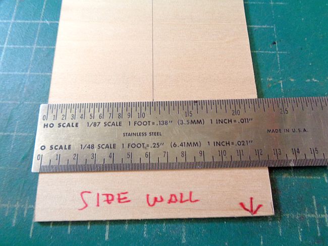

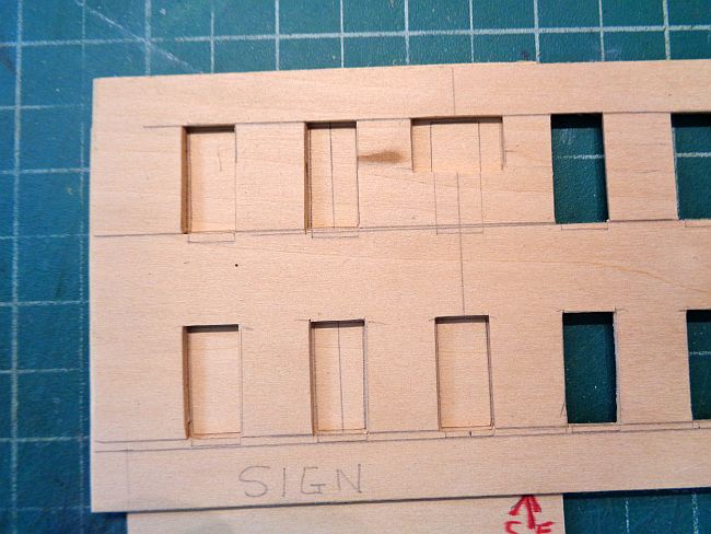

My plan for the larger end wall is to have a sign on the lower portion of the wall. There will be no windows on this portion of the wall. However, I will have windows on the second and third stories.
To get the windows centered, I found the middle point of the wall and drew a vertical line up the center.
I then used the front wall and centered one of the windows over the vertical line.

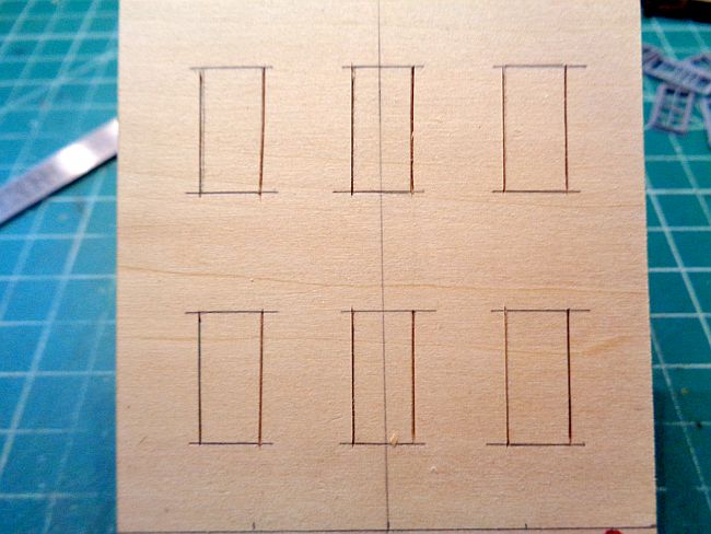

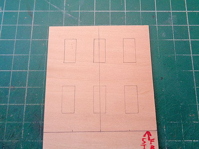

I held it in place and drew in the window out lines for the six windows as shown.
I used a pencil to extend the horizontal lines on the top and bottom of the windows. These lines give me a guide where to stop the vertical cuts.

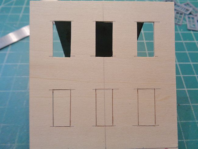

I used a metal ruler and cut along the vertical lines on each of the six windows.
I then used a new #11 blade and cut the horizontal lines on the windows. The window blanks should then pop out.
Now I have the three walls, front and both sides with the windows cut in.
