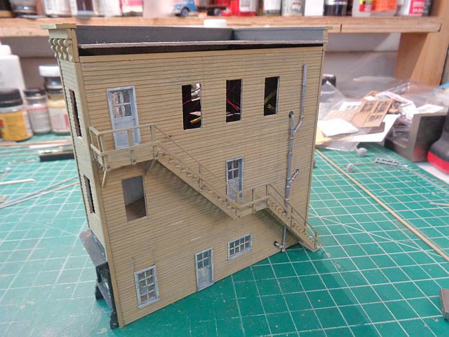

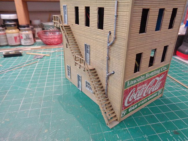

Two extra photos of the built staircase.
The roof card isn't glued in place.

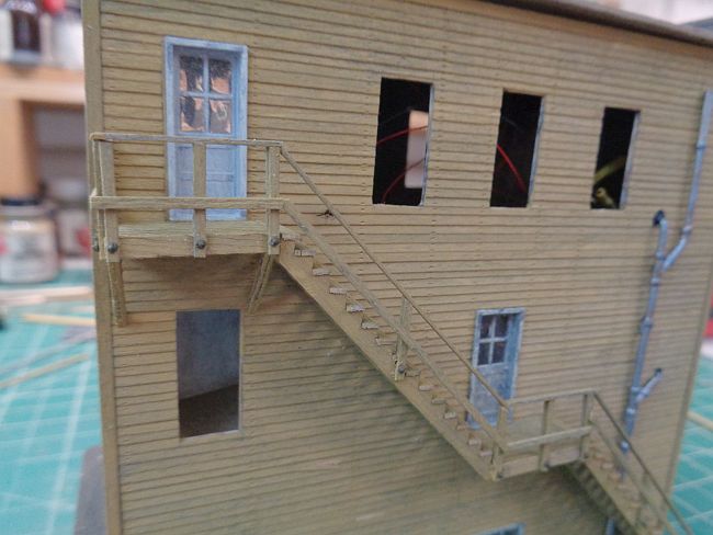

One extra detail I added was to use "N" scale Tichy nut and bolt castings to each of the eleven staircase support posts.
I used a # 79 drill bit and carefully drilled into the lower portion and glued the N&B into the holes.
Done for today.
The staircases look terrific. The NBW's take them to the next level.

Howdy Tom,
The stairs and drain pipes really add a craftsman touch to the structure—excellent work as usual.  Wish I was nearby to see your work in person.
Tom I'm always amazed at your attention to detail and your precision. I may have to get me one
of those Choppers; minus the cuts of course.
