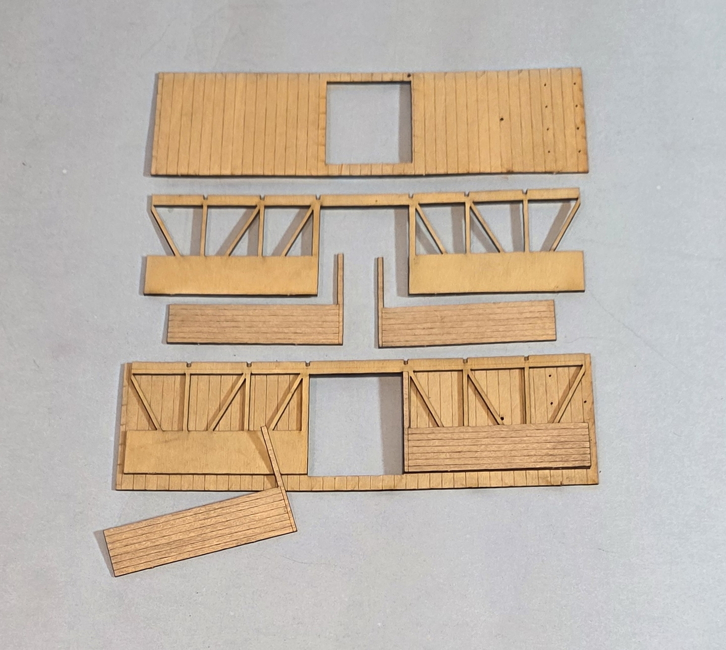

This photo shows the components of the sides.  The sides are three layers sandwiched together.  They were easy to assemble.

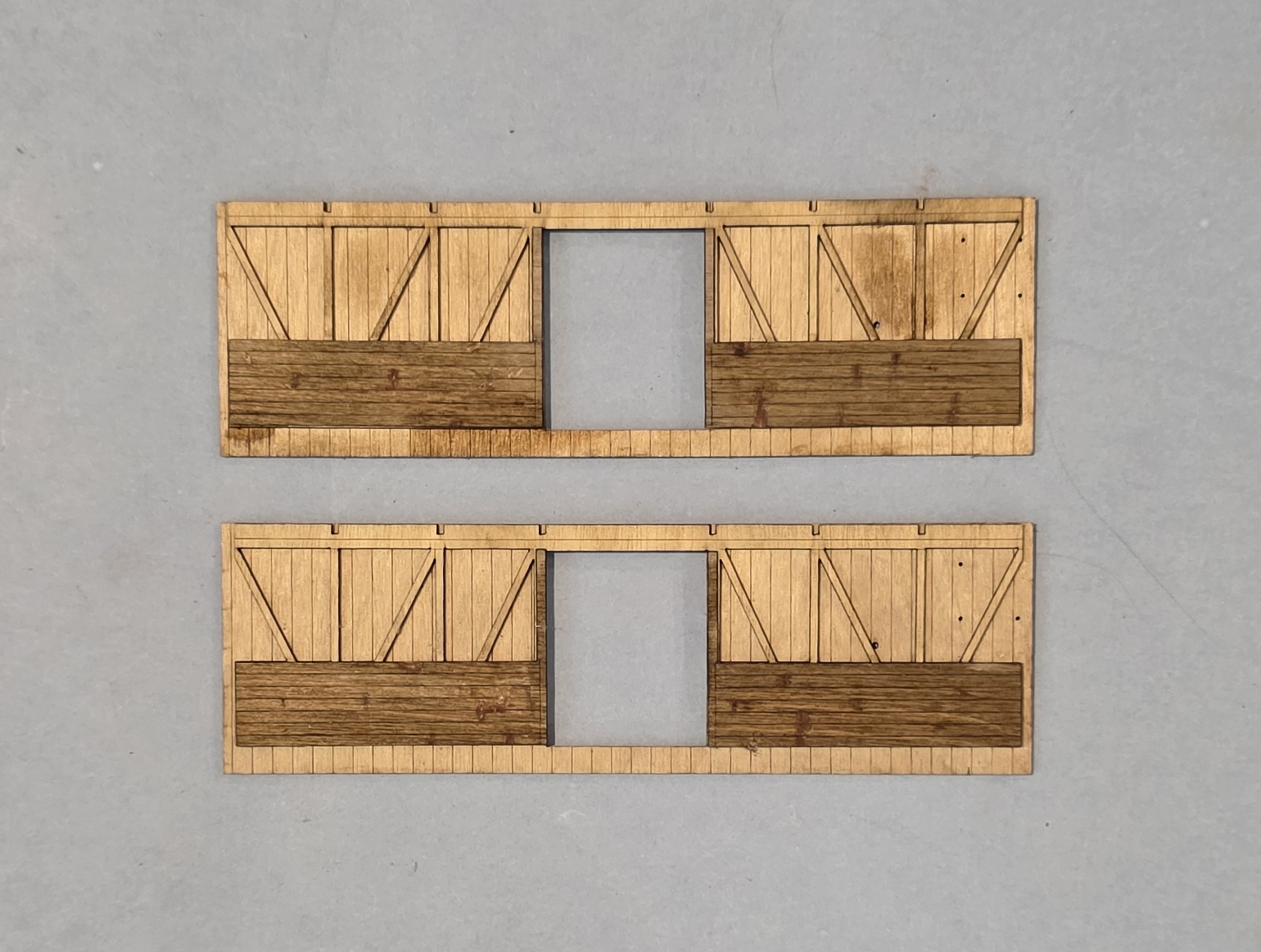

Here are the finished walls. Research on the interiors of vintage boxcars revealed extensive damage to the sideboards, so I added scrapes and punctures before staining.

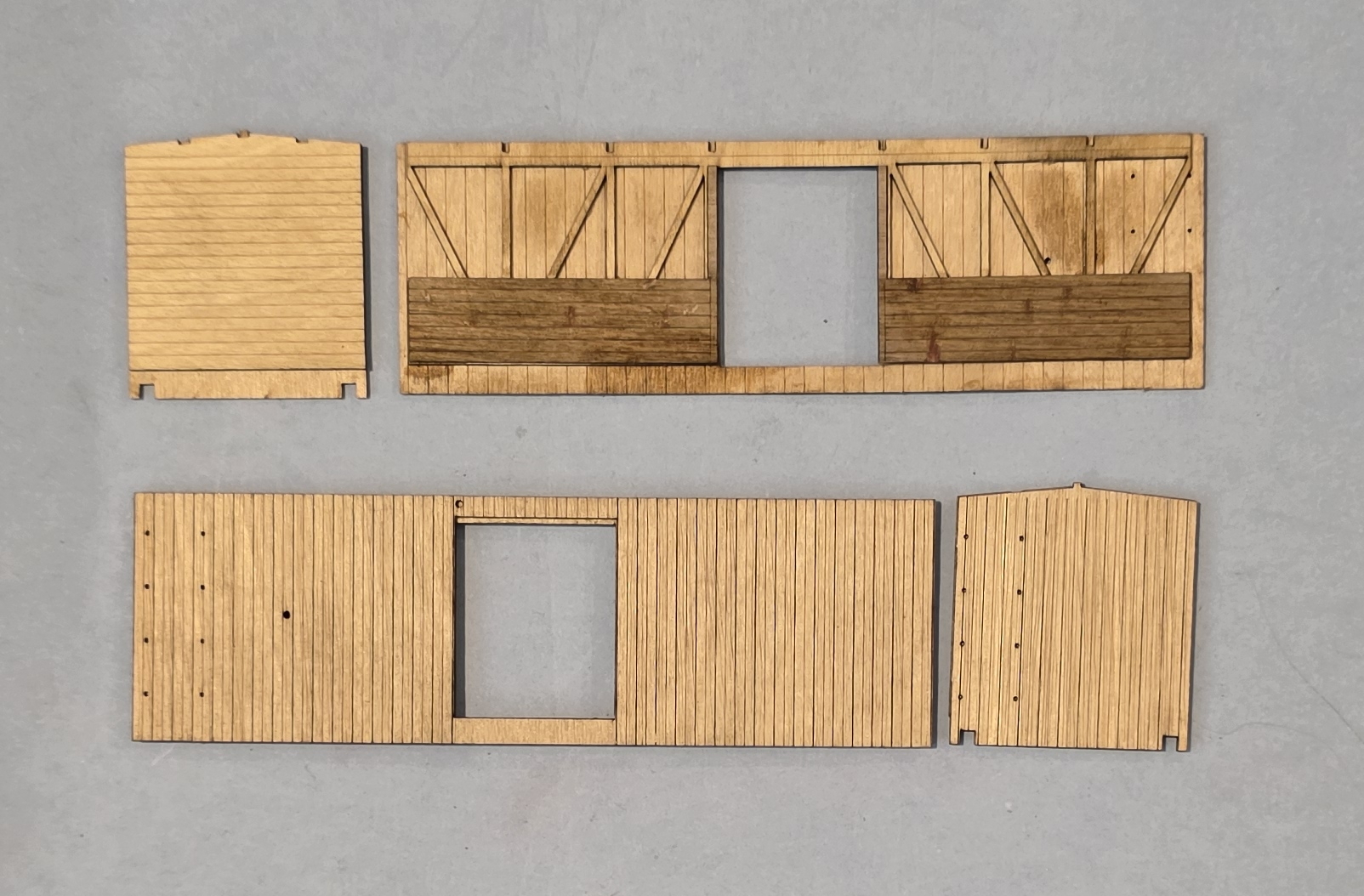

Finally, the walls and ends are ready for assembly.  This photo depicts the boxcar's interior and exterior.

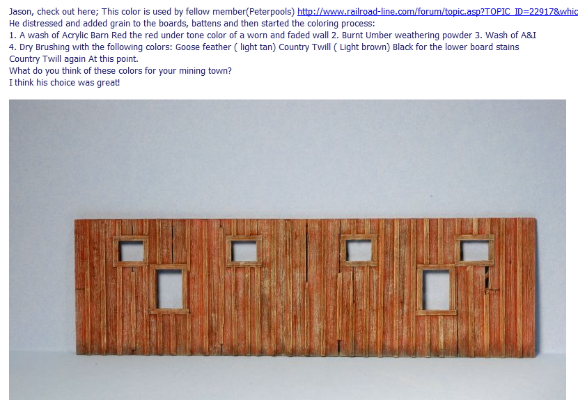

My finishing plans for the boxcar are to make it an old, worn-out boxcar on its last legs.  I'll use Peter Pool's technique as used on previous structures and rolling stock.

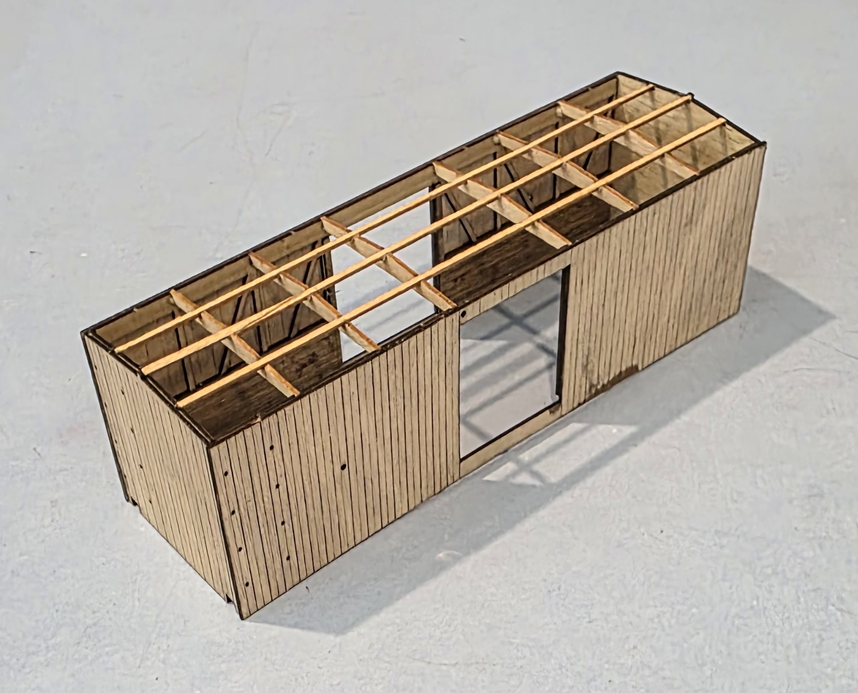

I assembled the body and added purlins and roof supports.
Next, I'll attach the roof.  When the car weights I ordered arrive, the frame will be attached to the car body.  I still need to add truss rods, couplers, and trucks.
