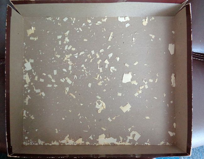

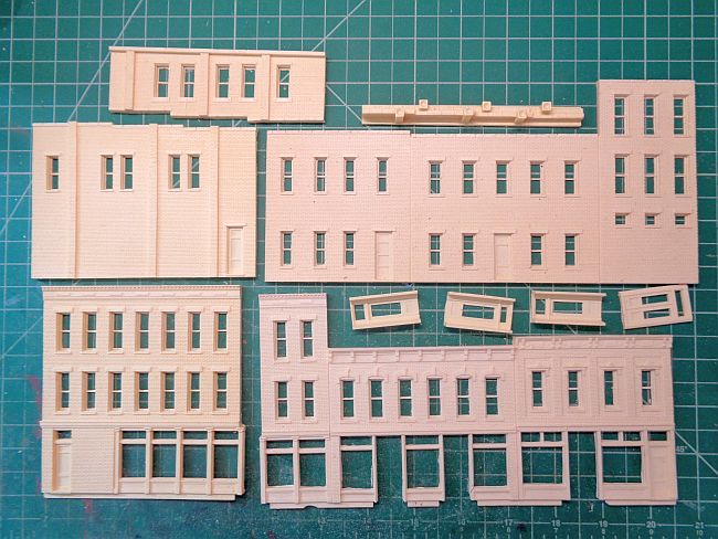

Merchant's Row II was not like MR I. This kit's walls were very very sticky. When I started to remove the flash from the windows, the flash stuck to the walls. I got the larger parts removed and used the box lid to catch the flash.
What wasn't in the box lid, was either on my lap or on the floor.
I decided to remove the sticky prior to doing any final and fine filing of the openings.

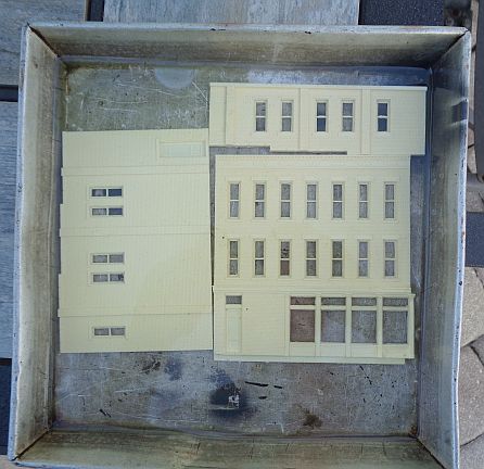

I used all my Simple Green on the first kit so I thought I'd try and use 91% Isopropyl Alcohol. I poured some in a square tin I use for baking brass locos.
You can see the darker yellow on the walls. This is the sticky crap coming off. Once I soaked all the parts for about 30 minutes, I rinsed them in warm water and padded them dry with an old soft bath towel.
Perfect, no more sticky crap on the walls.

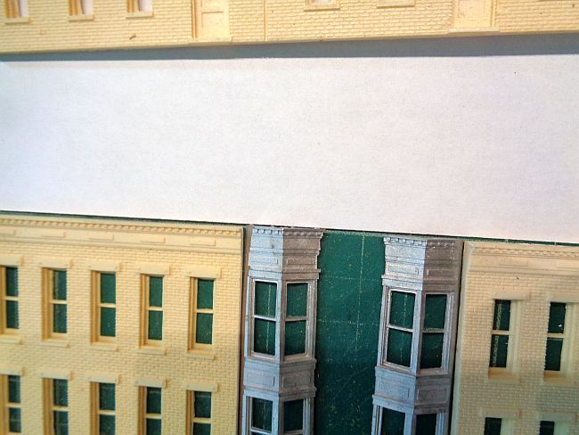

According to the plan photos, the top of the turret is supposed to be flush with the top of both wall sections.
It isn't as shown below. The two turret pieces are slightly higher than the walls.
I'll leave this as is for now.

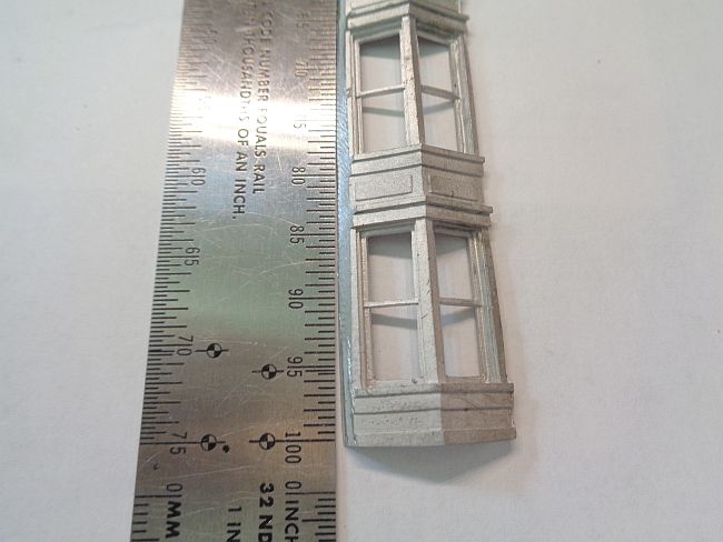

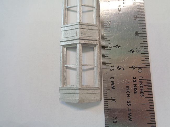

I also found the outside edges of the metal turret aren't perfectly straight.
I've aligned them with a metal ruler and you can see the gap at the bottom.
Left turret section -
Right turret section -
