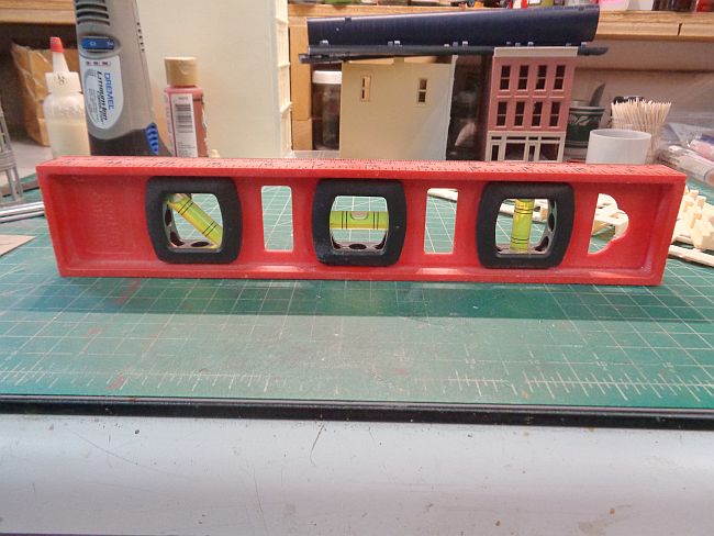

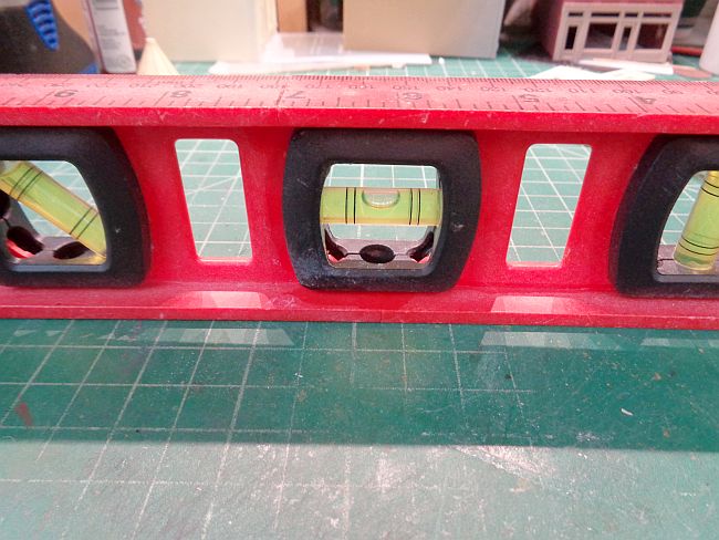

Ah, yes, the big question. Well, let me say that the work bench is as level as it will ever be.

Thank you and yes, I do have patience when it comes to modeling. I found the little level at a local hardware store for .49.

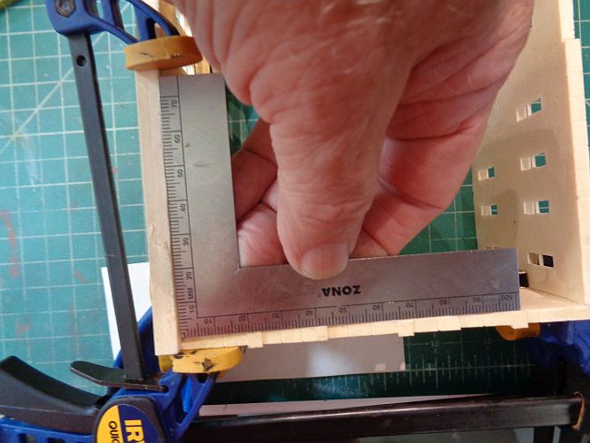

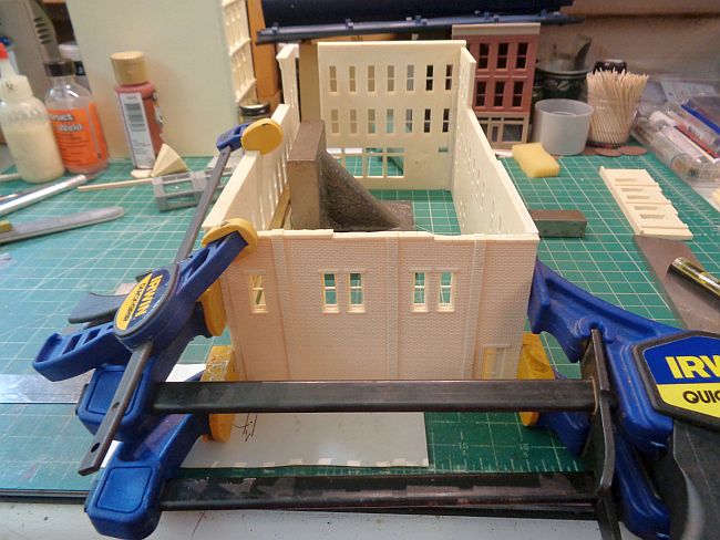

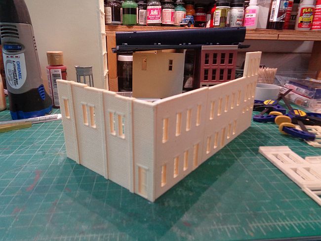

I started gluing(epoxy) the walls together.

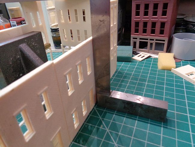

While the epoxy was setting I made sure the wall were square.
Once I got them square, I tightened the clamps.
I also made sure the walls were a true vertical as the epoxy dried.
Every thing will stay clamped until tomorrow morning. Even thought it is 5 minutes, I allow for me having just a little to much resin vs. hardener. To much resin and the 5 minute epoxy takes much longer to set and harden.
Safety valve for me. I'm not in a hurry as adding the turret is next.
