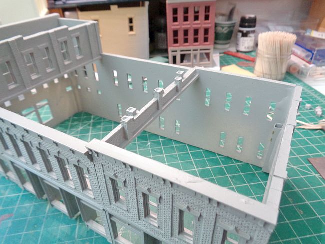

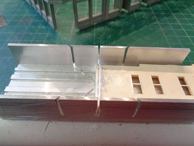

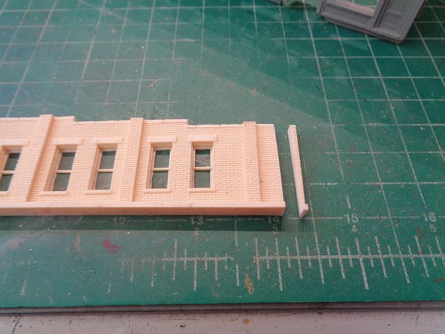

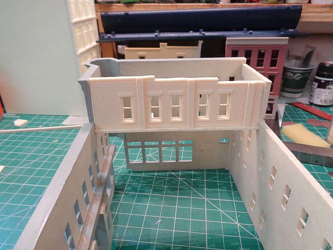

When I attempted to glue the third story wall in place, I found it to be just over 1/8" to long.
I measured the part needing removed and used my miter box and Zona saw blade to remove the offending part.
I determined the part to remove was a portion of the back end of the wall.

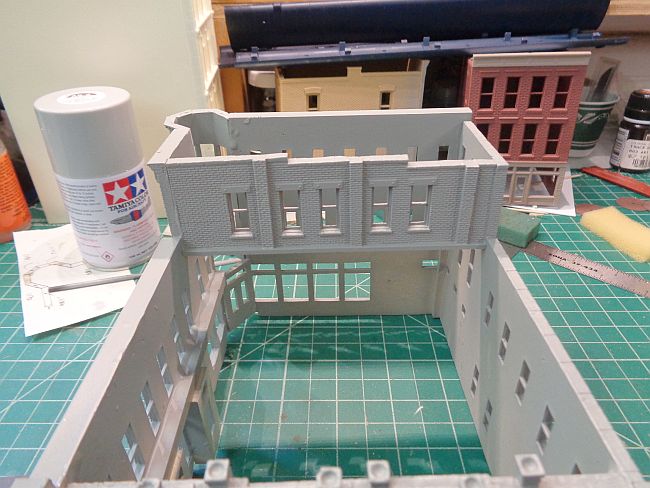

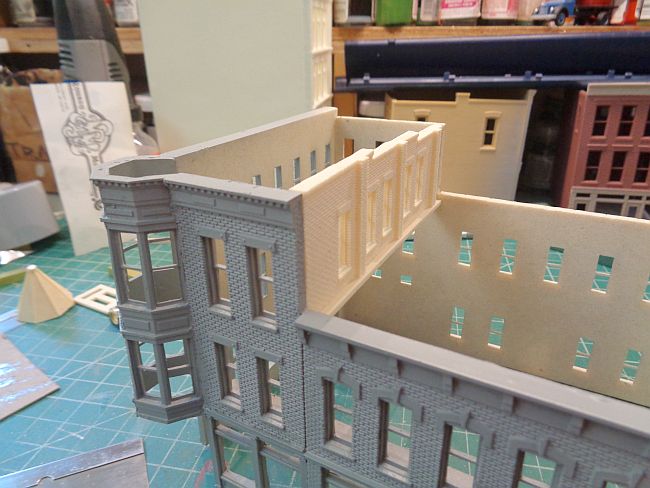

Third story wall section primed.
There is a cast resin upper wall with chimneys that is to fit between the two stores. The high wall part goes in front and the shorter one towards the rear.
Glued in place and the primed.

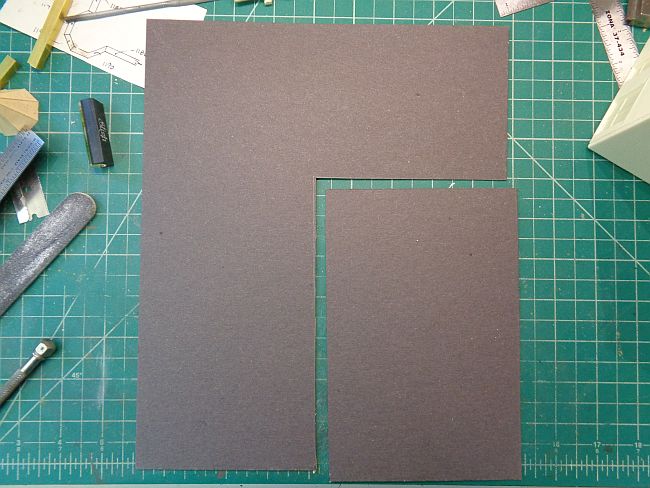

Unlike Merchant's Row I, Row II doesn't have a full cast roof with details.
The kit has two pieces of black cardboard for the roof material. I cut two pieces to fit the roofs.
These are not glued in place, just wedged in to see how it looks. Installation will come much later.

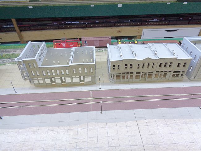

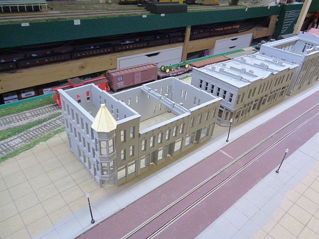

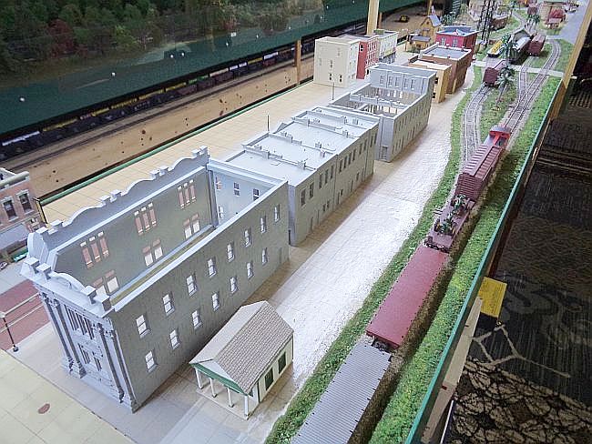

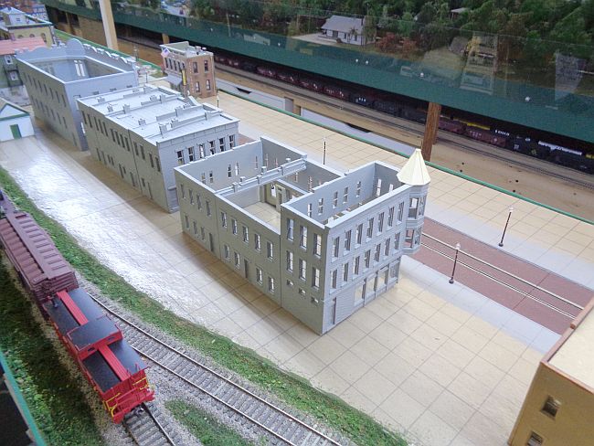

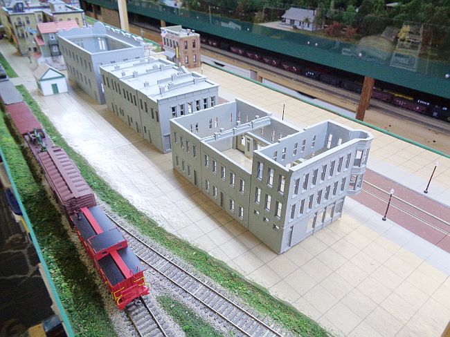

The two structures were placed in Tahope to see how they look.

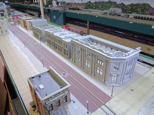

I'm not convinced they will be planted here. With the Municipal Building, the three of them are just to much for the area.
I have many smaller, more appropriate DPM stores and buildings I can place in Tahope.
The Municipal Building will probably stay put. The two Merchant's Row building will fit much better on the third level in Summit.

I understand your thought process, Tom, but I do think when all those shops are painted up in different colours they will look quite different.  At the moment they look like two big blocks of shops rather than eight much smaller individual shops.  I'm not sure, however, how you could mock that up quickly.
The trio of buildings look like a substantial downtown, but I'm guessing that's not the look you're going for.  I've seen towns where there are some substantial buildings all together, and the next street block was houses (so no transition from the big commercial structures to residential.)
Tom, I think they look good where they're at, but I understand your reason for not keeping them together.
I know wherever they end up they'll look great.
