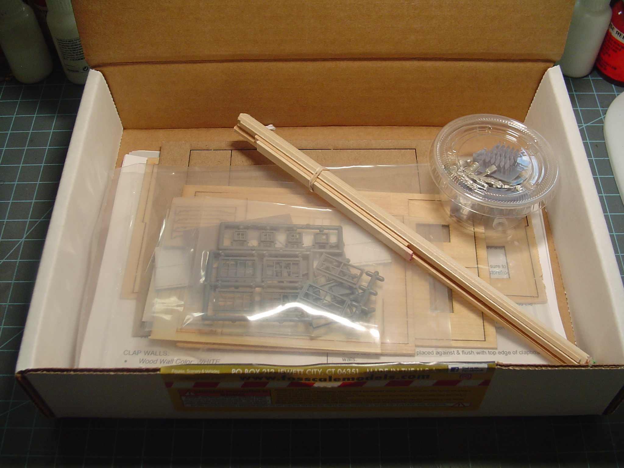

Here's the first peek at what's inside the box.

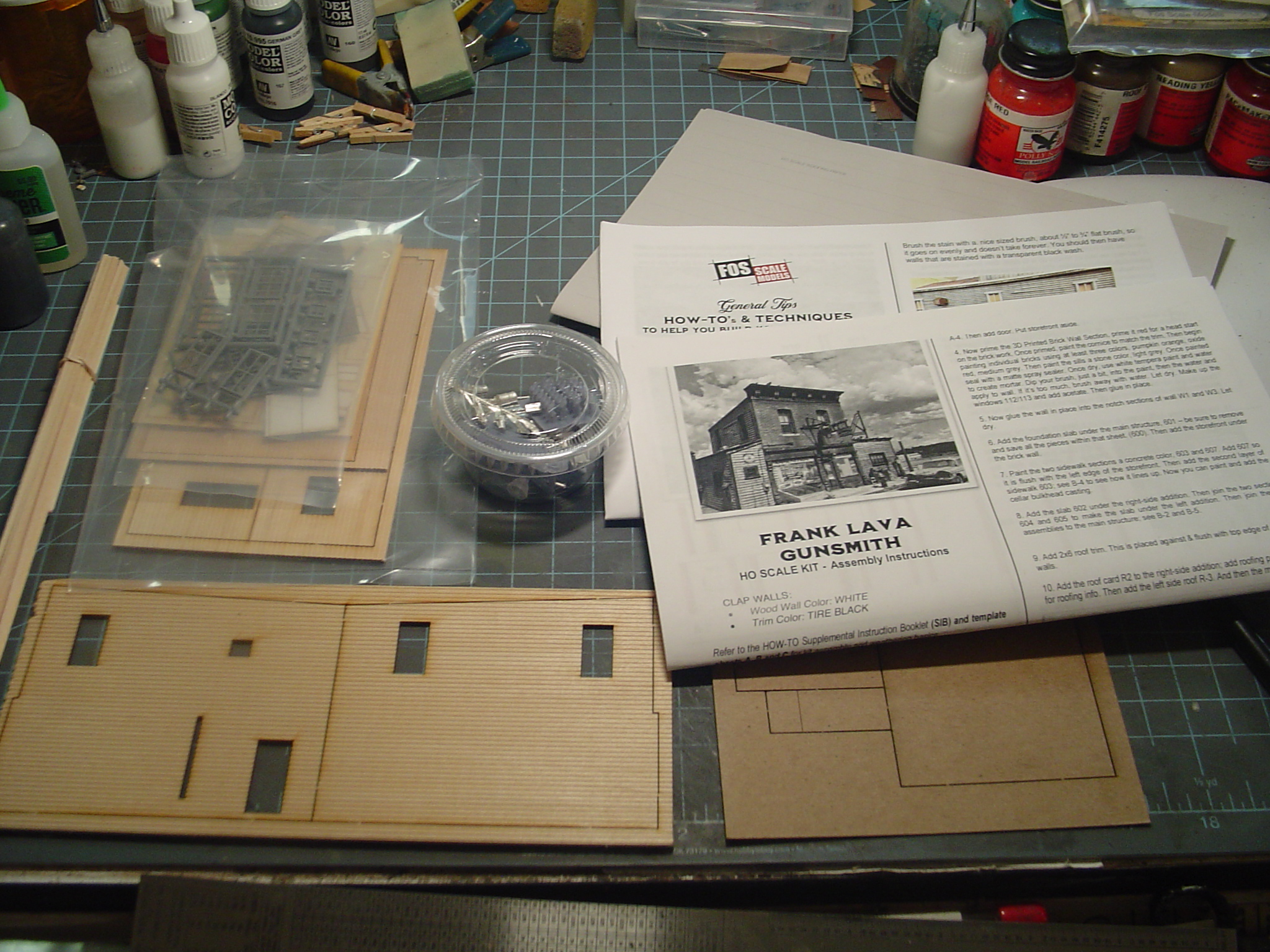

The contents.  A couple of sealed bags of laser cut components, window & door castings, etc. Instructions, strip wood, a contained with 3D printed and cast metal detail castings. But oh no!  :( There should be a 3D printed wall section (it sits above the store front. It's AWOL.  I sent an e-mail to the address in the instructions and got a reply that the information would be forwarded to Doug.  Hopefully the replacement arrives in a timely fashion.

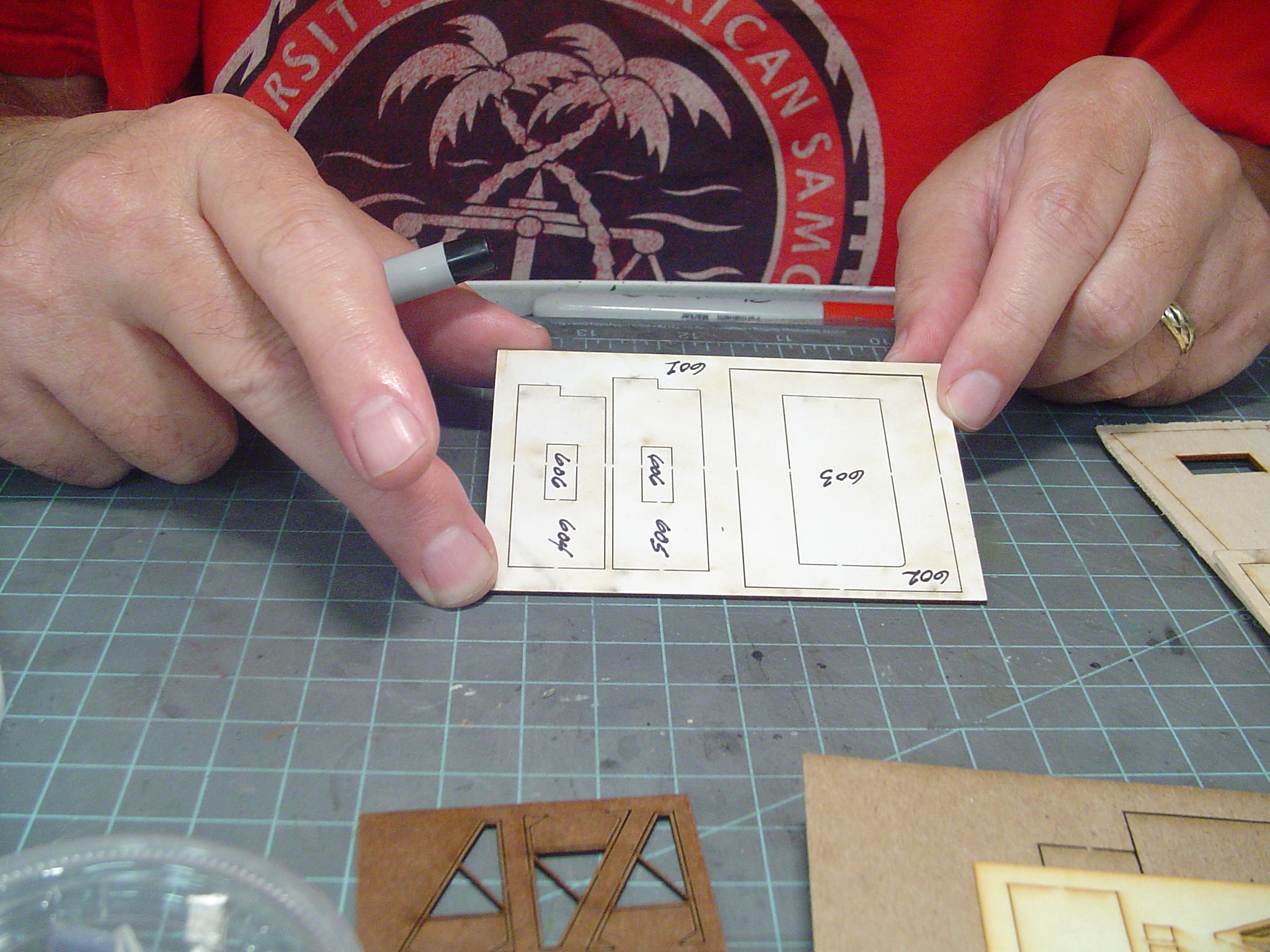

If you have this kit pay attention to this sheet of laser cut parts.  Everything is a part.  Even the outer edge.  No waste here.

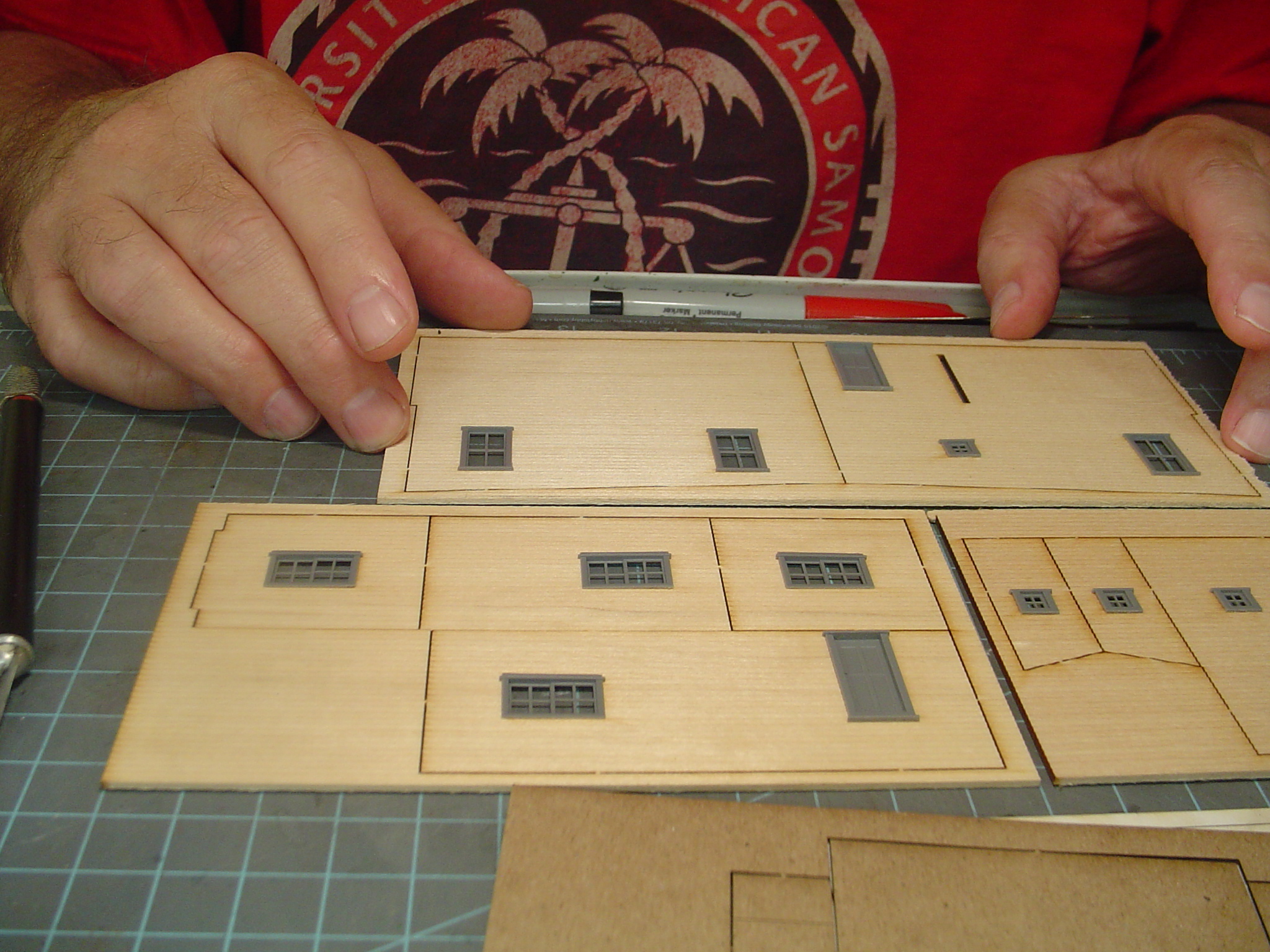

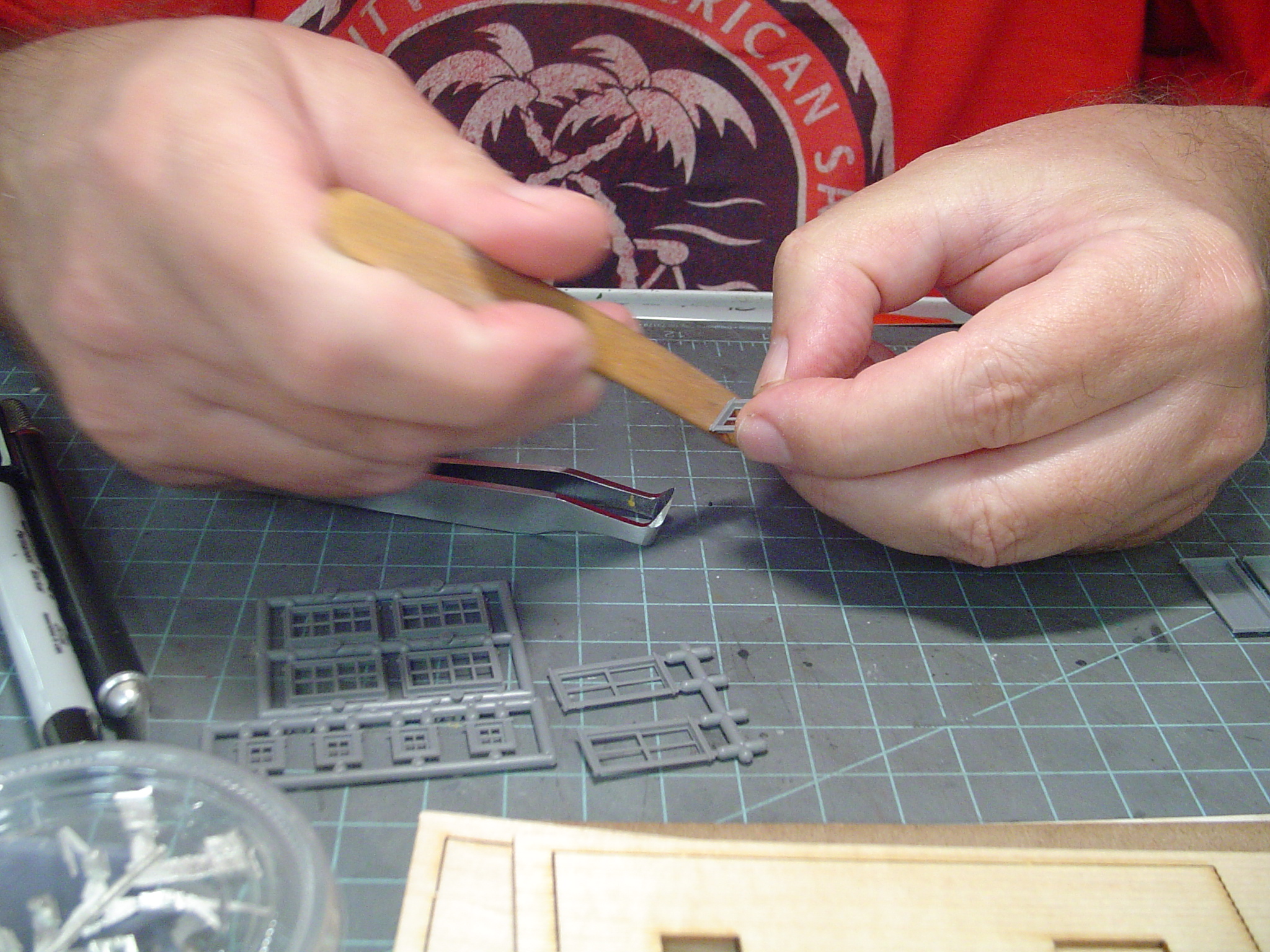

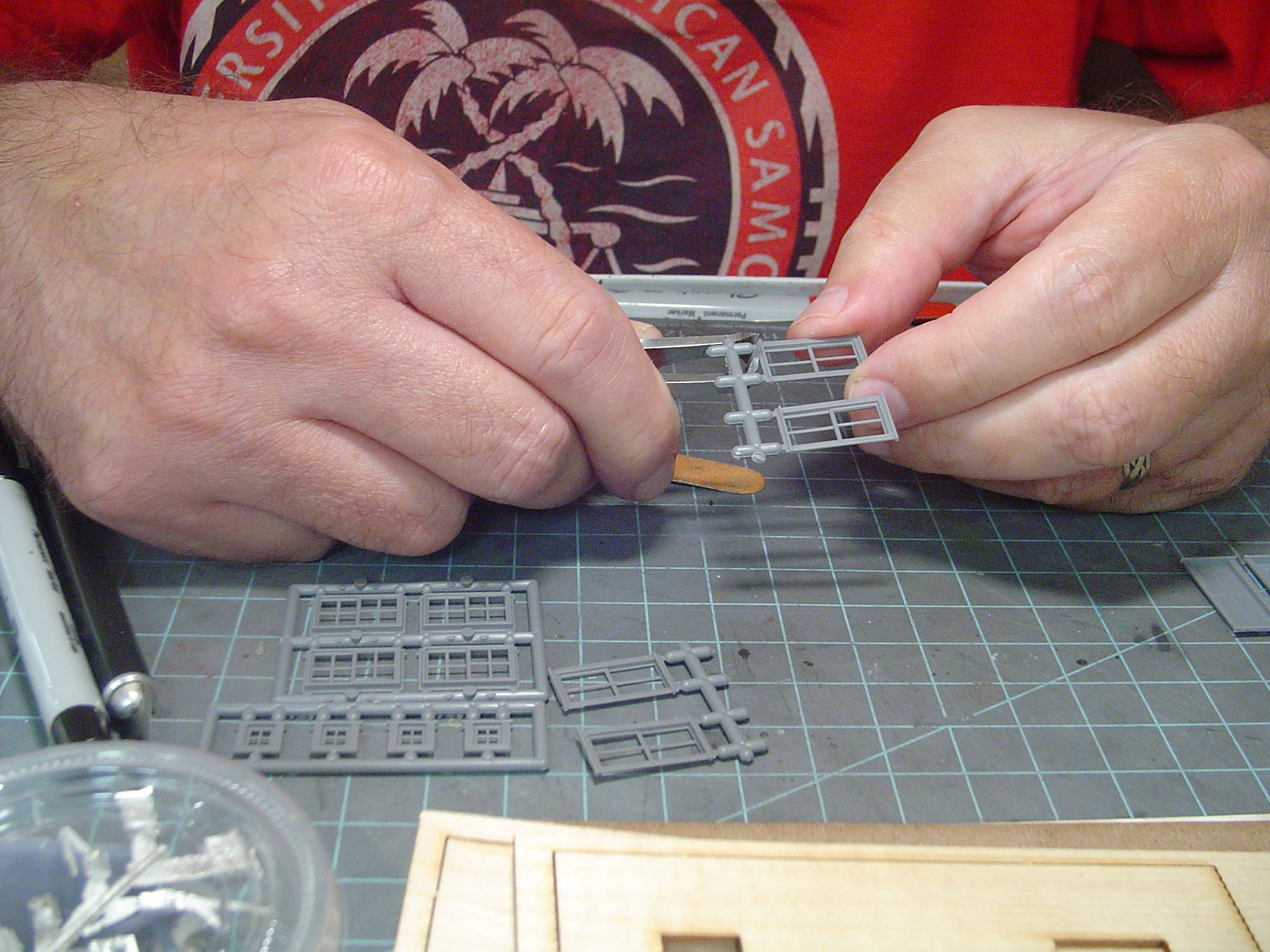

As I usually do, I started by removing the plastic doors and windows from their sprues using a sprue cutter.  Some folks (great modelers to be sure) prefer to paint them while they're still on the sprue.  Nothing wrong with that.  I happen to prefer removing them and cleaning them up prior to painting.
A couple of quick swipes with an emery board touches up any nubs that may have been left by the sprue cutter (thiough they're barely noticeable).
Something Tom (ACL1504) and experience has taught me is to check to make sure you have enough doors and windows to fill all the openings.  In this case they're all there.  It really kills the momentum when find out you're one or two short after they've been painted, weathered, dry brushed, the windows have been glazed, etc.  But, just in case, I have a couple of Tichey Window and Door assortment packs I keep handy.  If one is missing, I can typically find match in those assortments.

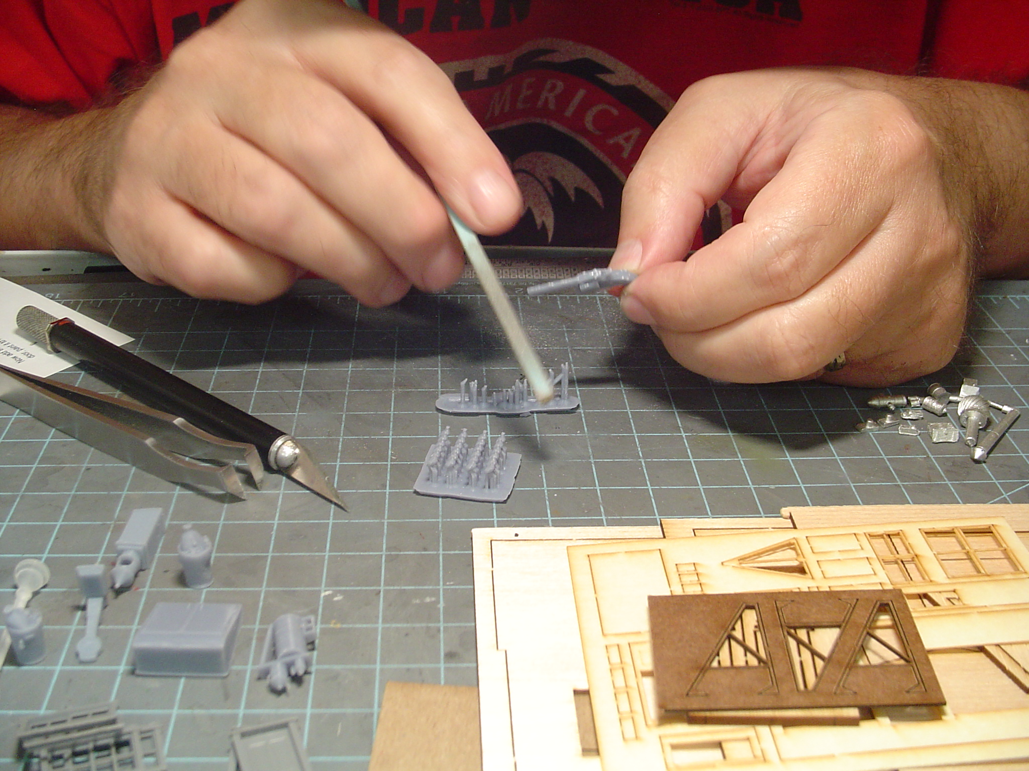

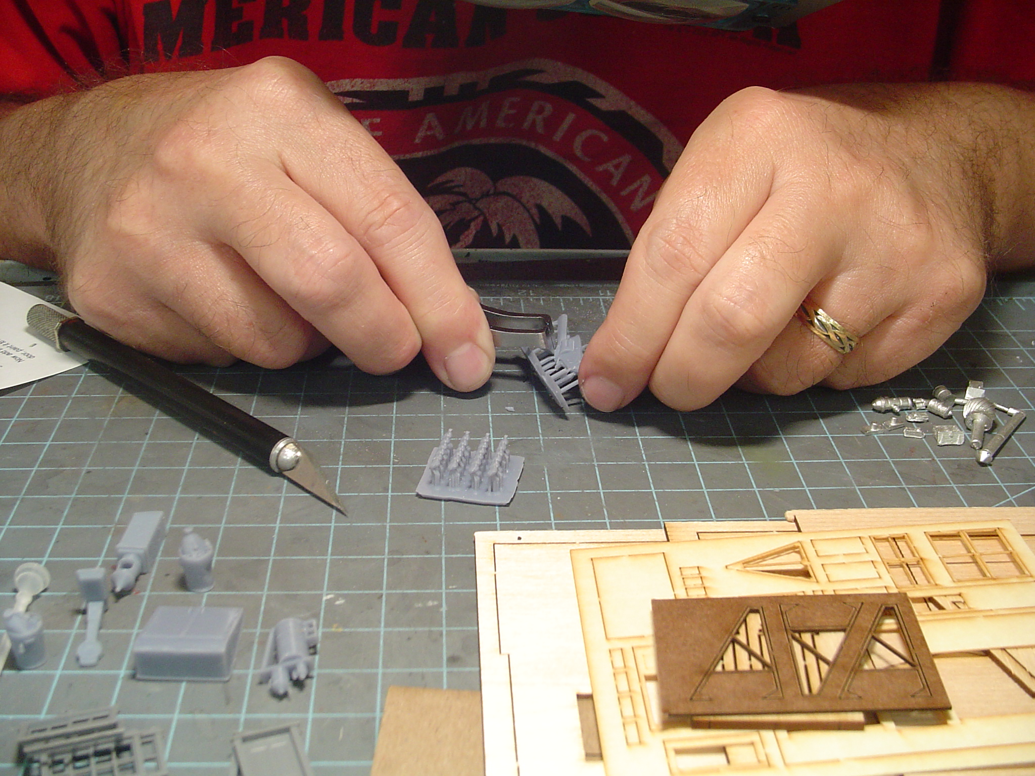

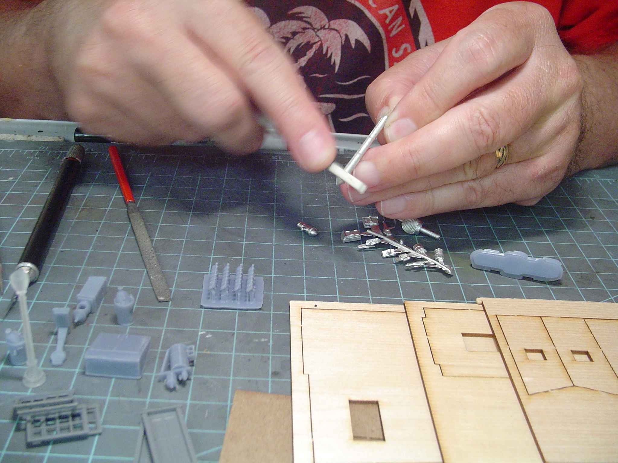

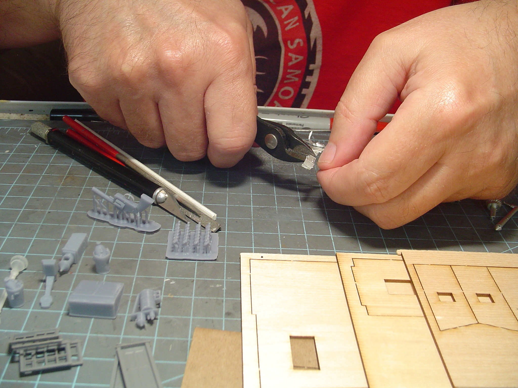

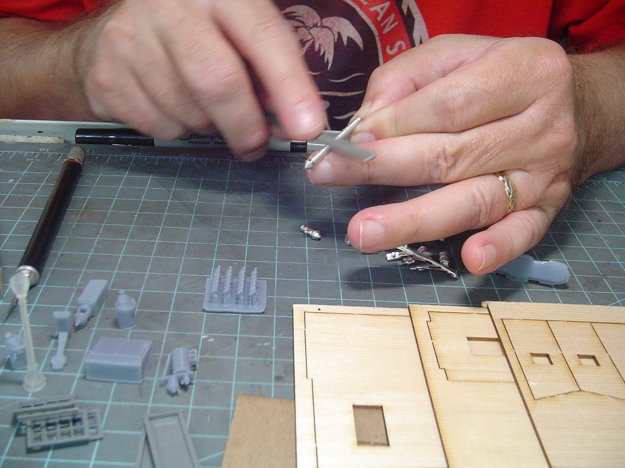

There's a sprue with several castings (cans, telephones, electric meters, etc.) included in the kit.  An old pair of rail nippers works well for removing the parts from the sprue.
Some of the 3D printed components need to be removed from their base.  The sprue cutter works well for this most of the time.  Sometimes it can reach in to where it needs to go and other things need to be used.  Like and X-Acto knife.
I clean up the 3D printed components with sanding sticks.

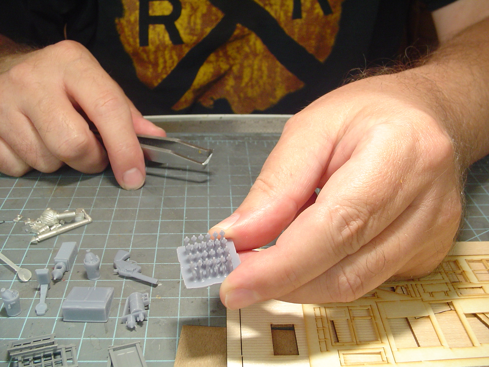

There's a ton of pigeons included in this kit!  I debated painting them before removing them from the carrier but opted to remove them prior to painting. I think they're too close together to paint when they're still attached to the base.
More in a moment... ;D

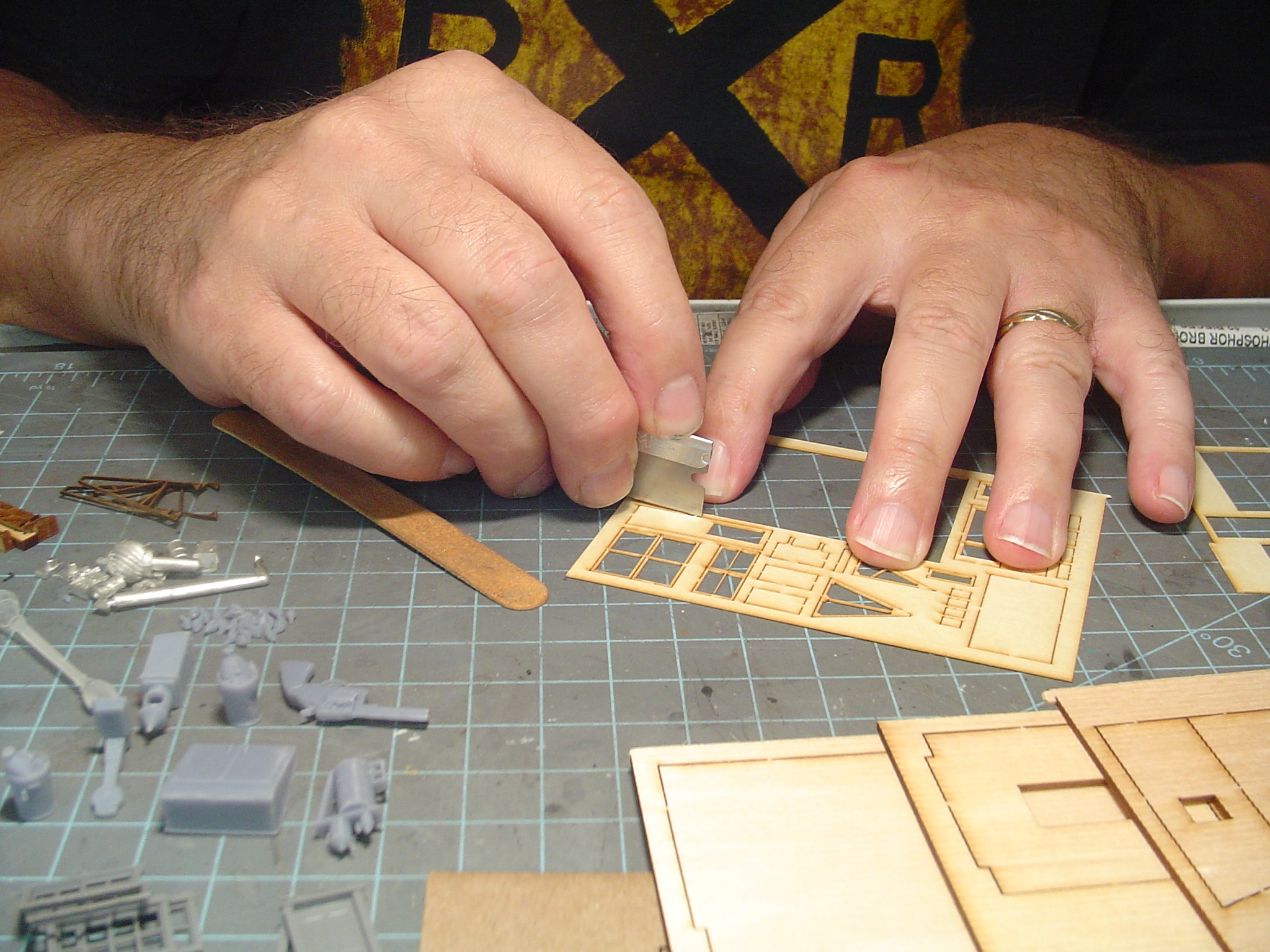

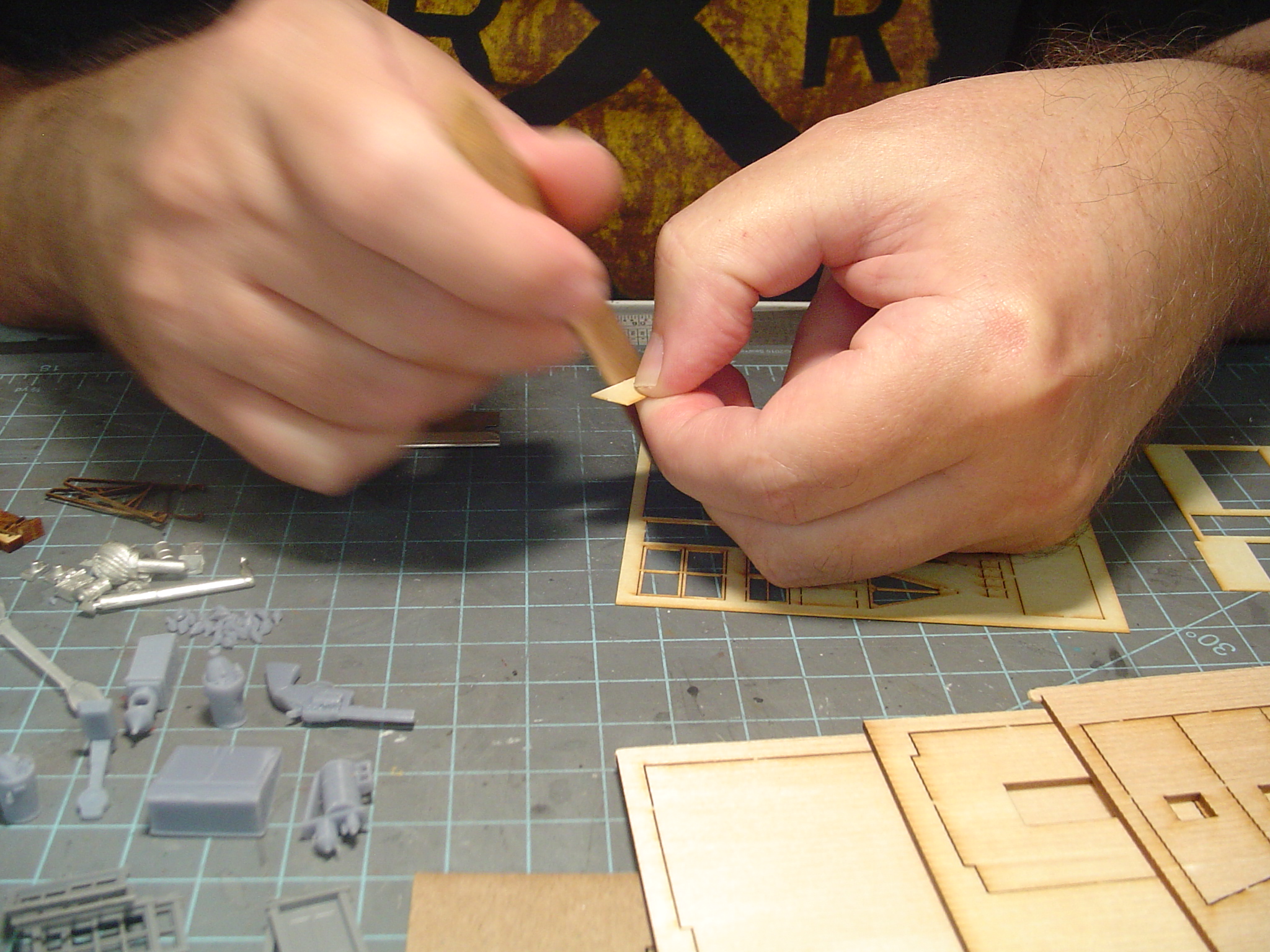

Continuing on I remove all the laser cut parts from the thinner sheets next.  For this I use a single edged razor blade.
And I clean them up with an emery board.  Just a couple of swipes does the trick.

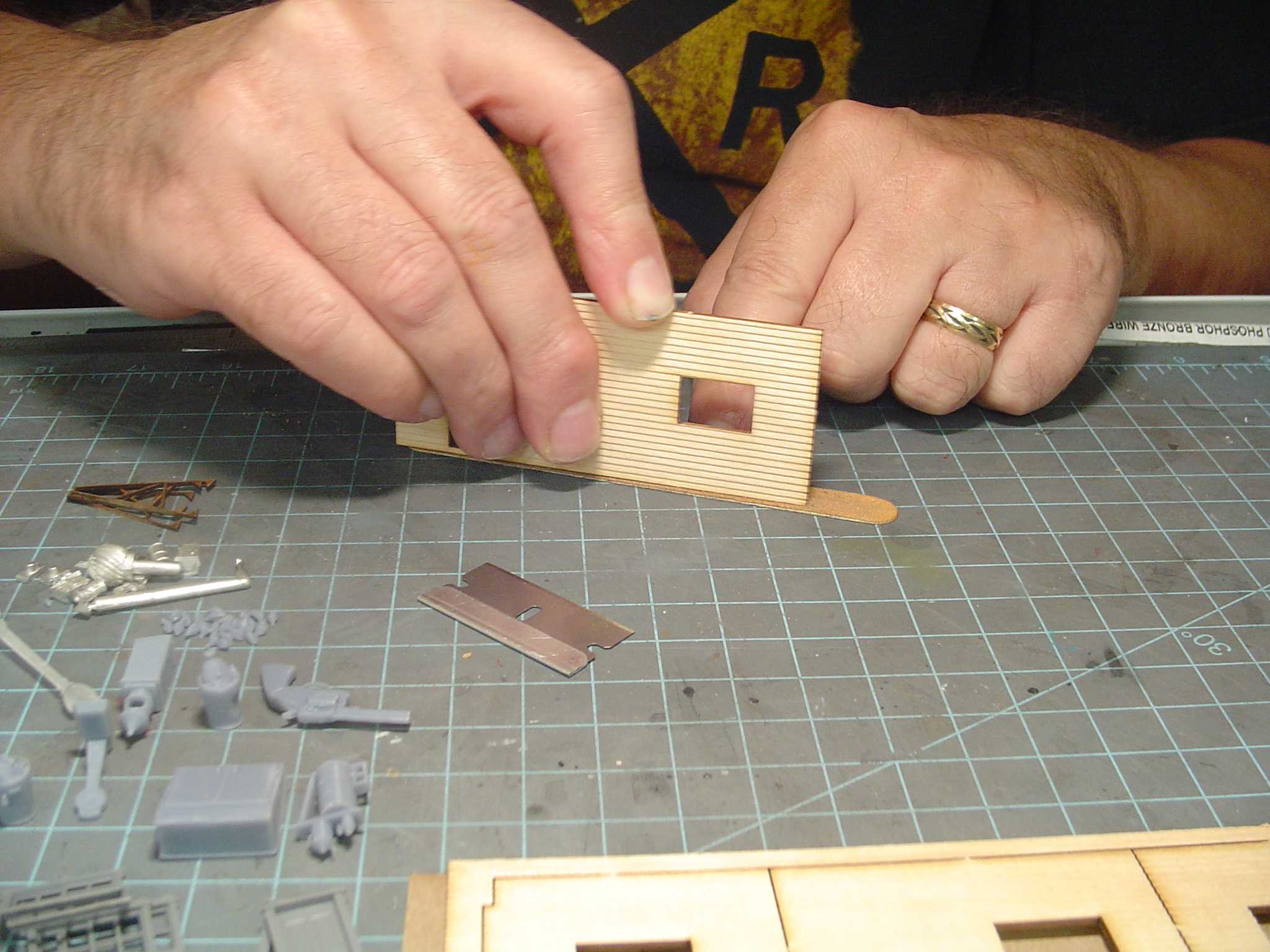

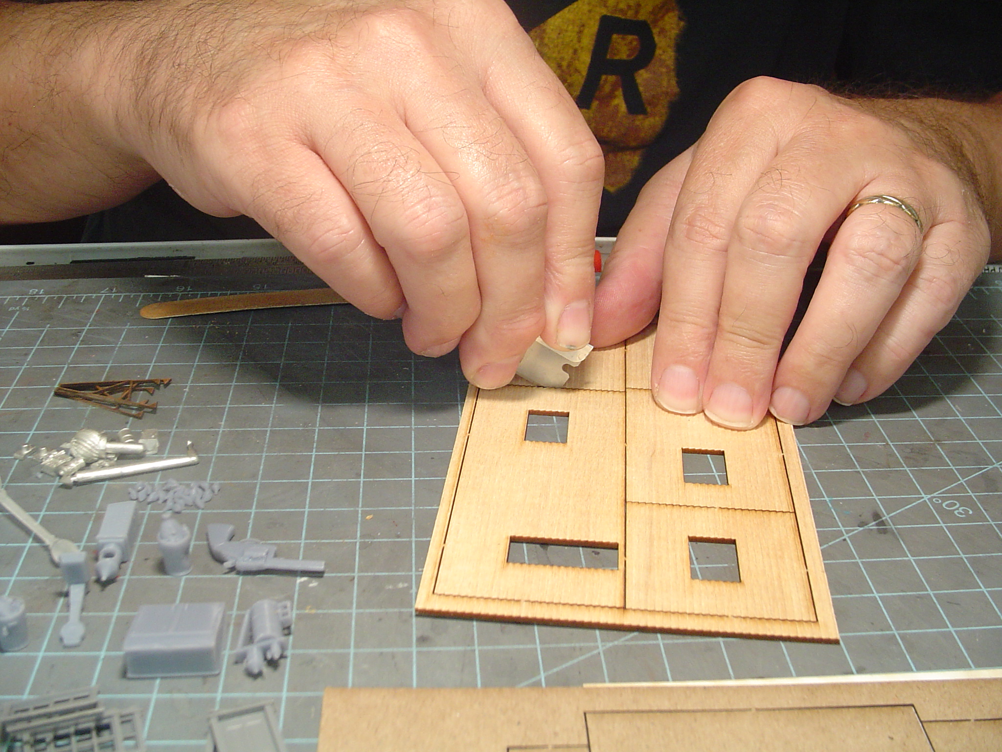

Same for the clapboard wall sections.  A single edged razor blade to remove them.
But a little more aggressive sanding with the emery board to square up the edges.  The laser cuts at a slight angle to the edges are necessary 90 degrees.

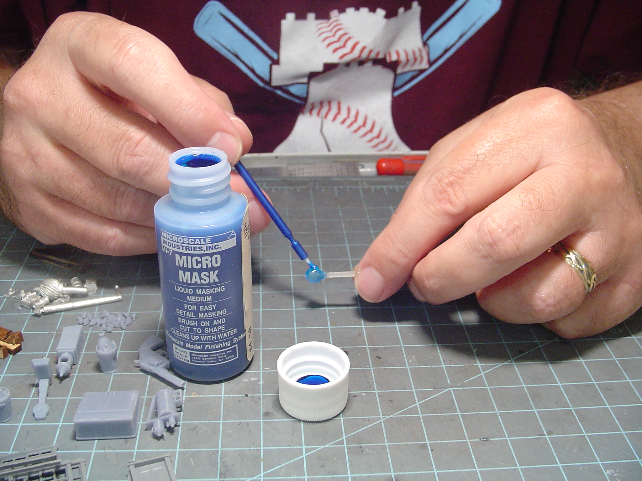

There's a clear lamp post (I assume this was 3D printed as well) that I wanted to prime and paint the base and post but not the glass globe.  So, I used a small disposable brush and painted the globe with MicroScale Industries Micro Mask.  Normally this gets applied over a painted, gloss, finish.  I hope it doesn't give me any trouble being painted over the raw finish.  We'll find out after I paint it when I go to remove the mask.

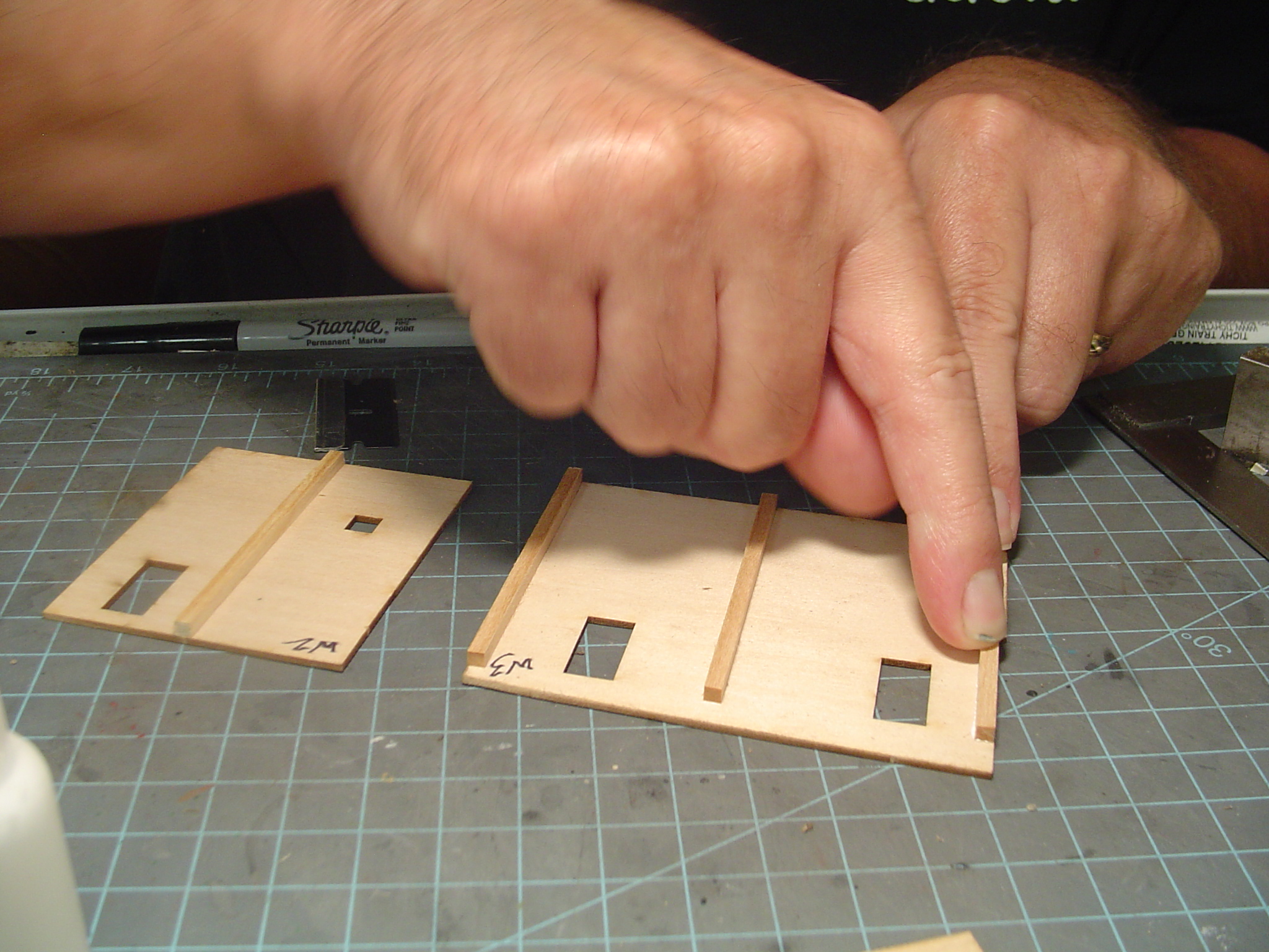

I then braced the walls as per the template.  The only thing tricky about this is the bracing for the side walls has to match the height of the rear wall.

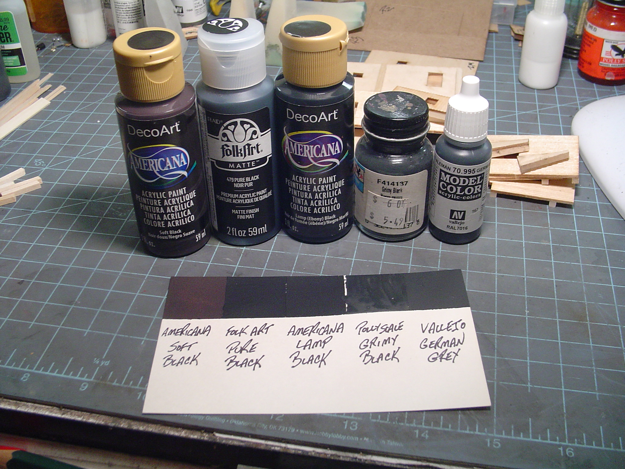

I like the pilot model Doug built.  I'm going to use similar colors.  This will be the first time I'm going to use black as a trim color.  The instructions reference a Tire Black from a brand of paint I don't have on hand.  Rather than hunting for it I opted to make a little sample card of some of the black paints I have on hand.
I think the Vallejo German Grey is going to the winner.  Alright, it's not black.  It sure looks black to me though.

I use German Panzer Grey as my standard "scale black" color.  It's close to the old Floquil color, and a lot easier to find these days.

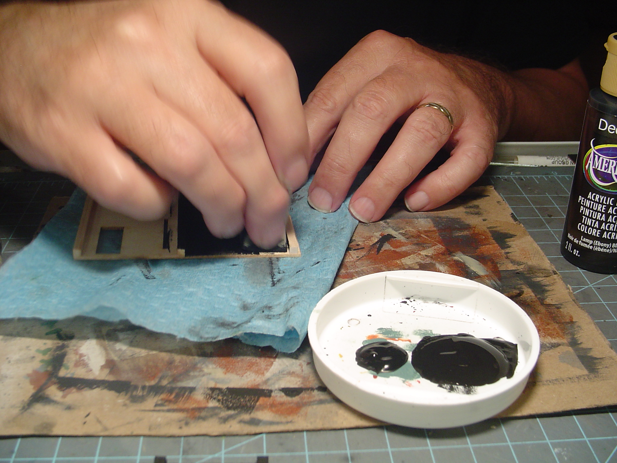

Since I had the black paints out, and the walls braced, I took this opportunity to paint the inside of the walls black.  If I light this one up (which I most likely will) this will prevent the light from passing through the walls.  I also like a black interior in case you can see inside a window.

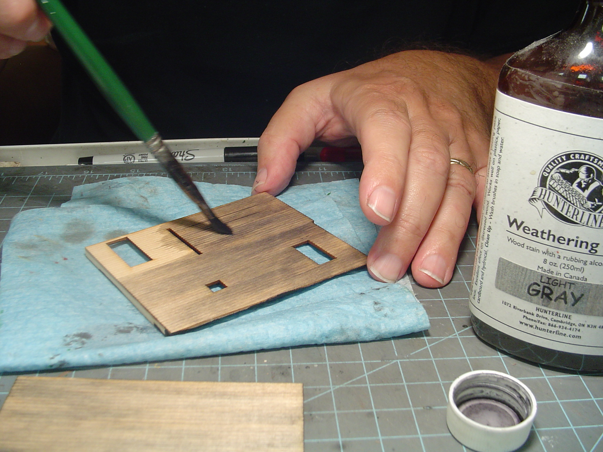

Next up, I stained the walls with Hunterline Weathering Mix Light Gray.  Sometimes I use their Driftwood.  Sometimes I'll used an Alcohol and India Ink (A&I) mix.

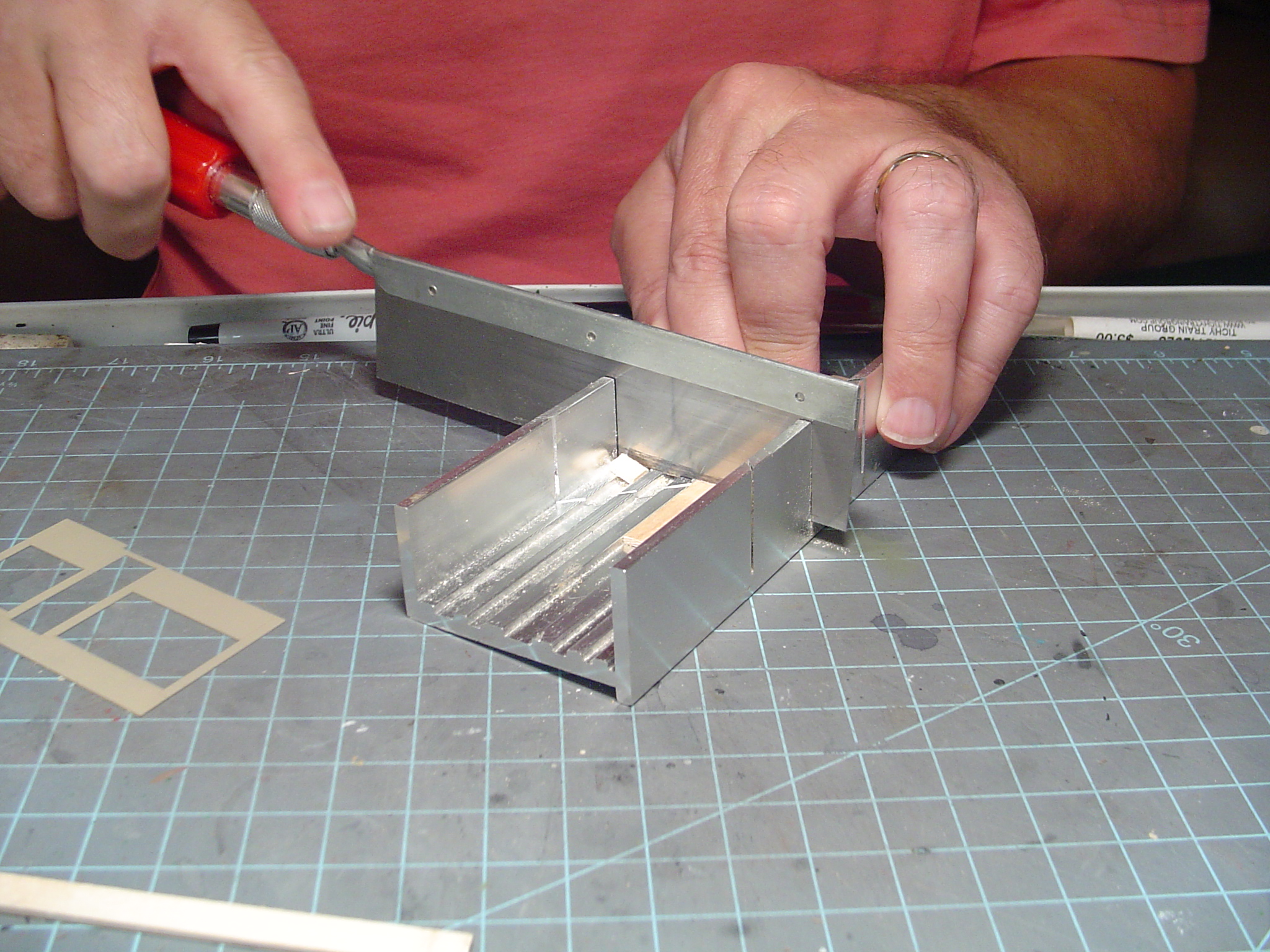

Before I stained the strip wood with the Hunterline weathering mix there were two larger pieces that needed to be cut to match the width of the store front.  After trimming the other end off and sanding it smooth, I marked where the cut needed to be made.
I used a fine-toothed razor saw and a square to make the cuts.

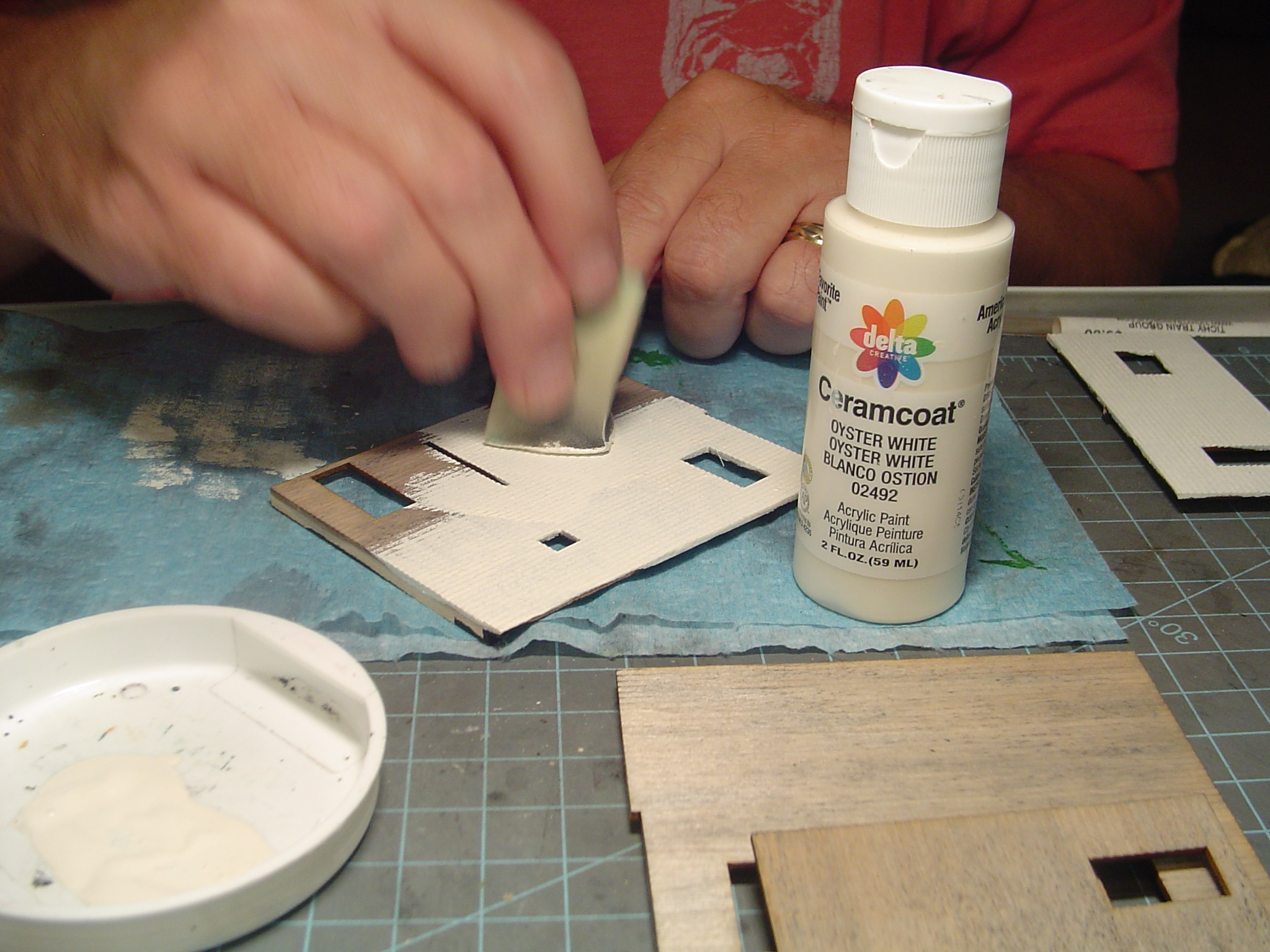

Next up I used a makeup sponge to paint the walls Oyster White.

Quote from: deemery on May 13, 2025, 07:52:21 PMPigeons, eh?  They could be a painting challenge, pigeons can be kinda colorful within a limited palette.  ;D

I think that Vallejo color you're using is the same, or very very close.  (Of course, particularly in wartime, paint QA tends to "loosen up" a bit...)

Thanks for the thoughts, Mark! I gave some thought to cutting the base holding the pigeons, from front to back, separating them into rows. Probably could have cut it using a cut off disk in a Dremel.  I opted not to.  When I paint them, I'll tape a piece of blue to the workbench, upside down, so I have a sticky surface to hold them in place. Then it'll be 10x Optivisor and tiny paintbrush time.  ;D
