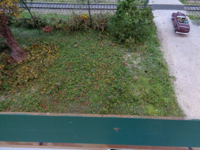

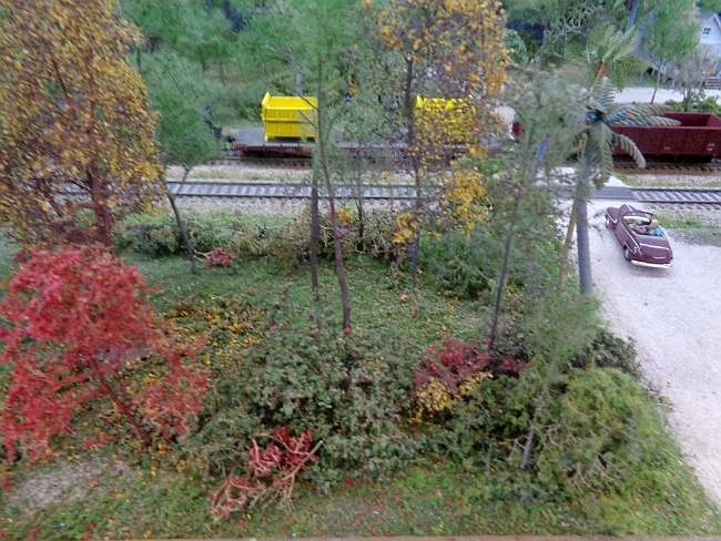

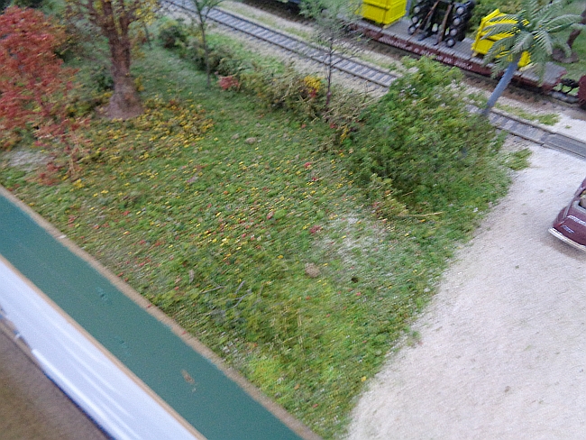

I wanted to clear the lot where the garage will be located and I did that late this morning.

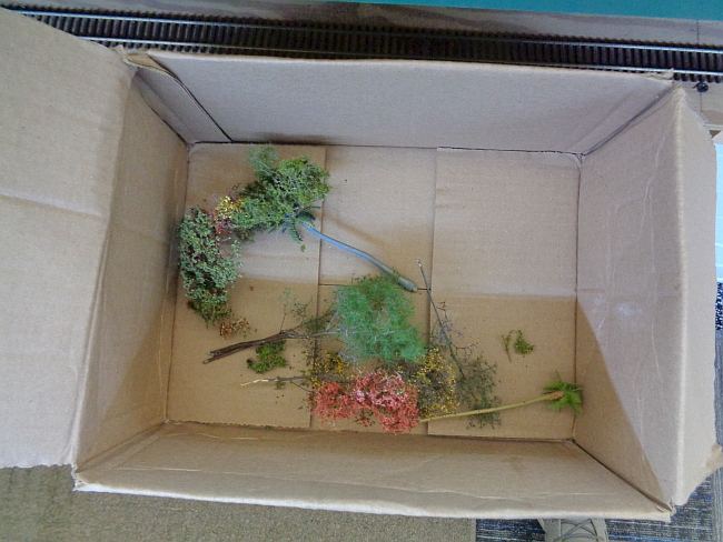

I carefully removed the trees and under growth bushes.

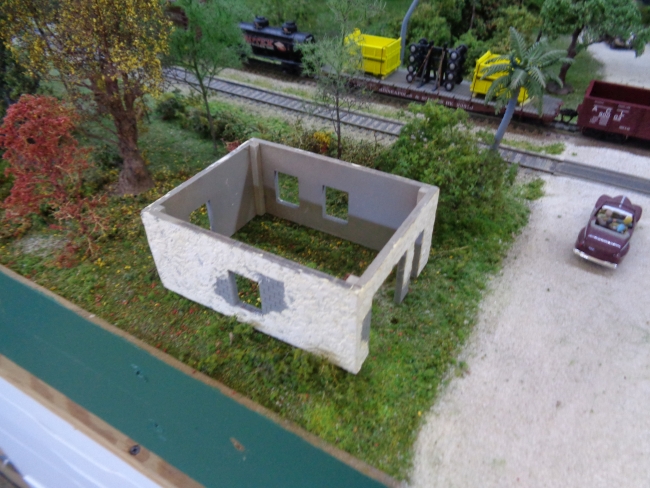

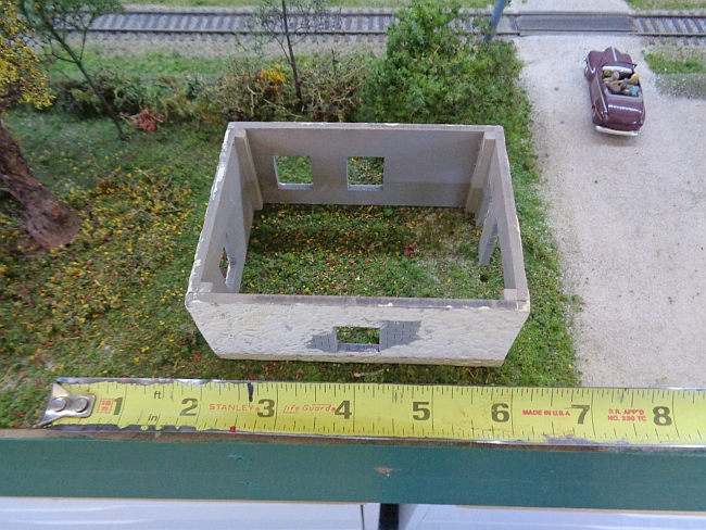

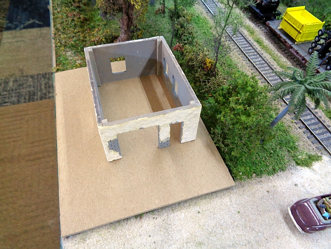

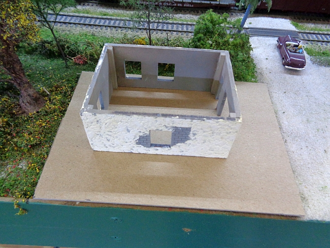

I placed the garage on the lot to see how large I needed to make the concrete slab.
I decided the slab needed to be 7 inches deep and 5 inches wide. In HO scale feet ii is 35 X 50 feet.
I  was also able to save the trees and undergrowth.
I cut a piece of 2 ply cardboard to those measurements.

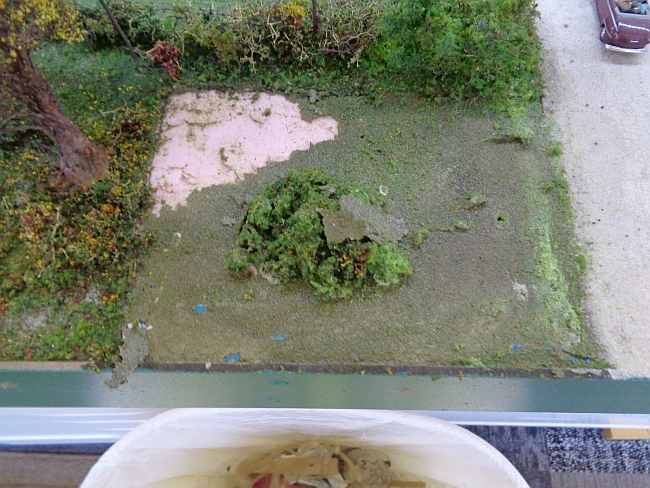

It was then time to removed the ground cover.

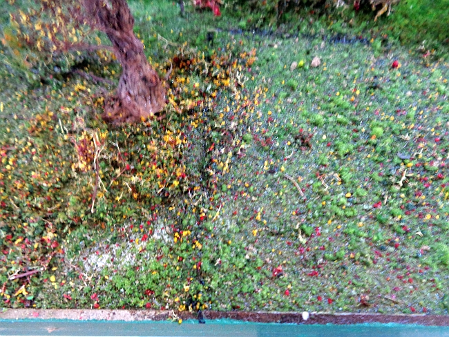

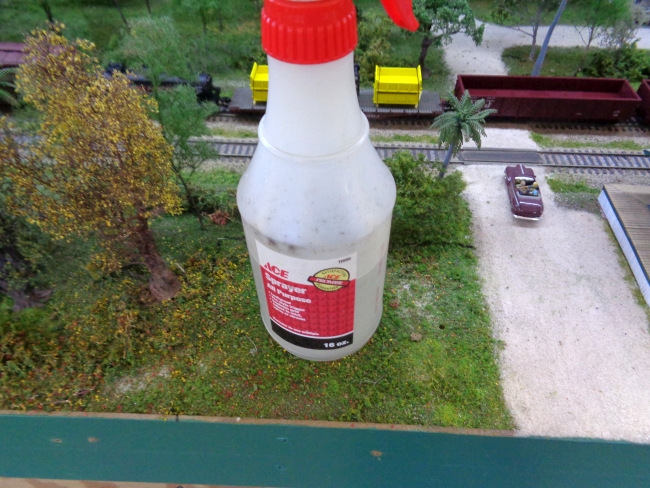

I used a spray bottle and sprayed the area with warm tap water.
After a few minutes you could see the white matte medium showing through the grown cover.
Showing white on the right where wet and dry on the left.
I used a putty knife to remove the scenery gook.
Back in a few, Diet Pepsi time.
I sprayed more warm water on the lot.

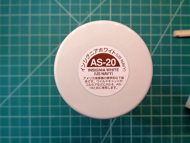

While that was soaking in, I spray painted the outside of the garage. I used Tamiya US Navy Insignia White. Not really white and not cream colored, more like an aged white. This, I believe, will weather nicely.

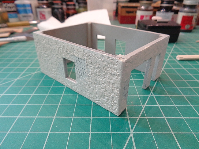

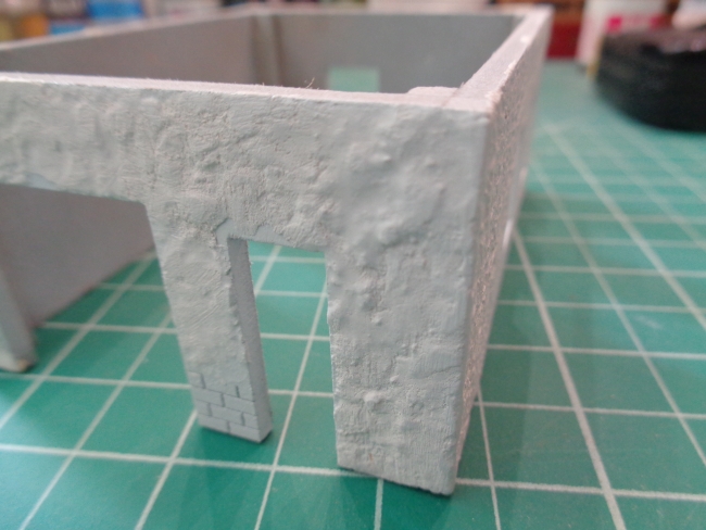

This is what I forgot to mention in yesterday's post. On the upper right corner of the front wall, I added more stucco and while drying, smoothed it out.
I've seen old stucco on buildings where the stucco had water intrusion behind it and looks very loose and ready to fall off the wall. This is the effect, right or wrong, I was going for and can probably pull it off once weathered.

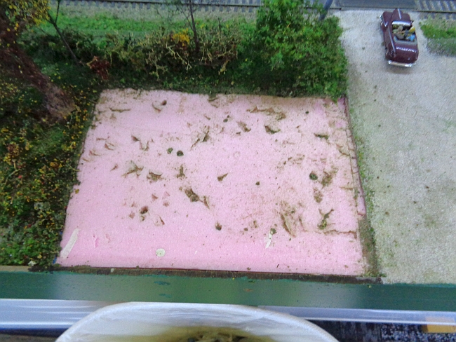

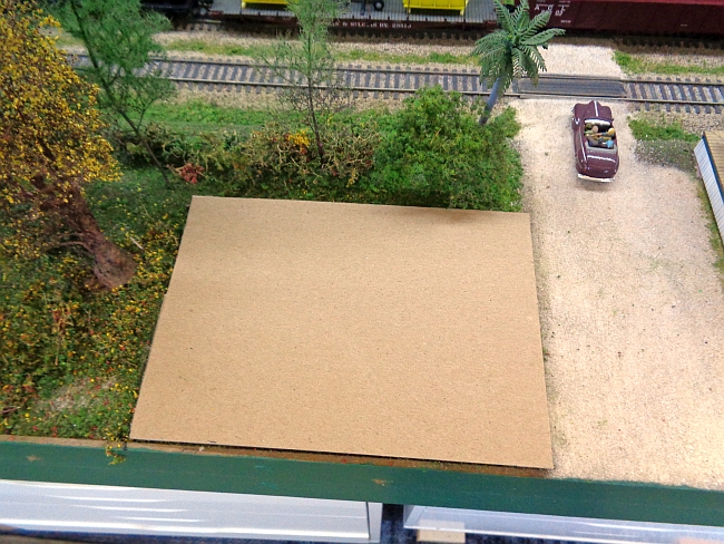

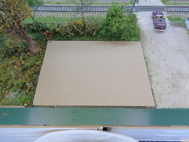

The grown cover was soft enough to be removed.
Fast forward and done.
Concrete slab test fitted.
Done for today.

Tom, nice job clearing the lot.
That water intrusion weathering on the stucco will be interesting to see.

Tom that really does look like stucco!
I like the way the lawn mower cut the grass & shrubbery!!  :)
