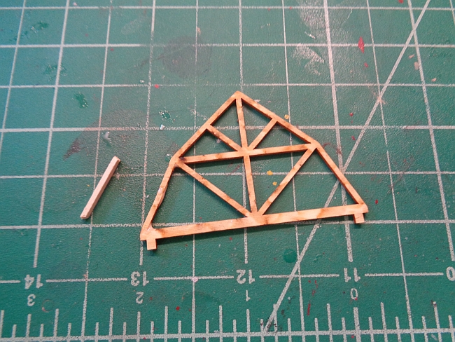

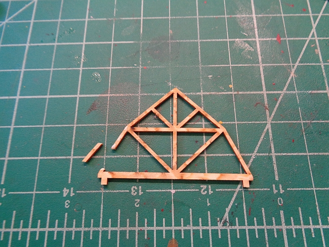

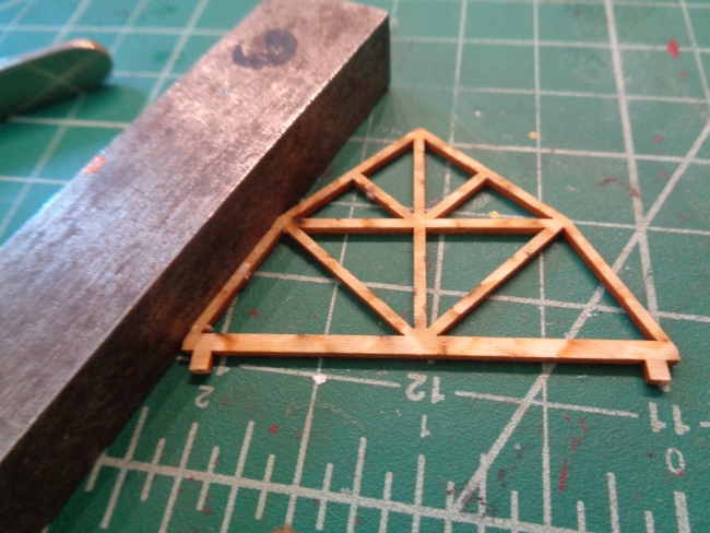

While removing the rafters from the carrier sheet, I broke one.
Here is how I fixed it.
I used a toothpick and placed a small drop of yellow glue on each end of the broken piece. I used a tweezer to add the broken piece to the rafter. I used a metal weight to make sure the pieces were aligned.
Vietnam Seabee
Oh boy..another Langford build...I always enjoy these
terry

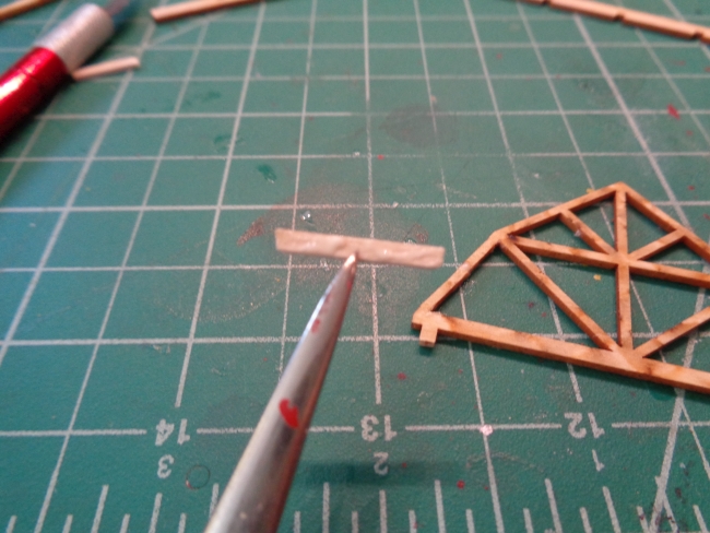

I then took a piece of scale 2X6, cut it to fit the inside of the break location.
I applied glue to the 2X6 and glued it to the inside of the break location.

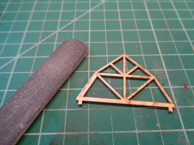

I let that sit for a few hours and when the glue was dry, I sanded the 2X6 level with the rafter.
Actually, sanding the 2X6 wasn't necessary as it won't be seen when the model roofing is applied.
Repair complete!

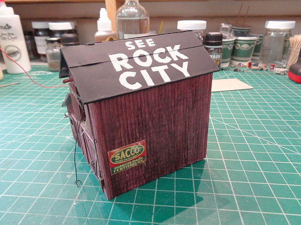

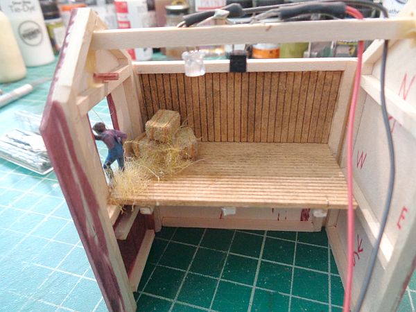

Thanks for checking in. As far as the loft is concerned, On this kit I don't want to spend the time making a loft.
On my scratch built See Rock City barn, I did in fact build a barn loft.
