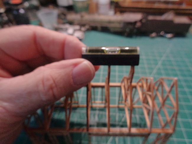

Philip mentioned level and here is proof. 8)

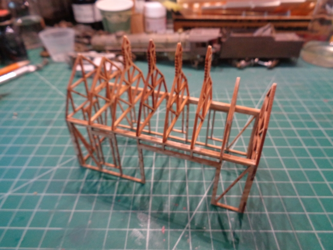

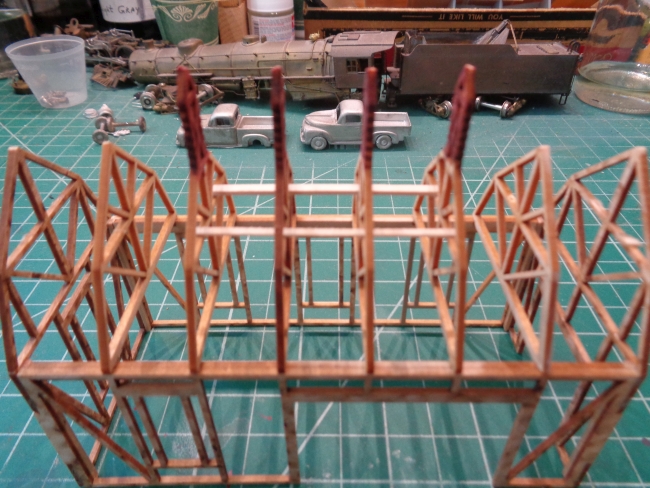

The four center trusses are very delicate and can easily be broken. When building this barn, it would be a great idea to glue on "rat runners". This did greatly reduce the flimsiness of the trusses.

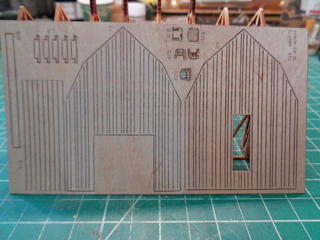

One of the other things I planned to do but changed my mind was to add individual exterior vertical boards to the barn.
However, only two side of the barn can be viewed by a visitor. So, there was no reason to spend the time on individual boards.
My decision was also made after closer inspection of the kit wall sheathing.

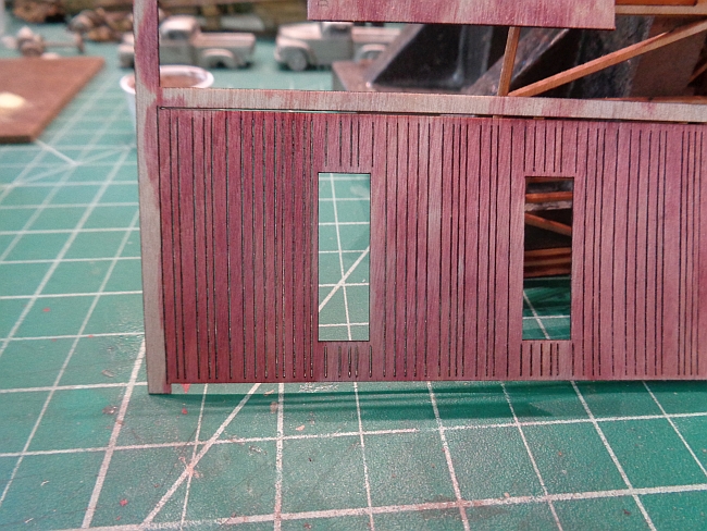

BTS did such an excellent job on the laser cutting that the walls look like individual boards. There is actually a tiny gap between the vertical wall boards. I'll show this later in this post.

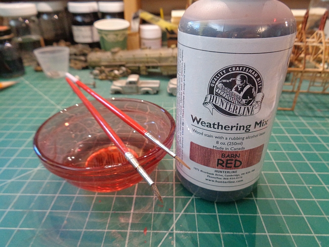

I'm using Hunterline Barn Red A&I to stain the walls and other parts.

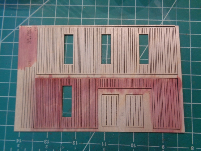

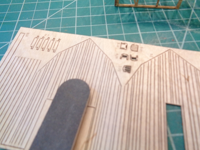

The kit barn walls are 1/64" thick ply and very delicate, just like the roof trusses.
I used the fine side of a sanding stick to sand the exterior and open more of the wood grain to receive the red stain.
You can see the difference in the left and right end wall sheathing below. The left wall is sanded.
I brushed on the red barn stain at the top and gradually thinned it as I worked towards the bottom. It is heavier at the top as the barn red wouldn't be as "bleached out" at the top. The roof overhang would shade the upper part of the wall.
I set the walls to the side and left dry over night.
This morning, when all walls were dry, I used the same fine side of the sanding stick and lightly sanded the red stain.
I left a section, on the left side, un-sanded to show you the difference.
Nice effect, Tom.  Will you then do an A&I wash or similar weathering over the red?
