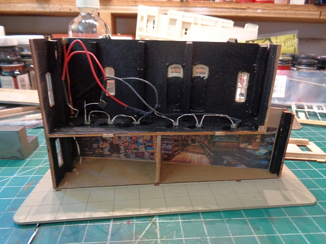

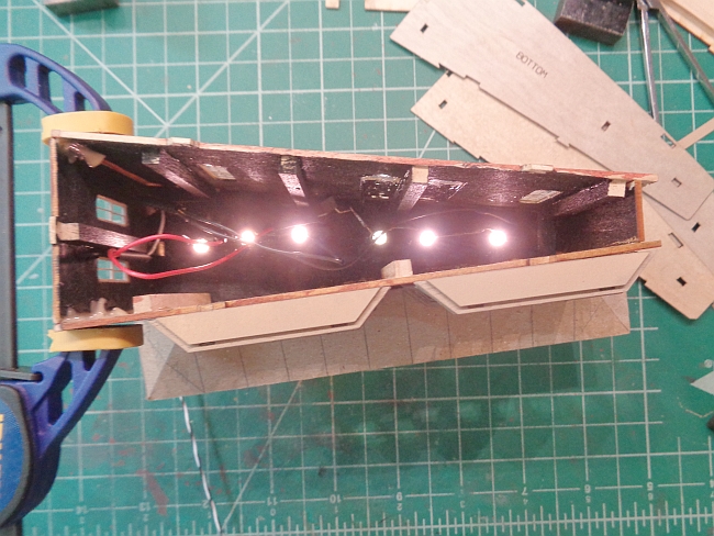

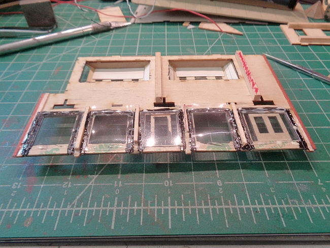

I installed LEDs in the ceiling for the lower floor lights. I glued some backdrop photos to the rear wall as well.

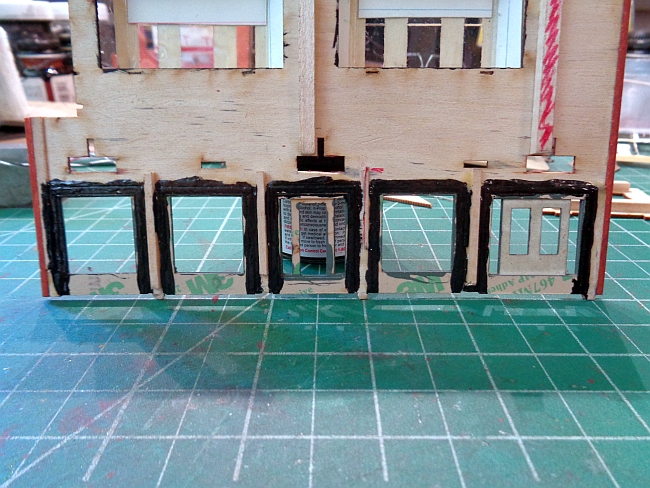

I  painted black around the inside of the windows to prevent light leaks.
When dry, I installed the window acetate.

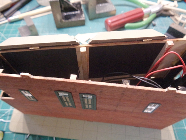

I glued the front wall to the rest of the structure and used clamps to hold it together while the glue dried.
The bottom roof panel, part 25 in the diagram, was placed on the roof to help hold the walls as the glue dried.

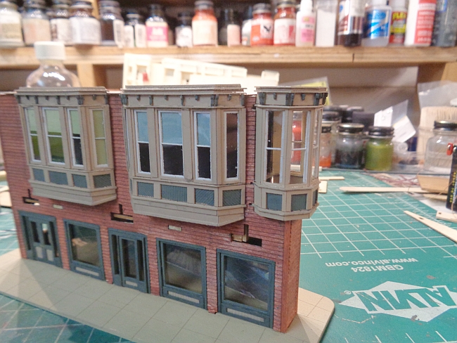

The top of the LEDs shine into the second story bay windows.
In the next photo you can see the red wire in the left bay window.

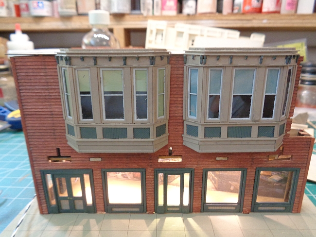

I cut two pieces of black paper to fit and be glued to the back of the bay windows.
Prior to adding the black paper to the windows, I painted a 3X5 card with Tamiya Sky Blue and Sea Green. I cut strips and glued them to the rear of the window.
One could argue that the two bay windows are in one room. Since there are two rear doors on the second floor, I decided these were two separate rooms.
Anyway, now the LED can't be seen through the second floor windows.

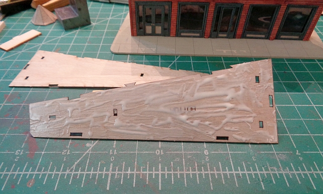

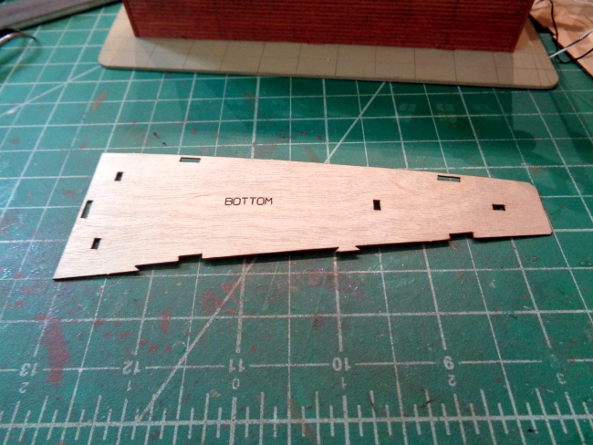

The bottom roof panel is a very thin wood product and doesn't lay flat.
There are other roof panels that will be glued to the bottom panel. I wanted this one sturdy and flat when the other panels. So, I added some 10X10 bracing to the underside.
I added glue to the bottom panel making sure no glue got into the openings.
The middle section was place on top and the two roof panels were placed upside down on the work bench. I added weights evenly around the side to ensure the panel remained flat as the glue dried.

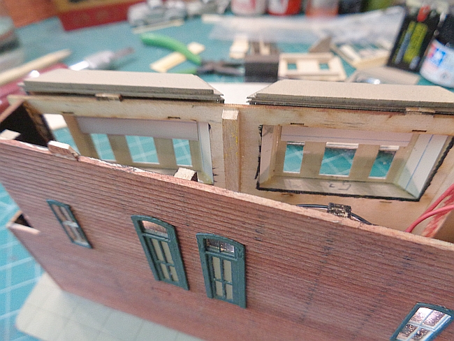

While the two roof panels were drying, I made a final test fit of the tower to the two walls.
